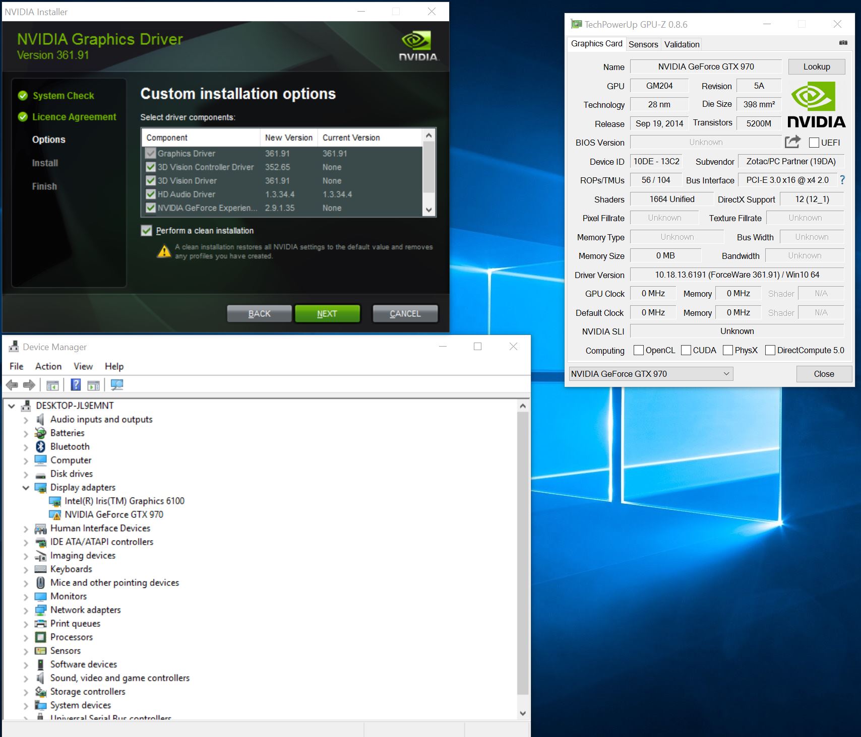

What happens if you perform a clean installation in custom options of the Nvidia installer? Or just select the graphics driver component?
2015 Macs support TB hot plug in Windows, so did you try hot plugging the eGPU after you have Nvidia drivers installed, the computer is restarted, and you have logged in?
Sometimes nvlddmkm.sys causes problems, try renaming it or delete the file before installing Nvidia drivers.
It'll often freeze during the uninstallation process. It has successfully uninstalled a couple of times and the result appeared to be the same as when I uninstalled it via the 'programs and features' window
I've tried uninstalling everything except just the driver component, no luck there

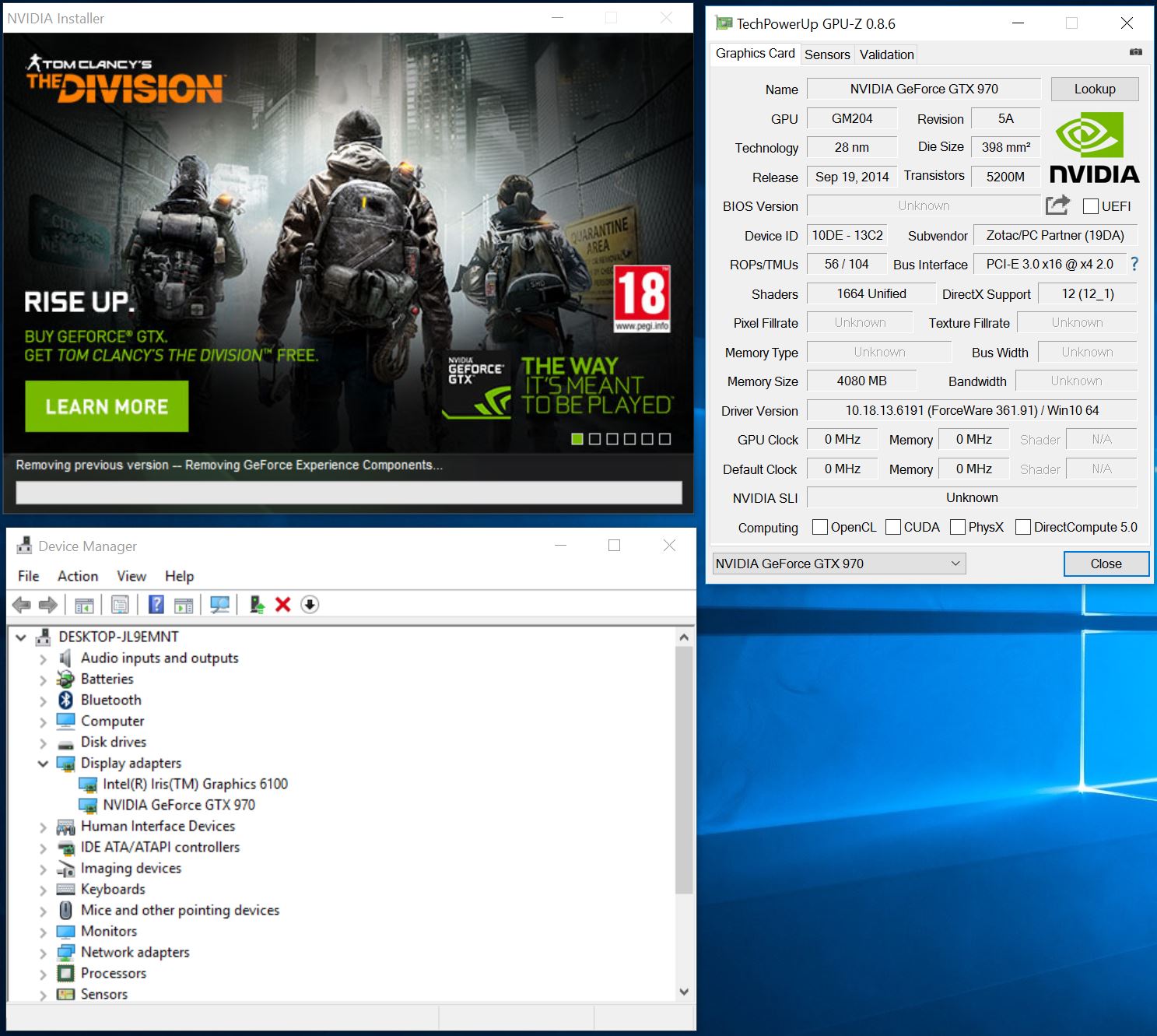

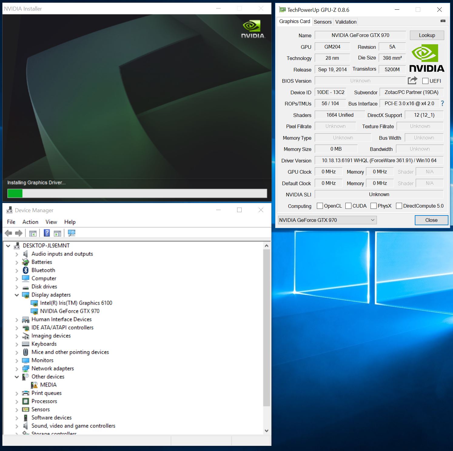

Here are the exact steps I just took:
start windows
hotplug eGPU
open GPU-Z and try to backup bios. GPU-Z freezes.
rename nvlddmkm.sys
run nvidia installer and select to perform clean install
installer freezes (dismal1.jpg)
wait 15 minutes
force power off
turn eGPU psu off and on again
windows boots
open nvidia installer
take screenshot (dismal2.jpg)
proceed with install
installer freezes (dismal3.jpg)
A very tricky issue. Please don’t force power off. Open task manager and end the installer process.
