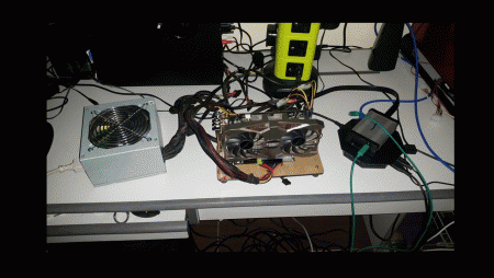

Hook up the hardware. Image below shown. Ok. I cant upload a 189kb picture. This sucks.
I hooked up the 24 pin from PSU to the eGPU. And use a 2 molex adapter to a 8 pin connector to power my GPU. Then eGPU express card to my Sonnet and to my laptop.
egpu2.thumb.gif.5be134b6e932d7003cc01460

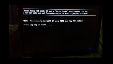

Hi,
A little update. I followed @errin guide with every step of the way. Still no result. No detection of eGPU in windows 8.1 .
Later, I installed DIY Setup 1.3. Giving me a chainloading error.
56b38e6b1e11f_chainerror.thumb.jpg.5ffc5
I'm really getting frustrated here. Am I really out of options here? Can someone give me a very specific guide whether I should do or dont?

TB1->Sonnet EE-> PE4C v3.0 -> GTX 680 with antec 450W power supply.
My switches are on 2 2
https://drive.google.com/open?id=0B1avZFzVfTQ0WmRxUUt0dmFobG8
And here is a proof ow working display hooked through the gfx card
https://drive.google.com/open?id=0B1avZFzVfTQ0N1VFRXFLVHlHQXM
