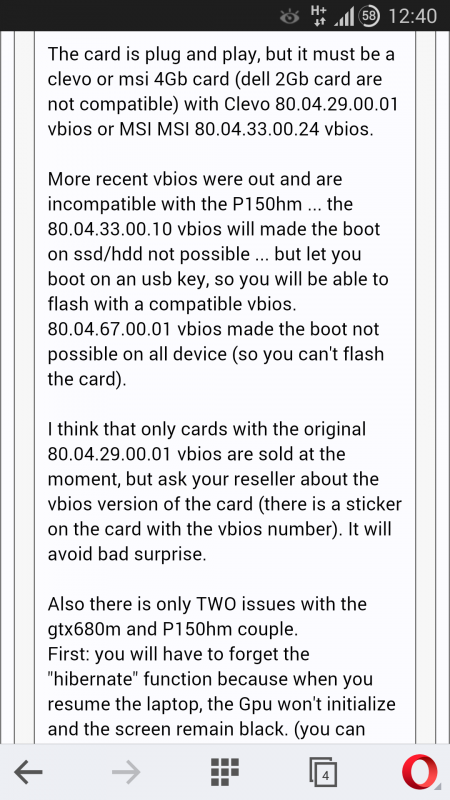

I got exactly the same problem AS described in that threat:
Same card (Clevo GTX680M 4GB) with a P150HM and the same symptoms. My card also has a Sticker with the vbios version on it, which should be compatible with the P150HM. svl7 is retired, so is there maybe somebody out there, who could help me flashing the card back (I would also pay for it)I can't do it by myself (can't even access the system BIOS) I'm situated in Austria.
Many thanks in advance.

Hi,
I did nothing wrong. I got the card with a non compatible VBIOS --> I coudn´t even boot into the BIOS/Boot Options.
For the P1XXHM modell you need the VBIOS Version Clevo 680m - 80.04.29.00.01 'OCedition' revised_01.zip (sirana flashed that one for me). Working now in my P150HM

On 21/1/2016 at 2:27 PM, sirana said:
@Doki Just as a reminder, don't flash a VBIOS other than 80.04.29.00.01. Anything higher (e.g. the .33 version) will result in the HM being unable to boot.
I have heard that 80.04.33.00.10 vbios let you boot on usb key...
