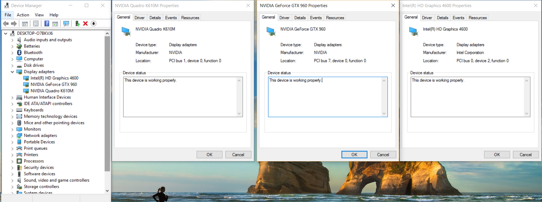

killem2 Posted June 27, 2016 Share Posted June 27, 2016 (edited) So i have installed a clean version of Windows 10, UEFI. My device manager shows this: I do not have Setup 1.x installed just yet. When I run something like Heaven Benchmark I'm getting like 7 FPS on ultra. This is also using an kitio thudnerbolt 2 setup. When I successfully ran this under 8.1 windows it was easily 50 fps. maybe more. I thought the drivers for Nvidia Fixed this kind of stuff. What should I do? Any info you want me to show you? Edited June 27, 2016 by killem2 Link to comment Share on other sites More sharing options...
gharimanto Posted June 28, 2016 Share Posted June 28, 2016 On 6/27/2016 at 11:45 AM, killem2 said: So i have installed a clean version of Windows 10, UEFI. My device manager shows this: I do not have Setup 1.x installed just yet. When I run something like Heaven Benchmark I'm getting like 7 FPS on ultra. This is also using an kitio thudnerbolt 2 setup. When I successfully ran this under 8.1 windows it was easily 50 fps. maybe more. I thought the drivers for Nvidia Fixed this kind of stuff. What should I do? Any info you want me to show you? Did you update latest intel HD ? It let me hot plugged now. Link to comment Share on other sites More sharing options...
