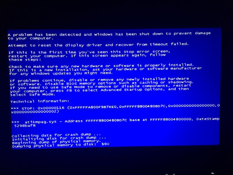

My pc show American Megatrends logo and windows logo. But giving bluscreen with atikmpag.sys error.
Maybe it is not my card :S I remember that i try to install new drivers from ATI but it doesn't work Maybe that cause this problem?
I remeber last time my 6990M get toasted it failed even on American Megatrends logo.
Now i entered the windows in Safe Mode. And all is working. It will not work if the card was damaged right?
Im thinking about to remove all drivers for my card and reinstall the new from AMD.
For last where did you find the Clevo GTX 680M? I can't find anything that can fit my Clevo. I mean fit my BIOS.
Edited by pcmaniac

I try several things. It showed up normal in safe mod. But after i try to delete the amd drivers now it look very funny colors.
So right now i used DDU to delete all the amd drivers and installing the old driver again.
If the GPU was done will it show the American Trends logo? I can also join the BIOS without any problems.
But when it try to join the windows there the problem starts.
Update :
I get blue screen again. The picture is uploaded.
Hmm i uninstall the drivers. And boot up in Safe Mode.
But in Device Manager i also uninstall the graphic card. Then it ask me if i want to uninstall the drivers.
Nothing happend. Then i unplug my card and gave it a new thermal paste and changed the thermal pads that was bad.
Now it's all working. And i played Battlefield 1 for 1,5 hour. The temp was maximm 78c.
Maybe it was the drivers from AMD that destroyed everything. I don't really know.
For now it is working. I hope it's over :)
