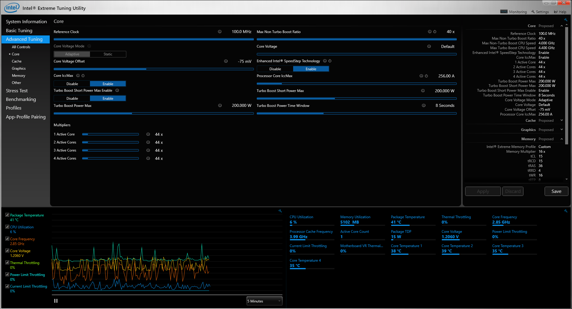

After a few months of use I've settled on both a CPU overclock and an overvolt.
This seems to have helped with the throttling.
I've set the 6700K cpu speed to 4.4Ghz for 1-4 cores active, using a core voltage offset at -75mV. I was running at -80mV but my Dwarf Fortress save got mysteriously corrupted, so upped it slightly just in case it was related.
My GPU has limited capacity to overclock though.. +60mhz gpu clock is close to the limit for my stable 980. Have left the GPU ram at defaults... didn't seem worth the time to raise that when the default clocks are more than sufficient.
