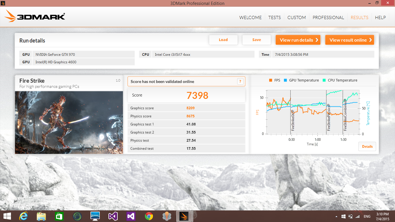

Benchmarks
heres my result using internal display

:Banane47:only 'bout 15% performance drop(compared to external display) when using internal display.

Interesting results though with 3DMARK Fire Storm
With *only* GTX970 working on external monitor connected to GTX970: Score: 7602 / Graphics Score: 9736 / Physics Score: 6210 / Combined Score: 3295
With iGPU and GTX970, external monitor connected to laptop HDMI: Score: 6633 / Graphics Score: 7321 / Physics Score: 6921 / Combined Score: 3755
With iGPU and GTX970, external monitor connected to GTX970 HDMI: Score: 7781 / Graphics Score: 9542 / Physics Score: 6850 / Combined Score: 3570
Mine was working, then I clean installed the bios and os (long story) and now it doesn't work correctly. My internal dGPU still shows up in device manager, along with the 970. I cannot open NVidia Control Panel, it simply states I have no displays connected. Could one of you post your exact bios settings that got yours to work, I have been fiddling for hours and cannot for the life of me get it working again.
Did some more testing / benchmarking. On external screen, I get 8552 on 3dmark. On my internal screen, I get 6950, with the graphics score being significantly lower (~3000 points). I feel like the optimus compression is not working correctly, as my performance drop is ~20% on my internal lcd compared to ~10% on op's internal screen. Is there anything I am doing incorrectly here?
