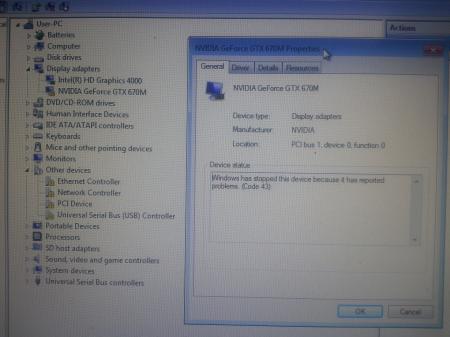

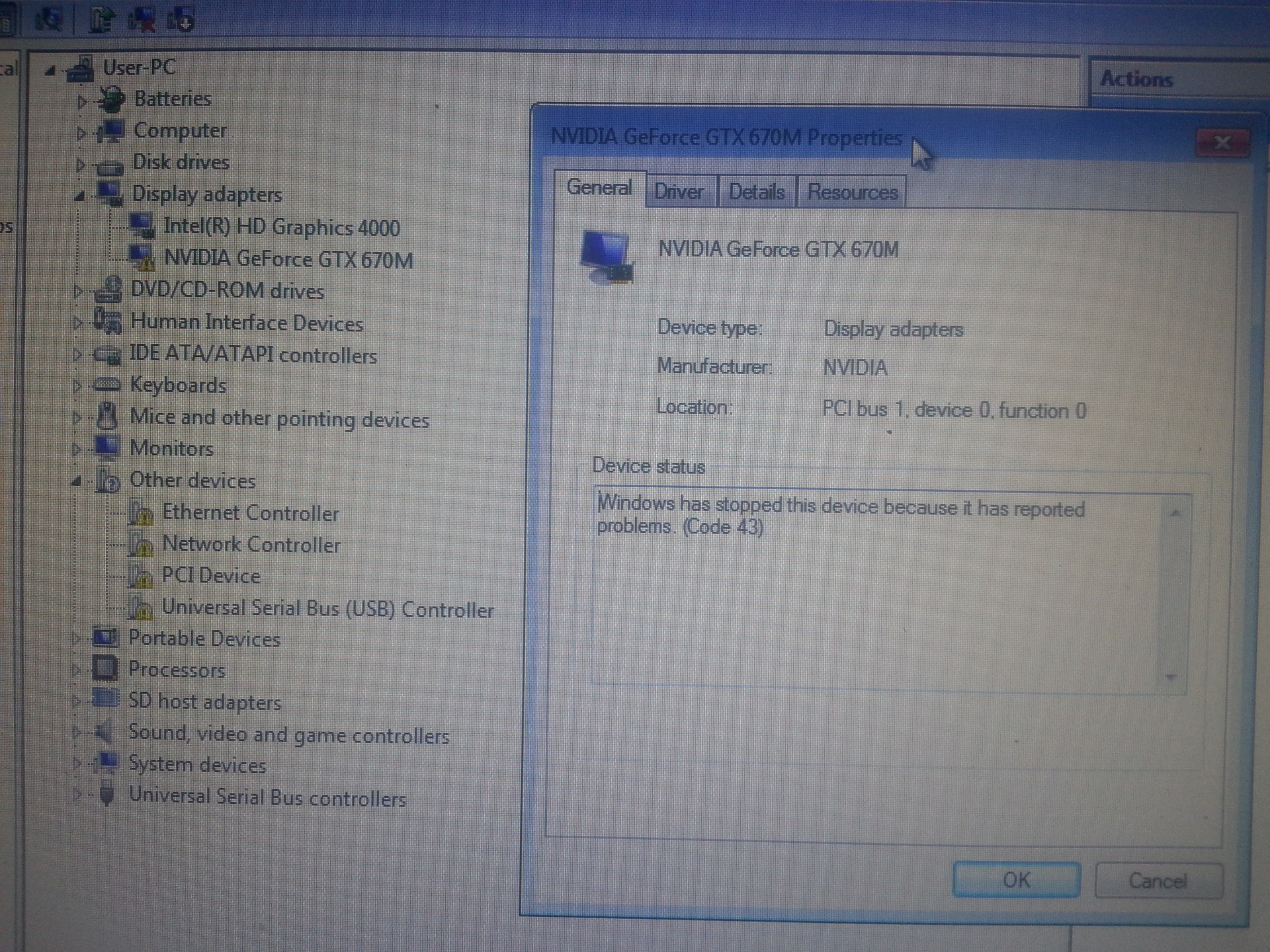

Pulled the card out of Clevo P150EM and installed in MS 16F3. Screen on boot, no fan spinning max, everything perfect! Installing Windows for like 10 minutes and then fan starts spinning max. Installed Windows, chipset, Intel management, Intel VGA and finally nVidia driver with custom .inf from laptopvideo2go.com. Device Manager shows yellow triangle next to GTX 670M. Rebooted and tried flashing MSI vBios with nvflash. I get the line checking image and ID's, something like that, and skips flashing. Checked EEPROM and it said status Unknown. Entered Windows and 670M shows in Device Manager with yellow triangle next to it. (Code 43 was error from the beginning btw) Reinstalled 670M in Clevo, BIOS and nvflash recognized it, however nvflash cannot write anything to it. Reinstalled back to MS 16F3 and same thing with nvflash. It shows it is there, but cannot write to it. Back to P150EM, 670M shows in BIOS and nvflash, but I cannot flash it. After 2 restarts, nvflash doesn't recognize 670M, but BIOS does.

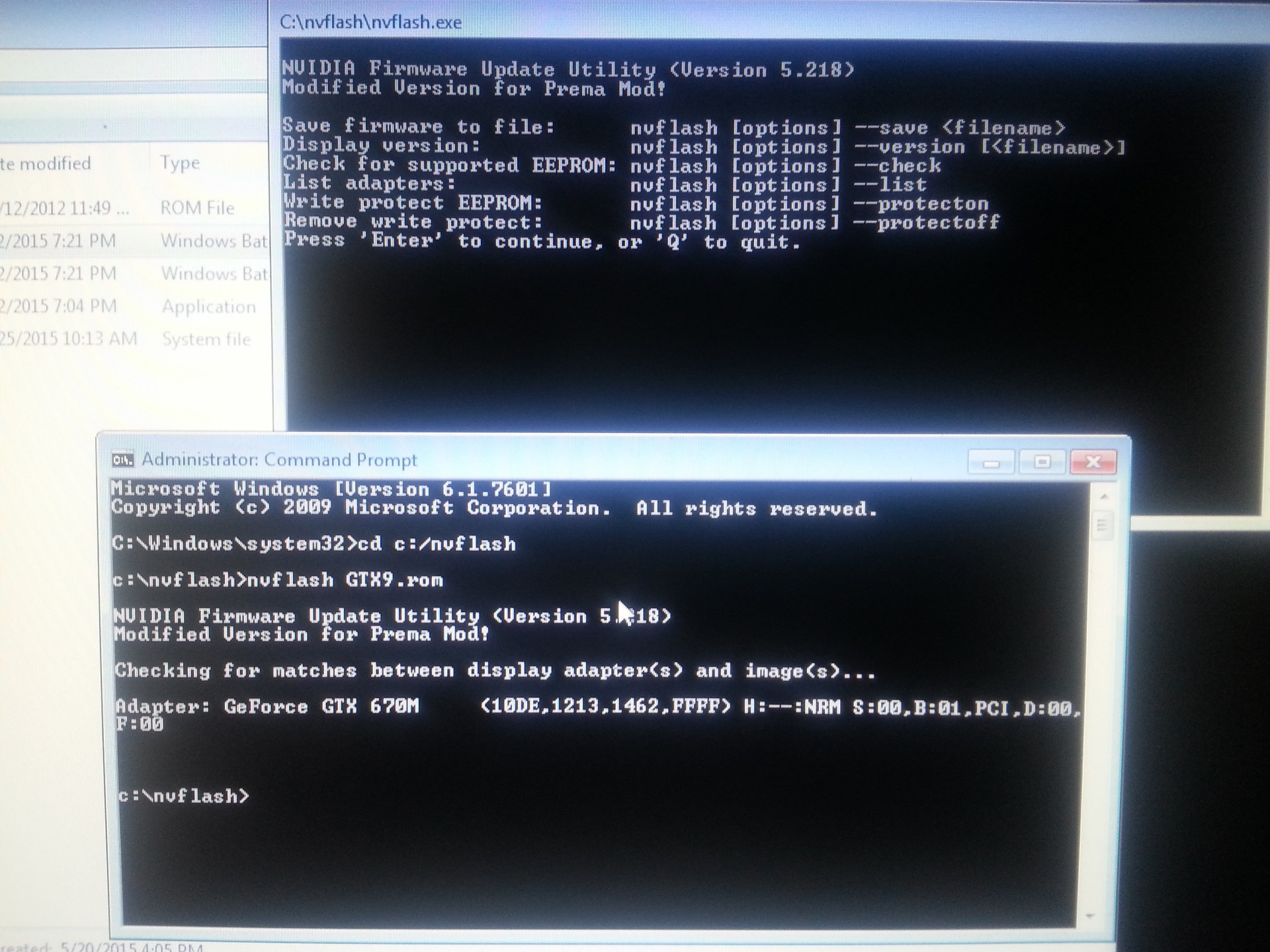

I still cannot flash it. It just skips when checking image and ID's. I tried method -4 -5 -6 vbios_name.rom and cmd shows list of commands.
However, your attached NVFLASH does read 670M, but still no luck writing to it. Wanna do Teamviewer or I could post up screenshots?
Error: supported EEPROM not found. This shows when I try to back up vBios. When I try to flash it, it just skips.

Only -6 is still a valid command on the new nvflash. Make sure to keep the GPU active by having GPU-Z open on dgpu in the background.
Did you keep GPU-Z active in the background?
OK, use the old DOS version of nvflash and flash it in via USB in pure DOS.
GPU-Z while in Windows or Safe Mode?
I tried NVFlash 5.136 in pure DOS. Still no luck. It skips when needs to flash it. I cannot check EEPROM status. Actually it says Unknown.
