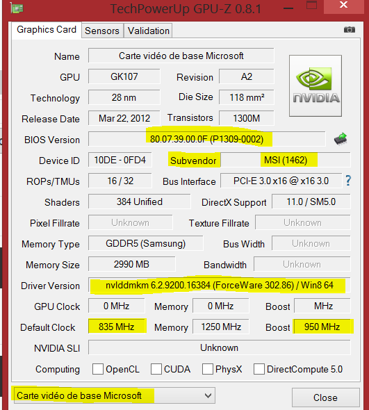

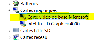

Hello, good news :D i 've finally flashed my laptop bios with the last version and install the card nvidia gtx660m and start my laptop and it's stared ith the card so black screen is no more ! no when i go to Devise Manger i see that there are 2 cards (the intel HD 4000 + Microsof Standard VGA), so i now there is a chance to continue (look the next image)
i 've seen before this problem so i 've installed the GPU-Z to be sure that the card is working, and YES ! the soft detects that the card is an nvidia from subvender MSI (i thought it should be Dell) and it detects its vBios and some informations like GPU Clock & Memory Zise and more..
(you can see the next image)
but the general title it still Microsoft Standard VGA..

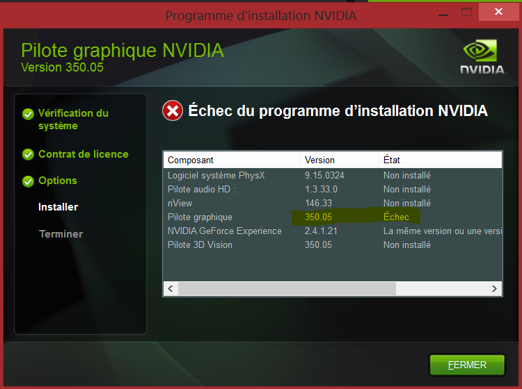

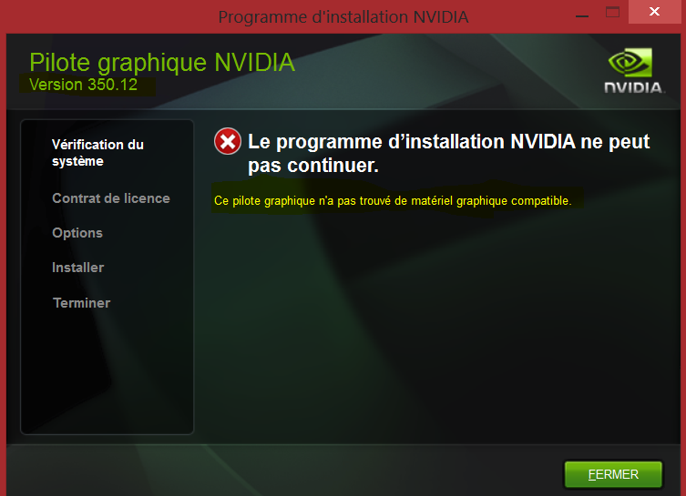

after that i 've downloaded the last driver for the card gtx660m from nvidia website and try to install it maybe it detects the card and change the name to the original name Nvidia gtx600m.., but NO, it didn't find the good devise to install the driver
(see the next image *Sorry fro the Language -French-)
now i stopped here.. !
what i'm thinking :
- if the GPU-Z is a good source to know the Real Subvender as what was showing (MSI 1462) ?
- or just because the laptop is MSI ?
- if the card is really working (it seems to work else it 'll not start or showing the vBios and the other infos..) ?
- if i 'll do some manual changes (change some files before install the driver like Vender-ID i saw that on some forums) ?
- finally if i must do some Vbios updates to this card and what vBios is compatible and what the easy and the sure way to do ?
I'm waiting your suggestions and opinions about this new problem, Thanks.

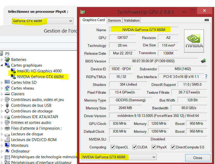

Update: Finally it's working now :beguiled: Thanks all,
Note: The problem was in the nvidia driver all versions of GTX660M are non-signed drivers, so i just stopped my windows 8 64bit to check the driver signature via advanced boot, and installed last driver from nvidia and its working like an original one without any flash on the vBios or some driver's .inf changes (i tried this without any success).
Conclusion: I 've done a lot of research 3 days or more visiting maybe 100 websites and tried a lot of solutions to make this Dell's nvidia gtx660m gpu work on MSI laptop.
-I 'll resume the right way:
1-I removed the card from the laptop else you'll get a black screen.
2-I flashed my laptop Bios & EC Firmware (MSI GT60 0ND) using iTzZent windows method (Bios)
3-I putted the card in the laptop and see if the laptop 'll start with it and was OK.
4-When i saw the laptop detects the GPU by the new Bios so i downloaded my GPU Driver.
5-Before install the driver be sure that the driver is Signed (if you've an old card maybe it's driver isn't signed and LAST Windows OS don't allow those drivers by default and there is no option to disable it like before) so you should restart your computer via cmd: shutdown -r -o ,when it restart you 'll see some new options on start, go advanced options and select auto start options (Disable windows to check drivers signatures, just select the number by clicking on it, my case i clicked the 7), the windows 'll restart again normally.
6-I Installed my last card's driver without any changes.
7-Reboot the laptop to check if all done.
It's all, i hope that this post 'll help some peoples later, and be sure there is nothing impossible ;)
