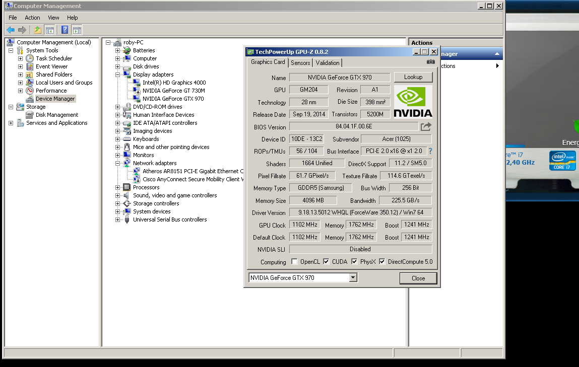

Getting it all going
Everything is plug and play - I did not have to install anything third party or configure anything, steps I did:
  1. connect eGPU and start the system
  2. install desktop version of GeForce 900 series driver (which uninstalled dGPU driver)
  3. restarted Windows, but with BSOD, so I removed eGPU, started up again and disable dGPU, shut down and then connected eGPU and started Windows with no BSOD
  4. connected monitor to eGPU
  5. when I am using eGPU in Windows display settings I disable laptops internal display and enable only external monitor (my laptop display is turned off)

So you don't have to use DSDT override for gtx970?
as I wrote - for my hardware (laptop, eGPU adatper, GPU) nothing had to be done or configured - it was all plug and play.
I also know that for one other member here with same laptop and a GTX 970 (only MSI version) and same eGPU adapter (Beast v6.1) was plug and play.
So as for the GPU: GTX 970, it sure does not need any overrides, same goes for the Beast v6.1 adapter. So only variable left is your laptop - if you are lucky, then you will not need no extra configuration or setup to run this.
As far as I understood it does not come down to CPU, MB, iGPU only. There are some other factors that might affect things, like BIOS and other I dont know.
But if you have same hardware as I do (or lucky and you hardware is good) - you are good to go.

Unfortanly the EXP GDC Beast not working properly by me. I did everything like in the Tutorial and Still not Working I search the whole google and I couldn't solve the Problem.
I put some pictures to show you what i did and where the problem is.
EXP GDC - Album on Imgur
my Laptop: Acer Aspire V3-772G.
Some people have the same laptop as mine and it worked.I did everything like in the tutorial and at the Boot i get a Black Screen just black and it stay like that.
I even Disabled AND Uninstalled my graphic card from the Device-Manager in the Laptop (I have two, One [intel ..] and another one [From Nvidia..]) and deleted everything from Nvidia and still the same.
The new Graphic Card that i bought is MSI Geforce Gtx 970.
It turn on and everything work fine even the red lamp at the EXP is on but I still getting the Black screen.
I hope you can help me, because I don't know what to do more.

I think I see your mistake (see attached picture).
you must not power GPU from BEAST, instead you power GPU directly from PSU using PCI-E 6/8 pin connectors accordingly.

Does PSU fan spin when you turn on your hardware? I saw in picture, that GPU fans are spinning, so Im know they are.
http://i.imgur.com/ROHUE9o.jpgalready changed that. long ago but thanks for mention it .
Yes they are working normal when I plug the egpu.
