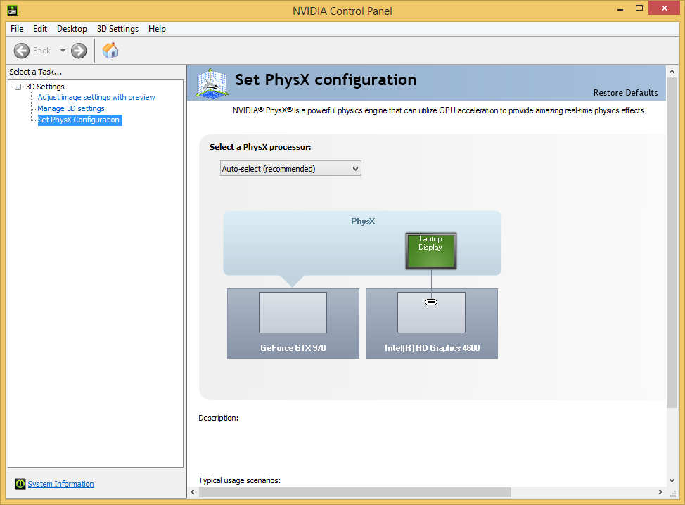

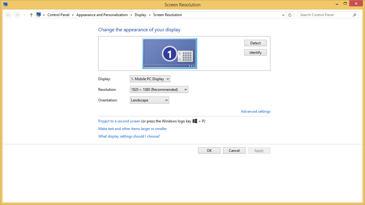

  11. thanks for the fast answer. Well my Monitor of the laptop working perfectly and its HD and everything fine the only problem is the External one. the windows dont recognize it either i cant switch monitors in the properties and in the Fn+F5. if i plugged the monitor to the laptop its uselees right? because its then the dGPU and not the eGPU (i didnt try it yet, because i know its not the purpose of the EXP GDC) all people plug the external monitor to the eGPU. so i dont know where i should start searching: Is it the driver ( i dont think so)? Is it the windows? (8.1 pro) is it the graphic card (gtx 970) ? Is it something in the DIY eGPU setting ( i think so) ? but i dont know where to search. or how to solve it. P.S, the external monitor working normally i plugged it at another laptop with the HDMI and it worked normally. thanks
  12. i have the same computer and i HAD the same problem but i solve it. For explanition out BIOS is complacited. So thats what happening: The black screen is because the BIOS detects the eGPU and doesn't know what to do with it. To circumvent that, hotplug the eGPU after boot OR use the delay switches on the EXP GDC (CTD/PTD). didnt help !! First of all make a jumper at youre ATX if you using it -> https://youtu.be/2e_enZDKNAY why: To prevent that, jumper the green and black wire on the ATX PSU to override the EXP GDC power management and keep the ATX PSU on. the black screen wel keep coming what you have to do is Enter Windows normally and then just hotplugg it and install all drivers like that : so you'll need to continue doing the sleep-resume method. 1. Go to Device Manager->View Devices By Connection. Find your dGPU. Directly above it will be a PCIe bridge. Disable it after which your dGPU will no longer be listed. 2. Delete ALL existing NVidia drivers. Then use "DDU" software to clear your registry of any NVidia registry settings which will also disable auto-install of drivers in Win8.10. 3. Install latest NVidia driver. Doing (1) should see you have more resources now so you might no longer see error 12. and then you buy this and install it : -> @Nando http://forum.techinferno.com/diy-e-gpu-projects/2123-diy-egpu-setup-1-30-previously-setup-1-x.html after you do all the tutorial there u just restart computer and lethim log in normally and then you restart and enter the diy egpu and there u go setep AND THEN U UNPLUG THE WIFI AND PUT THE EGPU AND CLICK F5 and at the setup you just disable dgpu and ignore it and you put your computer at mbr AND NOT MBR2 and click F3 to add that info, you can disable the notusedbridges too its usefull and then just unplug 1 more time in the setup screen and put the wifi and then reboot after this u click 1 more time the diy egpu and go to the first Blue scrren and move just down and up ( for the auto start) and there u unplug the wifi and then plug egp and click chain.. the first 1 . and then its work You will notice its working perfectly but the external monitor not working . i dont have yot solution for that. but people say you can do somrthing about it and the setting of diy egpu but didnt find it yet . Have Fun
  13. Its not BOTHERING - its a forum where you ask for help. !! but thanks anyway for your kidness, my problem is as i asked before: my external monitor show no signal no idea why , could the dsdt override help me with that ? iam open for any solution . P.S. i have Acer aspire v3-772g 32gb ram and gtx 850m as dgpu and intel hd... as igpu . my monitor is plugged to egpu gtx970 but monitor show no signal. Thanks

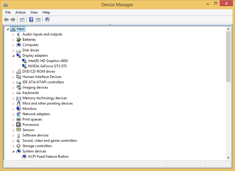

  14. Okay hi all one more time i solved the whole problems i worked on all issues for 5 days now and everything working thanks to all of your advices. EXCEPT my external Monitor. I'm in Windows 8.1, my device manager just showing my gtx970(eGPU) and the Intel Graphics card(iGPU)- no errors everything as it should be, laptop at HD. My Problem: my hdmi cabel are plugged at the eGPU but my screen is showing Noo-Signal. I installed didy egpu 1.30x the program from @Tech Inferno Faneva and changed a couple of things : endpoint : 3,87 scope= nothing becasue my dgpu are disabled completely ( but its there just make it dGPU closeunse. : on ignore=none didnt do DSDT override - i think i dont need it, or better said i dont know if i need it. so i read in google a couple of forums and they say i must change something in the setups and its gonna work but no idea what ?? I am open for any suggestion so please some help guys thanks
