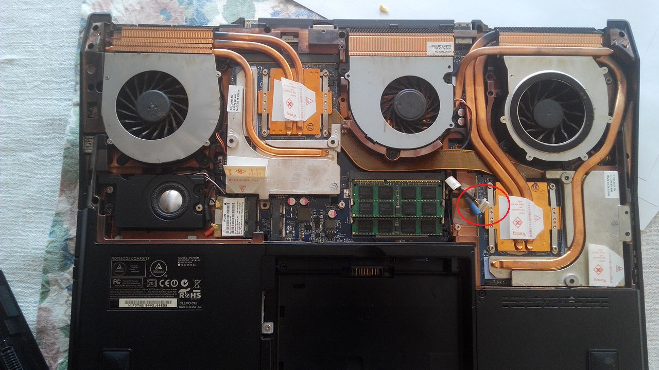

patrykp84 Posted April 27, 2015 Author Share Posted April 27, 2015 it's for fun ?? Explain what do you mean? I was wondering why this cable/s were loose, what are they for? Quote Link to comment Share on other sites More sharing options...
arronn Posted April 27, 2015 Share Posted April 27, 2015 I think its for bluetooth .Do't wory you have Integrated Bluetooth in Bigfoot Killer 1 Quote Link to comment Share on other sites More sharing options...
AziraphaleUK Posted April 27, 2015 Share Posted April 27, 2015 That cable (circled) is for a Bluetooth module. Most of us have wifi/bluetooth combo card installed so i's not in use. 1 Quote Link to comment Share on other sites More sharing options...
patrykp84 Posted April 27, 2015 Author Share Posted April 27, 2015 I think its for bluetooth .Do't wory you have Integrated Bluetooth in Bigfoot KillerThx for info, that's true it looks like antenna cable. But this second one - this flat connector - what is it for? Quote Link to comment Share on other sites More sharing options...
AziraphaleUK Posted April 29, 2015 Share Posted April 29, 2015 The flat cable (with the white connector) is for power and data signals for the module. Quote Link to comment Share on other sites More sharing options...
