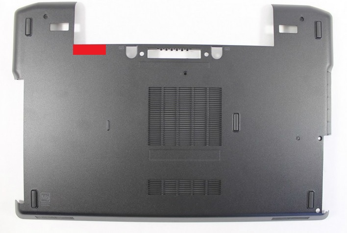

TheClassicalCat Posted May 15, 2015 Share Posted May 15, 2015 Just a quick update on my progress for the E6430 x4 project:The E6430 arrived in good working shape, ready to be torn apart (evidently it's still under warranty)...I contacted Bplus about getting shorter soldered cables with the PE4H and hope to get a reply soon. I realized that signal degradation could be a huge factor here so I looked into sourcing some PM030 and PM060 cables to test, along with an EC060. Once I learned the nomenclature I could actually communicate what I am looking for. I will keep you posted once I get a reply. I contacted the Chinese support office, not sure if the Taiwanese office would have been better.Thanks for your help Tech Inferno Fan and timohour this is going to be a lot of fun! Quote Link to comment Share on other sites More sharing options...
sskillz Posted May 16, 2015 Share Posted May 16, 2015 Just a quick update on my progress for the E6430 x4 project:The E6430 arrived in good working shape, ready to be torn apart (evidently it's still under warranty)...I contacted Bplus about getting shorter soldered cables with the PE4H and hope to get a reply soon. I realized that signal degradation could be a huge factor here so I looked into sourcing some PM030 and PM060 cables to test, along with an EC060. Once I learned the nomenclature I could actually communicate what I am looking for. I will keep you posted once I get a reply. I contacted the Chinese support office, not sure if the Taiwanese office would have been better.Thanks for your help Tech Inferno Fan and timohour this is going to be a lot of fun!Isn't PCI-e lanes independent, each transmitters/receivers pairs should be the same length, but between pairs it doesn't matter if it within spec (https://www.pcisig.com/developers/main/training_materials/get_document?doc_id=6d37ec2f8543fc1f9d8ace6264d08b469f57e5f1)What I'm saying is that if one pair connection usually works, two, and four should too.Maybe a SATA cable will work for the other connections (just transmitter/receiver pair exactly as SATA). Quote Link to comment Share on other sites More sharing options...
TheClassicalCat Posted May 16, 2015 Share Posted May 16, 2015 Isn't PCI-e lanes independent, each transmitters/receivers pairs should be the same length, but between pairs it doesn't matter if it within spec (https://www.pcisig.com/developers/main/training_materials/get_document?doc_id=6d37ec2f8543fc1f9d8ace6264d08b469f57e5f1)What I'm saying is that if one pair connection usually works, two, and four should too.Maybe a SATA cable will work for the other connections (just transmitter/receiver pair exactly as SATA).Yup, what I'm looking to do is two things: I know that signal degradation is affected most greatly by PCB trace size, cable length, and discontinuities between impedance (e.g. at each HDMI connection). Therefore:1. A soldered connection hence proved by Tech Inferno Fan should help attain GEN 2 spec. Perhaps a well soldered connection will allow for NVIDIA cards that have stricter fault control.2. A shorter cable will have less signal degradation. But I don't know if the shortest cables will reach, hence getting both 30 and 60 cm cables.This will be more of an experiment than just a one and done project I hope everyone will benefit from. I'm curious to see what kind of difference trying out connections will do. 3 Quote Link to comment Share on other sites More sharing options...
badbadbad Posted May 17, 2015 Share Posted May 17, 2015 2. A shorter cable will have less signal degradation. But I don't know if the shortest cables will reach, hence getting both 30 and 60 cm cables.This will be more of an experiment than just a one and done project I hope everyone will benefit from. I'm curious to see what kind of difference trying out connections will do.Wow, nice..hoping for the best here. Could you also take photos of the cable management? It would be nice to see how much hassle it is to organize the Flat cables. Quote Link to comment Share on other sites More sharing options...
TheClassicalCat Posted May 20, 2015 Share Posted May 20, 2015 Another quick update on the E6430 x4 project:I got a price quoted from Bplus for custom cables and they seem a little steep ($35 ea, especially if I can't trust them to do GEN 2 yet)....and I also did some research on alternative cabling options. Why didn't Bplus go with the PCIe cables with SFP+ or iPass connectors (compliant, industry standard, readily abundant)? Even though HDMI is considered low mismatch impedance here, perhaps the lack of true EMI shielding at the connection is what's causing them to fail GEN 2 speeds. timohour, did you use any shielding for your x2 2.0 custom wire setup?After reading splitframe's PCI-EMM060B mod, it made me start to wonder about a few more things that had to do with the way the wires are connected. I noticed that there's a large difference between the SFP and HDMI card edge connection pitch,.... SFP, iPass and SCSI is 0.8mm, HDMI is 0.4mm. I would imagine the mini HDMI is the same. I think we could truly have a mobile setup with the right connectors, which is why I'm now looking to (hopefully) solder a high speed I/O connector and see if using that on the PE4H will make a difference, but first maybe wrap that sucker in EMI shielding. The external SFP connectors have large metal cages that supposedly help lock EMI shielding throughout the connection. Prices aren't unreasonable for an 8Gbps cable on ebay, either. I'll provide a few links below of some of my findings. Enjoy.PCIe Cablesipass internal on googleiPass Product Training Module provided by Digi-Key and MolexHigh-Speed Pluggable I/O Solutions - MolexOther notes of interest:Solid core wires have less signal degradation compared to non-solid core.PCIe compliant cables (sfp+, iPass, perhaps also SCSI, SAS) have existed as a viable connection for x1-x16 connectionsSo far we know that soldered cables work better, but we haven't fully tested this to my liking.Bplus options are expensive for x4 cabling. I like the idea of the PE4H, just not the connectors.Oh, so I checked the schematics for the ODD/jsata2 port and it turns out that it uses a slimline SATA connector, so I don't think I have much of an option other than to make a custom connector here (maybe desolder the jsata2? I will have to look), just taping off the pins from a PM3N won't work on the 7+6 pin slimline SATA. Quote Link to comment Share on other sites More sharing options...
timohour Posted May 20, 2015 Author Share Posted May 20, 2015 Another quick update on the E6430 x4 project:I got a price quoted from Bplus for custom cables and they seem a little steep ($35 ea, especially if I can't trust them to do GEN 2 yet)....and I also did some research on alternative cabling options. Why didn't Bplus go with the PCIe cables with SFP+ or iPass connectors (compliant, industry standard, readily abundant)? Even though HDMI is considered low mismatch impedance here, perhaps the lack of true EMI shielding at the connection is what's causing them to fail GEN 2 speeds.timohour, did you use any shielding for your x2 2.0 custom wire setup? For my setup I used a mini pcie to pcie connector (this one) and a PCI-E 16X to 1X Adapter USB 3.0 (like one of these). I realised later that the mini pcie to pcie connector was only PCI-E 1.1 capable which was the reason why it wouldn't work with the Nvidia card @ 2.0. It worked with my R9-280x card though. I tested the PCI-E 16X to 1X Adapter USB 3.0 with my PE3A and with my Desktop and it wouldn't have a problem to provide a stable connection @ x1 2.0. Unfortunately, my PE3A is now dead (for no reason) and I am probably getting a PE4C for an x2 2.0. Oh, so I checked the schematics for the ODD/jsata2 port and it turns out that it uses a slimline SATA connector, so I don't think I have much of an option other than to make a custom connector here (maybe desolder the jsata2? I will have to look), just taping off the pins from a PM3N won't work on the 7+6 pin slimline SATA. Make sure you make no mistake with this one. The ODD port is a dual port. On the one side (of the 7+6 pin slimline SATA port you mention) is the SATA and power connection and on the other side is the pci-e connection for the e-module II. As I noted on this post a mini pcie card fits in there (as long as thickness and pin distance is concerned) and you have to cut some of the PM3 to make it fit into the ODD slot and thinsulate those pins that are not used. I started the work to confirm the theory but my PE3A stopped working and I don't have the right gear to test it. As far as alternative cables are concerned I can say that a good quality USB 3.0 cable would suffice for 2.0 signals (tested on Desktop and Laptop with a cheap x1 to x16 BTC) and I don't find a reason why SATA 3 (6Gbps) or SATA express cables won't work (2 for the first connection and 1 for every other). If you use sata cables you can even use a adapter like this for the x2 connection the Sata signal on the msata pinout is on the same pins as the pcie (PET and PER) signals on the mini pcie pinout. EDIT: cat6 can handle 10Gbps for 55m and cat6a & cat7 cable can handle 10Gbps for 100m. Maybe it is possible to use flat twisted pairs for cable... I am still undecided on which adapter I choose but I am probably getting the PE4C and solder the rest to test x4 2.0. I am not planning to use x4 2.0 on a daily basis. x2 2.0 external solution using EC port 3 and e-module port 4 would be the ideal solution for me. 1 Quote Link to comment Share on other sites More sharing options...
