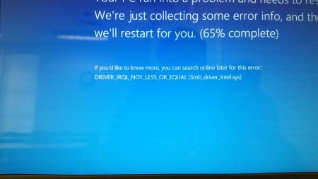

Well I Just got some sorta good news. Today after booting up the computer the fans spun and then the whole computer crashed and displayed this error (attached) So now I'm thinking it must be Intel related.... very strange....
Thanks!
Edit - it says: DRIVER_IRQL_NOT_LESS_OR_EQUAL (Smb_driver_Intel.sys)
Wow thats very strange...
I would pm svl7 and ask him to test the card. Probably he will help you! I had a Problem with my GTX 680M a few months ago and he asked me if he may check the card for me because i didn't have another pc to test the card.
I read that this bluescreen could be graphics related too!
