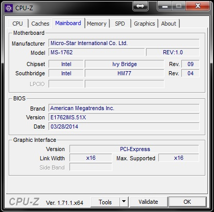

i've a MSI barebone equipped with 1762 mainboard and the unlucky GTX 675m.
I've installed this MSI bios E1762IMS.51X

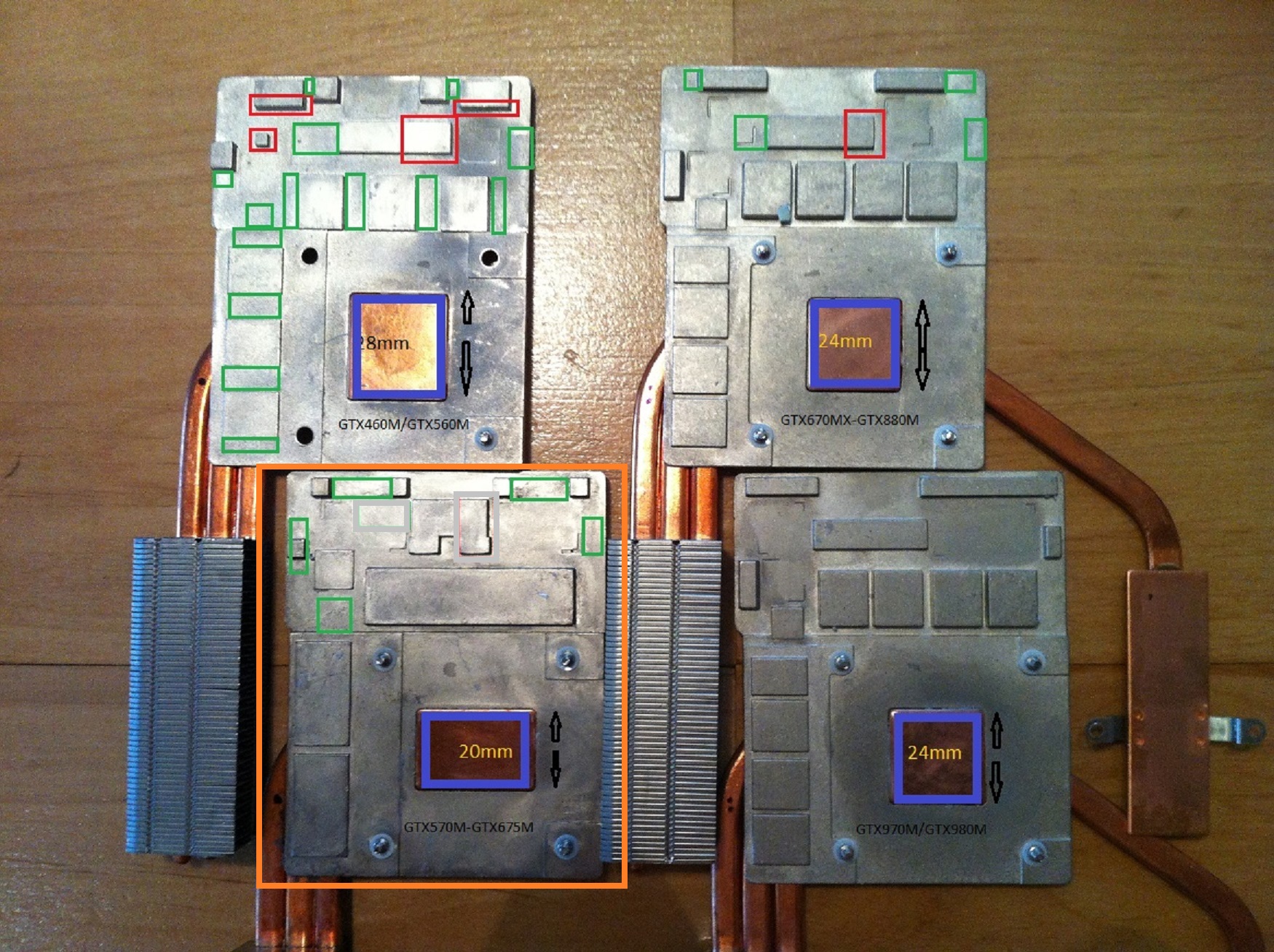

you need 0.5mm for the vRAM and 1mm for the voltage converter, at this point can the 0.5mm also work...

About the bios you must install E1762IMS.51X, should be compatible with all kepler cards.
It is then necessary to change the heat sink as explained in the second post.

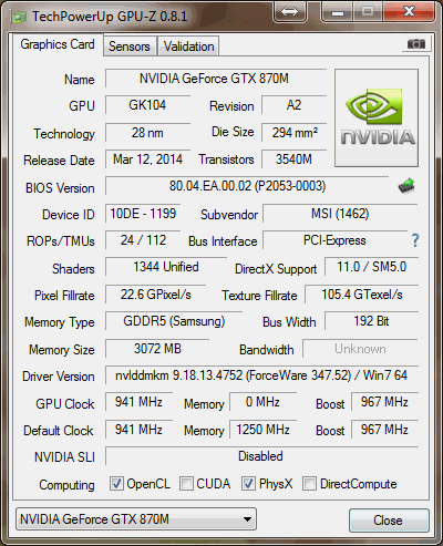

Finally I got the heat sink and I assembled everything, was sufficient to install the latest drivers available and the card works wonders!!
Compared to the old 675m temperatures are 10-12 ° C lower .... awesome!!

I have spoken with Svet and the way he explained things is that the .51X bios (as well as the .71X bios) are made for the retail version of the 1762 (there's also a version for the 15" 16F3), flashing this bios on a barebone system is in fact "cross flashing", your system is indeed the barebone 1762? everything went smoothly with the bios update to .51X ? what was your old bios version?(mine is still .30U)
Hello samXLR,
I confirm that my notebook is 1762 barebone, I bought it from DevilTech. The original version of the bios was E1762IG6.30J.
I flashed .51X without problem and all works great.

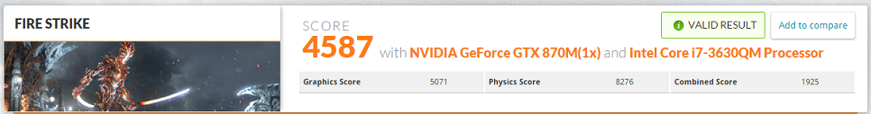

By the way, did you get a chance to run 3dmark13's firestrike standard test yet?
While I am looking forward to see your 3dmark results(upgraded gpu systems are not very common and when you normally see results for 800 series cards its with systems that shipped with 4th gen intel cpu, so seeing a 3rd gen or even 2nd gen intel cpu + 800 series or 900 series gpu is something both rare and informative, it helps put the value of cpu upgrade (or lack of) in place, similar to z97 desktop "K" suffix cpu + mobile gpu, just goes to show you how things compare)

Most impressive results! especially considering that normally an 4700HQ or 4800MQ only score ~4700points, and that your 675M used to score around 2200points, it definitely makes more sense to upgrade the GPU instead of the cpu+gpu, heck you just gained +- an addition of 100% performance!

you Can modify!
1. You can buy it:
Sample:
http://www.ebay.de/itm/NEW-MSI-Heat-Sink-ATI-Radeon-HD-7970M-8970M-for-msi-GX60-70-GT60-70-/151834323595?hash=item235a07ea8b:g:9GkAAOSw0HVWDGyi
2. Modify original Heatplate for GTX670m will take only 1 Hour - i will make a description for it with fotos here next days
I can modify,but not everyone can.
It is nonsens to buy a Heatsink for nearly 75-90€ for  a HD9870M when it is possible to use the GTX 670M Heatpipe for a Keplercard like K5000M with the Power of GTX 780M to GTX 880M
A K5000M or K41000M is cheaper and it needs only a little more Thermal Paste.
