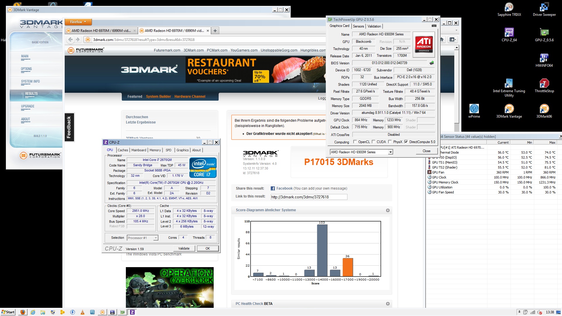

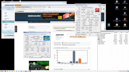

okay so the max i can get outta my 6990m without crashing 3D Mark Vantage is 864/1233 resulting in 17015 (booooom) 3D Mark Vantage! :D and as i stated before, my bclk max is 105.50.
screenshot to the 3D Mark Vantage run stated in my previous post. :D
