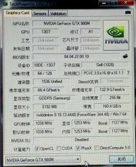

Some chinese dude (or girl) had no issues getting GTX 980M to work on AW17.

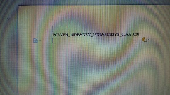

Not sure if that is a Dell GTX 980M or some other OEM 980M, but it seems from the pictures that the notebook had no issues booting in to windows and posting the card
After that ge did the INF trick to modify the driver and the vbios show "1028" which is the correct Subvendor ID for Dell and he was able to install Geforce drivers to finally see the GPU as GTX 980M and not "Nvidia GFX" you see from the last screenshot on the first page.

How does the vBIOS version number in those GPU-Z screen shots compare to the version number(s) of the vBIOSes that you have tried to use without success?
The picture is showing v10.
My stock is v12. I got v10 from prema.

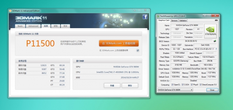

Thanks to "haru" from korean alienware foum who found another chinese success screen shot.
I have no idea whether it is optimus or not. He didn't mention.
All he mentioned was that he got it from EUROCOM.
The good thing about this screen shot is that vbios is DIFFERENT!!
84.04.22.00.10
84.04.22.00.12
84.04.22.00.0A
were vbios that I've got
This guy has 84.04.58.00.F2 (right? the screenshot is blur)

Can someone get 980m vbios 84.04.58.00.F2 version?
PM me, I will give my email address.
PM this good man right here.

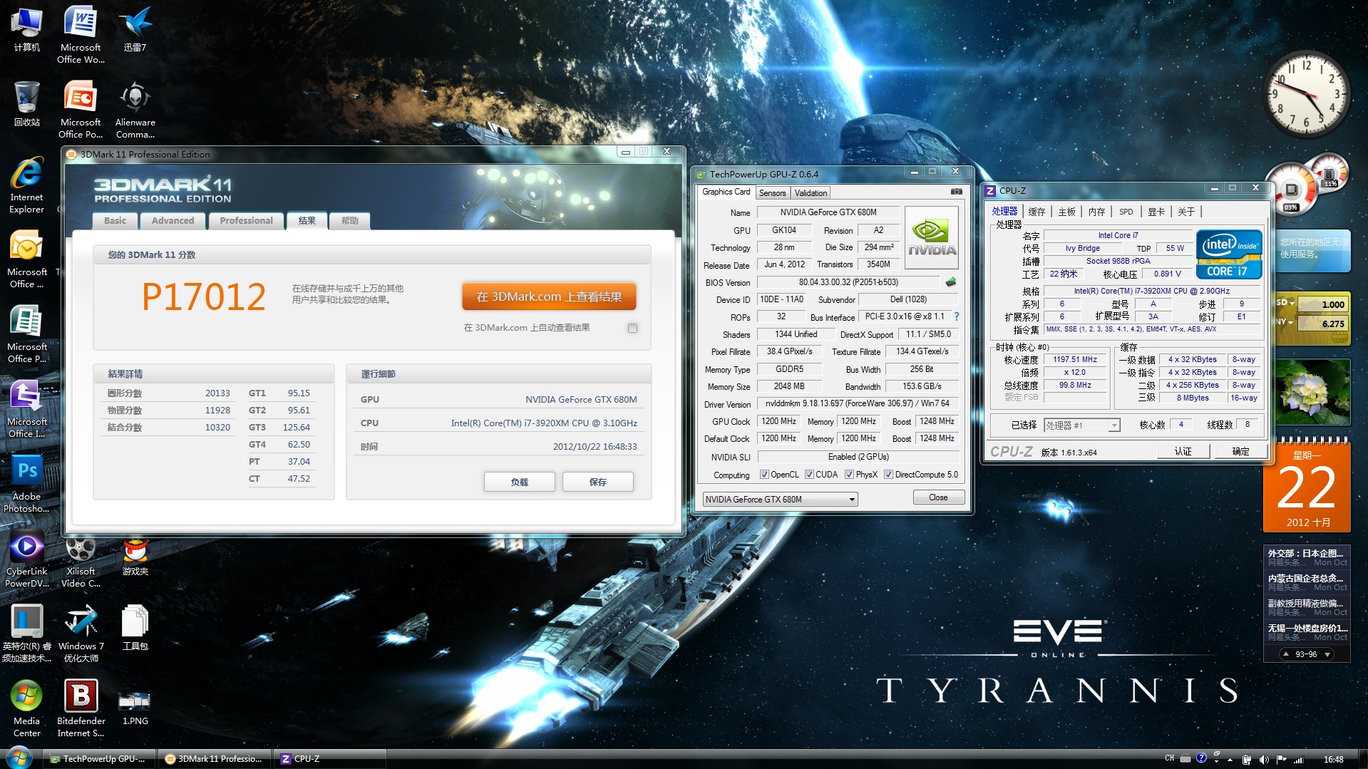

I think that guy is faking.
That's Wesley-Alex who was permanently banned from techinferno.
If "automatically view results at 3dmark.com" is clicked then the score must be shown in the web. But it is not.
I think he is lying again.
Look at this. This is his old fake-shot of 3920xm + 680m sli 2 yrs ago.
