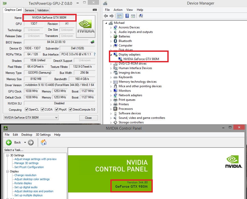

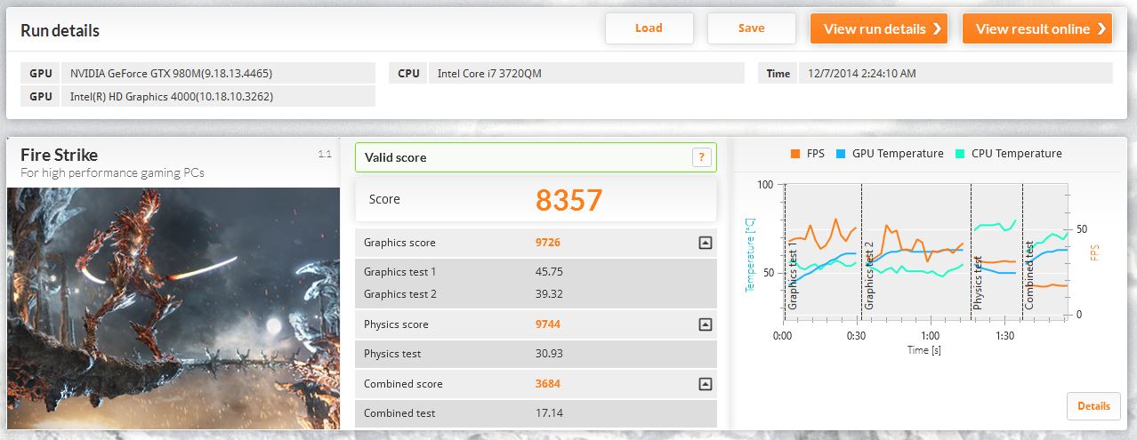

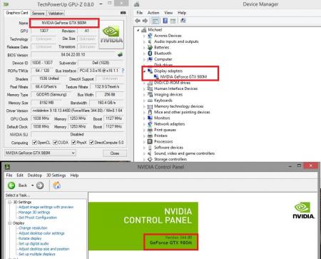

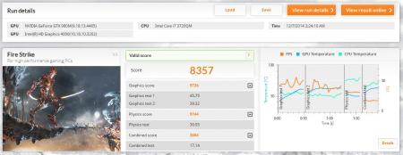

mikecacho Posted December 7, 2014 Share Posted December 7, 2014 Wanted to share (344.80), Thanks again J95! (device manager shows as Generic pnp since i did not place the modded nvdmi.inf file in) (added Eurocom modded nvdmi.inf back device shows as GTX 980M, cant validate 3D mark score) - - - Updated - - - With HD4000 enabled. CPU temps ran a bit higher. This was with 344.75 (shows scores as valid) 2 Quote Link to comment Share on other sites More sharing options...

mikecacho Posted December 7, 2014 Share Posted December 7, 2014 @J95PCI\VEN_10DE&DEV_13D7&SUBSYS_05801028&REV_A1 <--- that is what it showed when it could not detect the device correctly and still shows now, but i know for the R4 its .0511, so what exactly does .0580 refer to, this part i am confused on? (i assume it means PEG enabled 0580 vs 0511 being not enabled?)IDs are still PEG enabled, correct.-----Update-----I added the Eurocom modded nvdmi.inf back in (but they had it with HD graphics set to be on) the device still shows as GTX 980M but 3DMark still does not recognize it as valid, so i am hoping you can correct those strings to make it actually display my GPU in device manager without having to use HD4000 for this to show, thanks again. Quote Link to comment Share on other sites More sharing options...

J95 Posted December 7, 2014 Share Posted December 7, 2014 @J95PCI\VEN_10DE&DEV_13D7&SUBSYS_05801028&REV_A1 <--- that is what it showed when it could not detect the device correctly, but i know for the R4 its .0511, so what exactly does .0580 refer to, this part i am confused on? (i assume it means PEG enabled 0580 vs 0511 being not enabled?)IDs are still PEG enabled, correct.-----Update-----I added the Eurocom modded nvdmi.inf back in (but they had it with HD graphics set to be on) the device still shows as pnp generic, so i am hoping you can correct those strings to make it actually display my GPU in device manager without having to use HD4000 for this to show, thanks again.Nope, just use this one instead.nv_dispi.inf_v344.80_AW_0580_GTX_980M.zip 1 Quote Link to comment Share on other sites More sharing options...

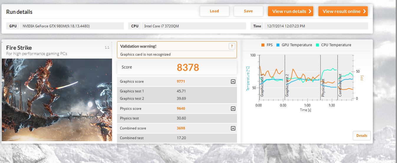

mikecacho Posted December 7, 2014 Share Posted December 7, 2014 @J95 It still shows as an unrecognized card when 3DMark is ran, but it shows as GTX980M on every other ID to include device manager>hardware ID, thats weird... Quote Link to comment Share on other sites More sharing options...
J95 Posted December 7, 2014 Share Posted December 7, 2014 Just use nv_dspi.inf (only) for v344.80, or install driver v344.75 using nvdmi.inf.It still shows as an unrecognized card when 3DMark is ran, but it shows as GTX980M on every other ID to include device manager>hardware ID, thats weird..Cacho/Carlos?Thanks to Dell nvdmi.inf is still about Kepler & Fermi. Valid result, 980M w/ Kepler entries (WHQL). nv_dispi and nvcvi.inf (Clevo) w/ proper Maxwell sections or disabling IGP is causing this, same results (Maxwell sections) http://www.3dmark.com/3dm11/9039457http://www.3dmark.com/3dm11/9039415 Quote Link to comment Share on other sites More sharing options...
