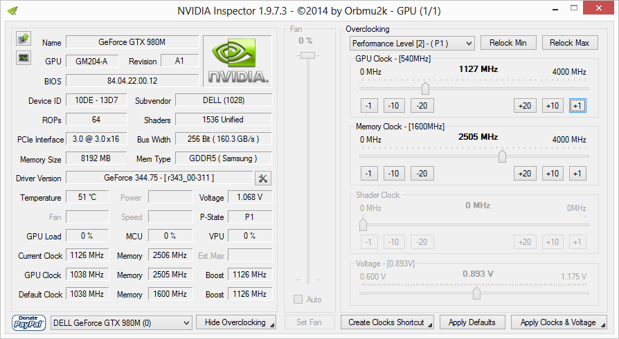

tanzmiester Posted December 4, 2014 Share Posted December 4, 2014 i have found the solution! nvidia inspector+evga precision that is. the only combination that allowed me to change memory clock and use full power. it seems that the card is locked in p2 mode for some reason.what i did: enabling K-boost in Precision, then altering P2 memory clock from 1600 to 2500. now getting +80% performance gain.perhaps this information can lead someone knowledgable what could be wrong with the card in this machine by default?P.S. k boost was the first thing i have tried, but it only boost the gpu clock, adding inpector to the mix added that missing 25% on memory.sorry, not p2, but p1 state! unlock max and bump memory clock to exactly 2500mhz and gpu to 1200, otherwise the slider goes down automatically when you exceed these values.- - - Updated - - -As I said, in new AW17 and AW18, the graphic score will be deducted 3-5% and clock fluctuates.not anymore for me. having same performance now as on my CLevo with this fix.i have kicked the k-boost in, and bumped up everything at P1 state in inspector and saved to startup loading. 1 Quote Link to comment Share on other sites More sharing options...

godfafa Posted December 4, 2014 Author Share Posted December 4, 2014 sorry, not p2, but p1 state! unlock max and bump memory clock to exactly 2500mhz and gpu to 1200, otherwise the slider goes down automatically when you exceed these values.- - - Updated - - -not anymore for me. having same performance now as on my CLevo with this fix.i have kicked the k-boost out of the mix now, just bumped up everything at P1 state in inspector and saved to startup loading.Nice solution.Does it work as 1038 / 2500 too? or do yo have to OC the clock to 1200? Quote Link to comment Share on other sites More sharing options...
tanzmiester Posted December 5, 2014 Share Posted December 5, 2014 Nice solution.Does it work as 1038 / 2500 too? or do yo have to OC the clock to 1200? no, it works on stock clock. but you have to put the clocks higher or equal to stock(1200 was just estimate) in P1 mode, in either way it will no exceed stock clocks when you change it in p1 state, nor on the core not on the memory. the core slider can be fixed at any frequency(but will actually work on stock when it set higher than that), while the memory slider resets with anything set higher than 2505Mhz. for further overclock on the core P0 state has to be altered or afterburner used. overclock on memory beyond 2505 is not possible with anything i have tried but i suggest to put boost frequency or higher at p1 state. which is 1127, otherwise you will get stuck at base frequency all the time. Quote Link to comment Share on other sites More sharing options...
godfafa Posted December 5, 2014 Author Share Posted December 5, 2014 no, it works on stock clock. but you have to put the clocks higher or equal to stock(1200 was just estimate) in P1 mode, in either way it will no exceed stock clocks when you change it in p1 state, nor on the core not on the memory. the core slider can be fixed at any frequency(but will actually work on stock when it set higher than that), while the memory slider resets with anything set higher than 2505Mhz. for further overclock on the core P0 state has to be altered or afterburner used. overclock on memory beyond 2505 is not possible with anything i have tried but i suggest to put boost frequency or higher at p1 state. which is 1127, otherwise you will get stuck at base frequency all the time. Well your saying looks like, you have to OC to match up the normal performance. Am I right? Quote Link to comment Share on other sites More sharing options...
tanzmiester Posted December 5, 2014 Share Posted December 5, 2014 Well your saying looks like, you have to OC to match up the normal performance. Am I right?i dont think you can call this overclock.my Clevo notebook is running same frequencies in Valley as my "overclocked" Dell machine and i get same test results.i have made 3 shortcuts on my desktop from Insperctor: Idle, balance and boost. so i can go with either mode when i want. /edit: actually not working properly, so only left the boost shortcut.if i really want to overclock - i can go up to 1261Mhz on the core, using +135 slider on both machines.i would guess there is somekind of a problem with boost tables reading with this machine, so it locks in 1 mode only when on the load.so the only way to fix it was to change the P1 state clock to what supposed to be full load clock of p0 state! Quote Link to comment Share on other sites More sharing options...
godfafa Posted December 5, 2014 Author Share Posted December 5, 2014 i dont think you can call this overclock.my Clevo notebook is running same frequencies in Valley as my "overclocked" Dell machine and i get same test results.i have made 3 shortcuts on my desktop from Insperctor: Idle, balance and boost. so i can go with either mode when i want.if i really want to overclock - i can go up to 1261Mhz on the core, using +135 slider on both machines.i would guess there is somekind of a problem with boost tables reading with this machine, so it locks in 1 mode only when on the load.so the only way to fix it was to change the P1 state clock to what supposed to be full load clock of p0 state!Oh I see.My friends have the same proble in AW17 with 980m.Can you confirm the steps to fix the problem?1. install precision X -> K-boost on2. nvdia inspector -> P1 states -> chage clock to stockthis is it right? Quote Link to comment Share on other sites More sharing options...
tanzmiester Posted December 5, 2014 Share Posted December 5, 2014 yes turned k- boost on, and changed the following state in inspector for max non overclocked boost and saved the shortcut on the desktop then click it anytime i need it: 1 Quote Link to comment Share on other sites More sharing options...
