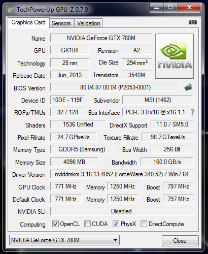

Lightning Posted September 2, 2014 Share Posted September 2, 2014 So yeah, hello, this is my first post here. Well, the point is I've run into some issue. Today I decided to flash the vBIOS of my MSI laptop (GTX 780M). Apparently, it was successful but now for some reason, the computer isn't detecting my card. In short, I believe the pictures will describe it better. Just see below: So should I like revert back to stock or is there something else that needs to be done? Also I still have the NVIDIA drivers but they're not being recognized at all. Any help will be appreciated. Thanks. Quote Link to comment Share on other sites More sharing options...

Lightning Posted September 3, 2014 Author Share Posted September 3, 2014 So this is what it looks like: I've also attached my original rom below in case it's necessary. gtx781m.zip Quote Link to comment Share on other sites More sharing options...

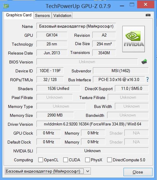

Fukurou Posted September 19, 2014 Share Posted September 19, 2014 I flashed vbios to modifyed one and now my GPU wont be recognized by system. Its not like I never flashed it before. On 675m I flashed vbios several times to modded one and everything went fine, but in this case, i used nvflash like before flashed to vbios from tech|inferno thread (Nvidia 'Kepler' GPUs - modified VBIOS files)and i got this Pic is partially in Russian. Up above it says something like "Standart VGA Adapter(Microsoft)" And now i cant flash back. It says something about not detecting any compitable hardware. Whats awkward is that i managed to install drivers. and I see them in GPUZ. I Know I was very stupid doing something like this, but is there any way to fix this? Or is it bricked already? Videocard is 780M SOLVED via DOS Quote Link to comment Share on other sites More sharing options...
