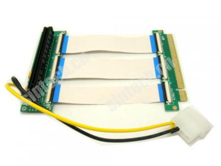

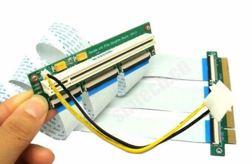

Building on Arclite's idea of a female-female PCIe 4x to x16 powered riser, can we connect 2 of the following PCIe x16 powered risers together using only the female portions? The cables are detachable. We will have a female-female PCIe x16 to x16 powered riser - one for the TB board (if it is a functional PCIe 4x card) and the other for the graphics card.

That's a nice idea, although it would be great if at least one of the female connectors was x4 so it wouldn't protude out of the top of the enclosure when connected to the TB board. I'm considering soldering a female half on a x4 to x4 riser cable but it's going to be tedious work.

I already have a self made molex to 4-pin yellow/black cable to the TB card, and I have tested it. Look at here. A standard 4-pin floppy molex plug was a little too big (but the holes seemed to have correct positions with the TB card's 4 pins). Those test results make me think that we need some kind of "loop" connection via the 4-pin yellow/black cable to the x16 PCIe slot. I still don't know what is the meaning of a very short beep sound when I did that continuity test from near DC jack points to the x16 PCIe 2nd pin. So before bypassing the PCIe board entirely, feeding 75W from the x4 connector to the x16 slot may be more workable solution.

It will depend on how the powered riser cable was built. The connector itself can withstand about 11A (122W) but a single wire can top out at 5A (60W) which is not sufficient to meet the 75W PCIe spec + power the TB card and may crash or burn out under load. Some powered risers use two 12V wires so in theory they can carry up to 10A (120W) which should be enough for everything.

Does your powered riser cable have a solid capacitor soldered on (like this one)? According to bitcoin mining forums, more recent versions of powered risers have capacitors built in to stabilize power supply and prevent system crashes under sustained load.
This is the one that I am using. It only has one 12V wire so I guess it supports up to 5A (60W)?
