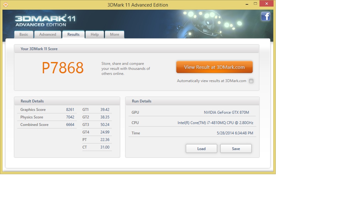

Red Line Posted May 26, 2014 Share Posted May 26, 2014 Special tnx to Klem for custom 870M vbios for P377SM-A. It has stock clocks with no turbo boost. I was able to get as high as 1032/3000, but anything higher than that resulted in system hang, even with increased voltage. Anyways, i reached 780M stock levels!NVIDIA GeForce GTX 870M video card benchmark result - Intel Core i7 4900MQ,Notebook P377SM-ANVIDIA GeForce GTX 870M video card benchmark result - Intel Core i7 4900MQ,Notebook P377SM-A Quote Link to comment Share on other sites More sharing options...
kingkaan Posted May 28, 2014 Author Share Posted May 28, 2014 Special tnx to Klem for custom 870M vbios for P377SM-A. It has stock clocks with no turbo boost. I was able to get as high as 1032/3000, but anything higher than that resulted in system hang, even with increased voltage. Anyways, i reached 780M stock levels!NVIDIA GeForce GTX 870M video card benchmark result - Intel Core i7 4900MQ,Notebook P377SM-ANVIDIA GeForce GTX 870M video card benchmark result - Intel Core i7 4900MQ,Notebook P377SM-Athose are some impressive scores man...congrats!...i would like to turn off turbo boost too...but i couldnt figure out how to..hope Klem helps out with it!..but damn with those scores...you can max out any game and basically get 60 fps consistent.- - - Updated - - -Special tnx to Klem for custom 870M vbios for P377SM-A. It has stock clocks with no turbo boost. I was able to get as high as 1032/3000, but anything higher than that resulted in system hang, even with increased voltage. Anyways, i reached 780M stock levels!NVIDIA GeForce GTX 870M video card benchmark result - Intel Core i7 4900MQ,Notebook P377SM-ANVIDIA GeForce GTX 870M video card benchmark result - Intel Core i7 4900MQ,Notebook P377SM-Aalso what processor do you have? it says 4900mq but it said the samething for mine..but i own a 4810mq 3.8 ghz..if you have the same cpu..id like to ask a few things..my physx score is at 6k..yours is at 10k...i don't know whats wrong with my cpu its not performing how it should be. it performs worse than the 4700hq.. Quote Link to comment Share on other sites More sharing options...

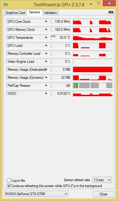

kingkaan Posted May 28, 2014 Author Share Posted May 28, 2014 Ok! Enjoy!Klem im having problems with turbo boost can you please turn it off for me? i couldnt figure out how to do it. Quote Link to comment Share on other sites More sharing options...
Bios Modder Klem Posted May 28, 2014 Bios Modder Share Posted May 28, 2014 Klem im having problems with turbo boost can you please turn it off for me? i couldnt figure out how to do it.In mod vbios Turbo boost is already disabled. Quote Link to comment Share on other sites More sharing options...
kingkaan Posted May 28, 2014 Author Share Posted May 28, 2014 In your mod vbios Turbo boost is already disabled.oh lol..i saw green lines in perfcap in gpu z thought it was because of turbo boost. Quote Link to comment Share on other sites More sharing options...
Bios Modder Klem Posted May 28, 2014 Bios Modder Share Posted May 28, 2014 oh lol..i saw green lines in perfcap in gpu z thought it was because of turbo boost.On the your screenshot i do not see green lines in perfcap. Quote Link to comment Share on other sites More sharing options...
kingkaan Posted May 28, 2014 Author Share Posted May 28, 2014 On the your screenshot i do not see green lines in perfcap.yeah no remember i raised the voltage and core clock to 1110.05? thats when it does it i thought it was a boost problem..what could it be? voltage at like 1.0750. Quote Link to comment Share on other sites More sharing options...
Bios Modder Klem Posted May 28, 2014 Bios Modder Share Posted May 28, 2014 yeah no remember i raised the voltage and core clock to 1110.05? thats when it does it i thought it was a boost problem..what could it be? voltage at like 1.0750.Yes, may be you rise voltage and core clock too high. Quote Link to comment Share on other sites More sharing options...
kingkaan Posted May 28, 2014 Author Share Posted May 28, 2014 Yes, may be you rise voltage and core clock too high. maybe..highest temp i hit is 83c in 3dmark11..after i installed new drivers yesterday from nvidia system started overheating and getting this green Quote Link to comment Share on other sites More sharing options...
