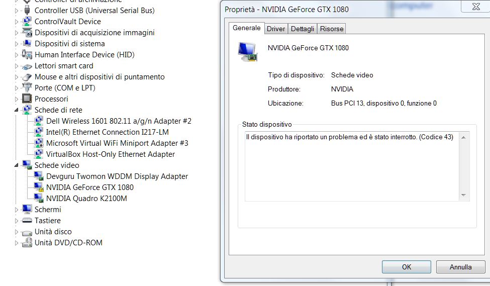

Hi all,
GDC arrived EXP 8
the beginning is not the best ...
Bench tests:
Laptop : Dell Precision M4800 (Nvidia Quadro K2100m)
EGPU: Nvidia 1080 GPU
At the first start I noticed that the external GPU power up when  laptop boot.
1) First start win7(x64) recognize the adapter and requires a reboot
2) Among the devices, it appears a new standard VGA
3) installing latest NVIDIA (custom drivers: only drivers and nothing else) and reboot
4) As soon as Windows starts up the speed of the 1080 sink goes to the max and then the GPU goes under protection. Windows continues to operate regularly, but in devices tab appears the warning yellow point on 1080 and writes it has been disabled because of a problem.
Now I have to check the switch present on the slot to see if it solves the problem.
Anyone had the same problems?
Thanks
Edited by Skanner
