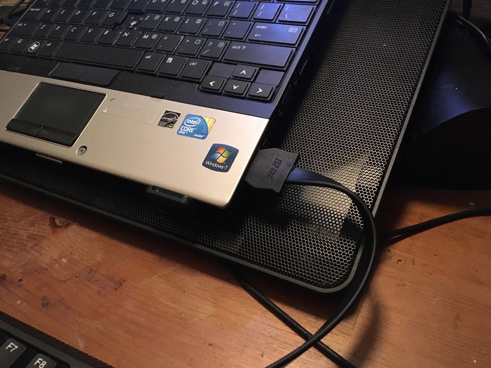

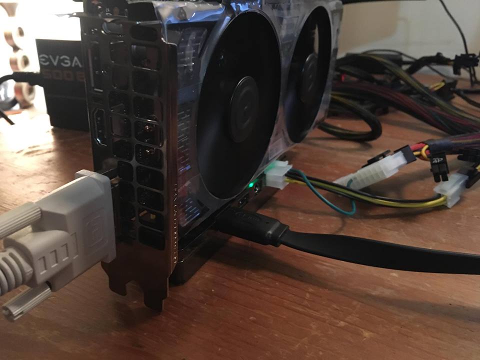

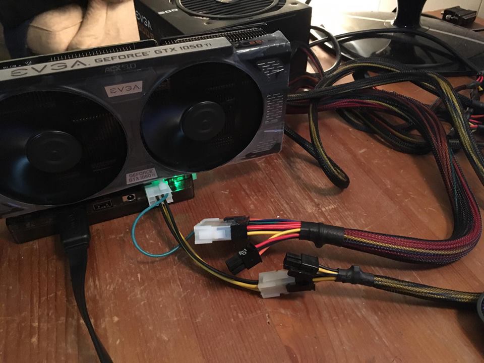

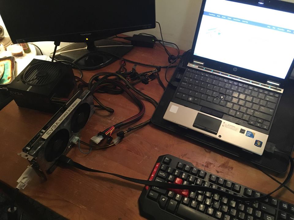

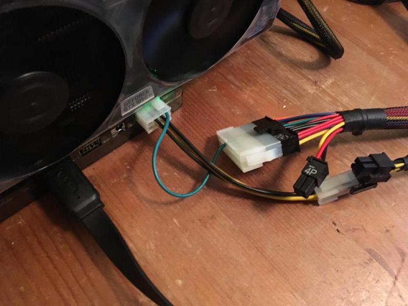

Joe Gonzo Posted December 9, 2016 Share Posted December 9, 2016 Hi guys, new to the forums i have read over the last few pages of this thread and also the trouble shooting guides that are around, and have tried numerous other websites for info so i figured i should try here: I bought the exp gdc 8.0 expresscard version, along with a 1050ti and a 500w psu, connected to an HP e2540p I have connected everything as it should be, but for some reason my pc is not picking up the connection, its not automatically finding it, nor will a manual hardware scan work. The gpu is on and fully running along with a green light. I have made sure the expresscard slot is open in the bios, tried booting the the pc with egpu plugged in but not on, hitting f8 to stop windows from booting, turning epu on then going to windows, along with booting the gpu in sleep mode, and while the pc is booting itself. Still no luck on finding the egpu. I have disabled lan and updated my bios. I cant seem to figure out why its not picking up the card at all. I do not have another lap top handy to see if the wire works on another but i will try to do that somehow soon. If anyone could offer advice it would be much appreciated. Attached a few pics for reference. Quote Link to comment Share on other sites More sharing options...

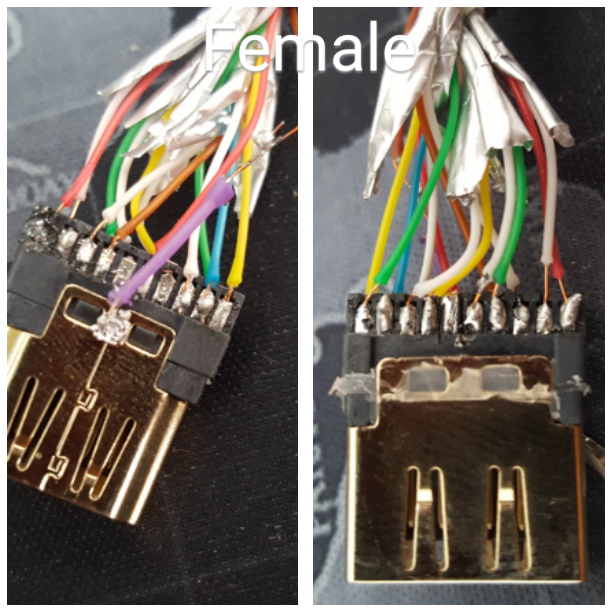

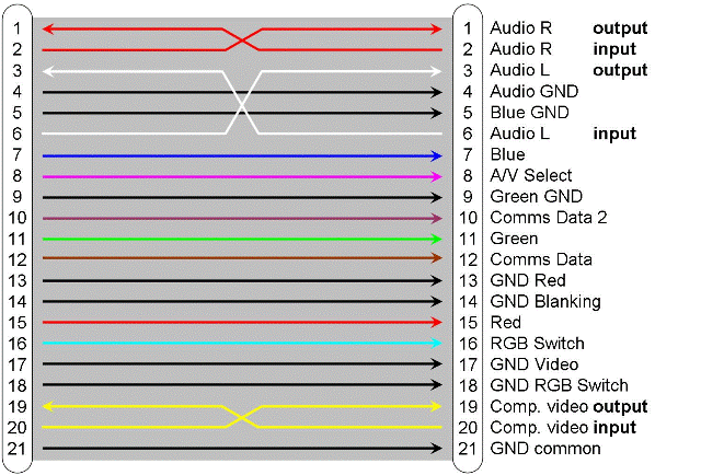

zeroonea Posted December 9, 2016 Share Posted December 9, 2016 Do you have wire connection diagram of egpu hdmi cable? Quote Link to comment Share on other sites More sharing options...

zeroonea Posted December 10, 2016 Share Posted December 10, 2016 I buy a female male hdmi and re-wire like this and it work with exp gdc beast expresscard cable Quote Link to comment Share on other sites More sharing options...
Mr_Western Posted December 10, 2016 Share Posted December 10, 2016 @zeroonea Thanks for the research man, a lot of people is going to appreciate the time you spent figuring out how to make an HDMI extension (as the original one was too short imo) @Plastixx Check the steps I had used in my DIY guide I posted before and see if it helps: https://www.techinferno.com/index.php?/forums/topic/5194-exp-gdc-beastares-v7v6-discussion/&do=findComment&comment=150916 There are specific steps I took on what I did to get rid of the error 12 message @Joe Gonzo Here is something you can try, once you are satisfied that all the other display drivers are gone (NOT INTEL GRAPHICS, KEEP THOSE) put your laptop to sleep and hot swap the GPU in, once you booted, manually download the drivers for you card from NVIDIA website and try running it. Two things can happen, it would install the driver or it will say your system isn't compatible (because the card isn't detected). This way you are sure it isn't Windows that is not playing around. FYI don't disable your LAN, that is your only means of internet and if that is disabled, windows won't be able to download any (basic) drivers for your card (as far as I know). Quote Link to comment Share on other sites More sharing options...

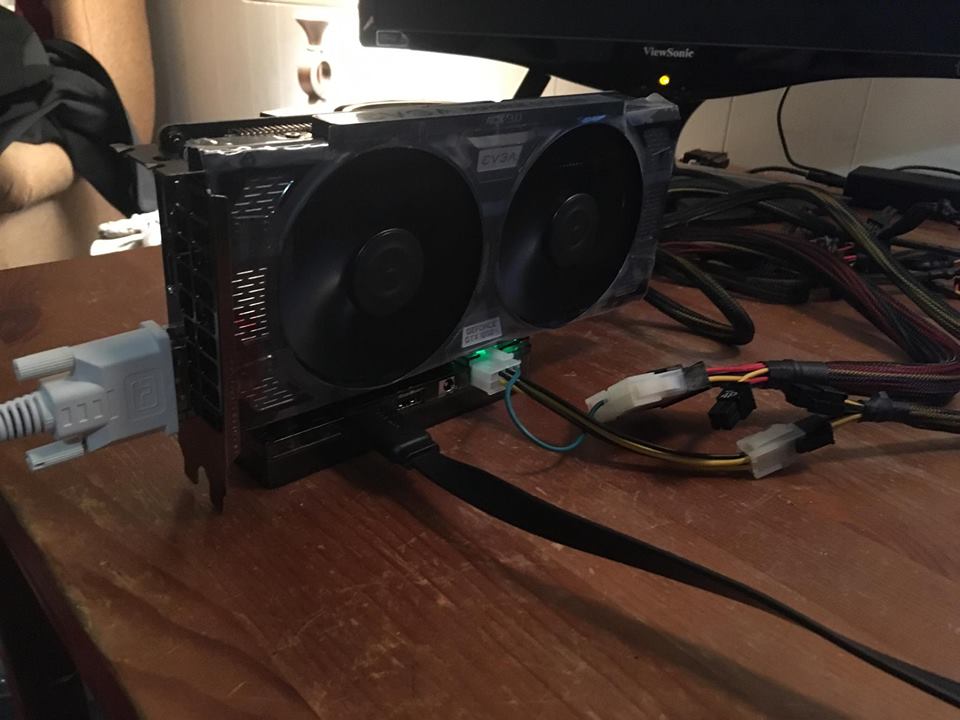

zeroonea Posted December 11, 2016 Share Posted December 11, 2016 I using 220W dell with exp gdc beast v8.4d. I want to put two more 12v fan (0.6A) into my gpu case, anyone help me wire the power source for two new fan? Quote Link to comment Share on other sites More sharing options...
