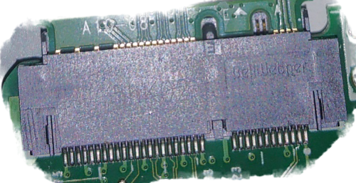

So the ngff version of EXP GDC beast adapters will work with that slot?? Also i dont see anything in my bios about disabling the onboard gpu,but im assuming theres away around that?
Hello.i have a toshiba s55 c5274 laptop that i was playing with the ideal of adding a egpu to,however i can NOT figure out if this port is a mPcie or a Ngff. It has a Intel 7265ngw wifi card in it,but some sites list that card as a Ngff and some say its a mPcie card.. All of the mPcie ports i have seen on the net have 8pins on the right while mine has 12pins..
