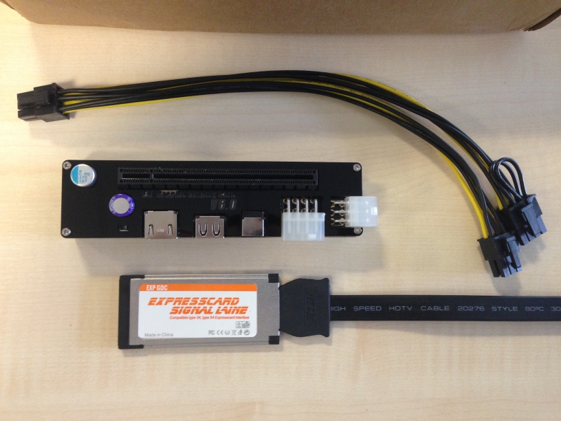

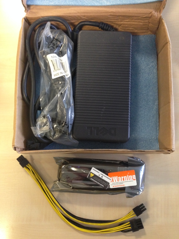

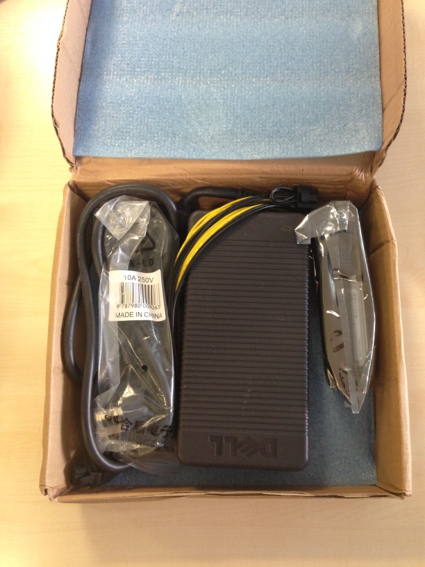

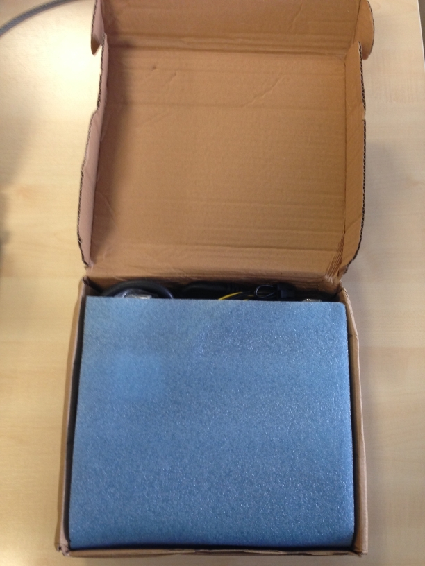

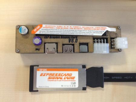

Sonek Posted May 5, 2014 Share Posted May 5, 2014 I just opened my package that arrived surprisingly quick. I made some pictures, if there is interest, I can post them here! Not powered it on since I don't have any VGA to put into it - expected it to arrive at least two weeks from now... I will borrow a test card tomorrow from a friend, but I only know that it will be an Nvidia one, so don't expect any real benchmark results yet... 2 Quote Link to comment Share on other sites More sharing options...
jacobsson Posted May 5, 2014 Author Share Posted May 5, 2014 was the package content as I explained earlier? Yes, please post some pics Quote Link to comment Share on other sites More sharing options...

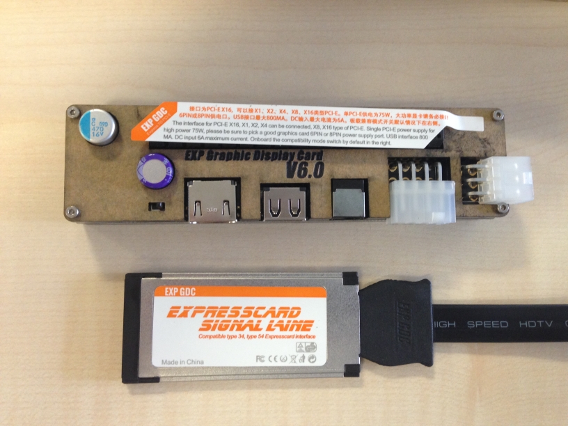

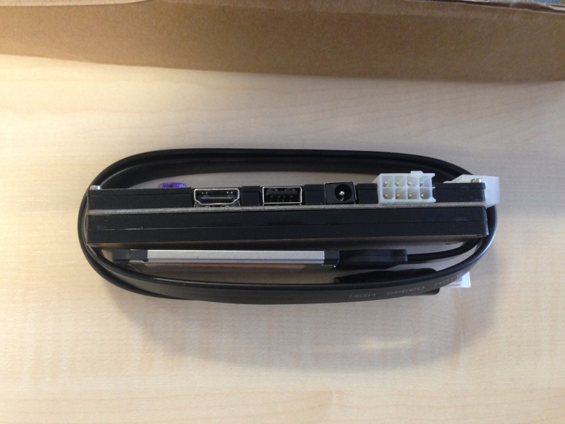

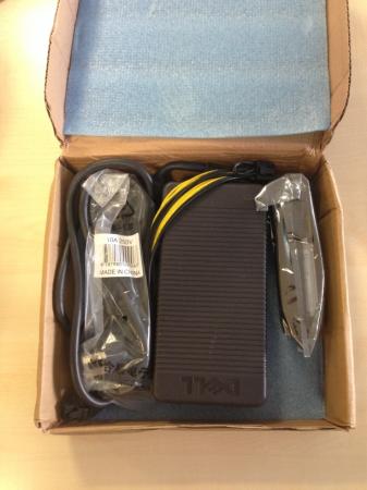

Sonek Posted May 5, 2014 Share Posted May 5, 2014 Box outside: Box inside: Contents: There was even some kind of protection on the plastic cover (this gives it that brown color): Protective film and label removed: - - - Updated - - - was the package content as I explained earlier? Yes, please post some pics Yes. They clearly told me that I won't receive an EU power cord and I didn't everything else is like described. 3 Quote Link to comment Share on other sites More sharing options...

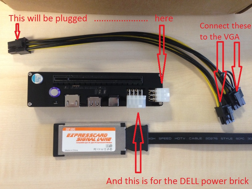

noric Posted May 5, 2014 Share Posted May 5, 2014 [ATTACH=CONFIG]11532[/ATTACH]Many thanks, Sonek!How is that PCI-E power cable going to be used? Quote Link to comment Share on other sites More sharing options...
Sonek Posted May 5, 2014 Share Posted May 5, 2014 Many thanks, Sonek!How is that PCI-E power cable going to be used? Please see annotations below (and forgive my limited paint skills ): You can see a complete setup here (from the product's detail page - animated gif): (Just noticed: pictured below is a v5.8, but never mind, the principle is exactly the same) Noric: thanks for correcting the gif! 1 Quote Link to comment Share on other sites More sharing options...
