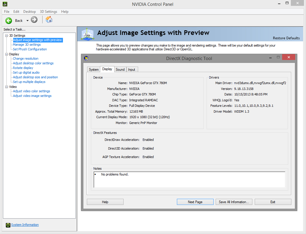

ssam_sm Posted October 26, 2013 Share Posted October 26, 2013 did you try to download the new version of the drivers, 331.xx that was released on oct 21.to have a easy fix for this, dont let the computer sleep or hibernate. if your not using your computer then just turn it off.I was just brave enough today to try the svl7 V-BIOS and the whole issue of flickering & white lines have all disappeared 100% and the notebook is working flawlessly in all games at 120hz, in SLI mode with no problem at all.Here is a list of games I have tried so far with the new Svl7 V-BIOS:Batman Arkham cityBatman Arkham originsAssassin Creed IIIJust Cause 2Sleeping Dogs 2Tomb Raider 2013Splintercell BlacklistFarcry 3 CrysisMetro 2033 & Metro Last lightBTW I have tried the new Nvidia driver 331.58 before modding my V-BIOS and it didn't work, it may even made the flickering worse.I'm really gratefully to Svl7 for making this V-BIOS & the only possible solution to this problem. I think the reason why this V-BIOS solved the problem is the SAGER V-BIOS version is so bad it doesn't have the correct voltage/wattage to feed the 2 GPU cards (in 120Hz) for good performance, thats why its always flickering & making all games f###d up because of the bad V-BIOS version that doesn't supply both GPUs with enough power to work properly.Thanks again to Svl7, Prema & Bud Marley for creating this post to resolve this huge problem which affects all the SAGER NP-9380S Notebooks. 3 Quote Link to comment Share on other sites More sharing options...

ViTosS Posted October 26, 2013 Share Posted October 26, 2013 I was just brave enough today to try the svl7 V-BIOS and the whole issue of flickering & white lines have all disappeared 100% and the notebook is working flawlessly in all games at 120hz, in SLI mode with no problem at all.Here is a list of games I have tried so far with the new Svl7 V-BIOS:Batman Arkham cityBatman Arkham originsAssassin Creed IIIJust Cause 2Sleeping Dogs 2Tomb Raider 2013Splintercell BlacklistFarcry 3 CrysisMetro 2033 & Metro Last lightBTW I have tried the new Nvidia driver 331.58 before modding my V-BIOS and it didn't work, it may even made the flickering worse.I'm really gratefully to Svl7 for making this V-BIOS & the only possible solution to this problem. I think the reason why this V-BIOS solved the problem is the SAGER V-BIOS version is so bad it doesn't have the correct voltage/wattage to feed the 2 GPU cards (in 120Hz) for good performance, thats why its always flickering & making all games f###d up because of the bad V-BIOS version that doesn't supply both GPUs with enough power to work properly.Thanks again to Svl7, Prema & Bud Marley for creating this post to resolve this huge problem which affects all the SAGER NP-9380S Notebooks.Nice to hear that, unfortunately for me the vbios didn't work, what OS are you running? And using the 331.58 driver as well? Can you post a screen of GPU-Z of your BIOS version? Because I did flash, and at the end it said sucessfull and everything, just to make sure I really flashed the bios.Thanks. Quote Link to comment Share on other sites More sharing options...

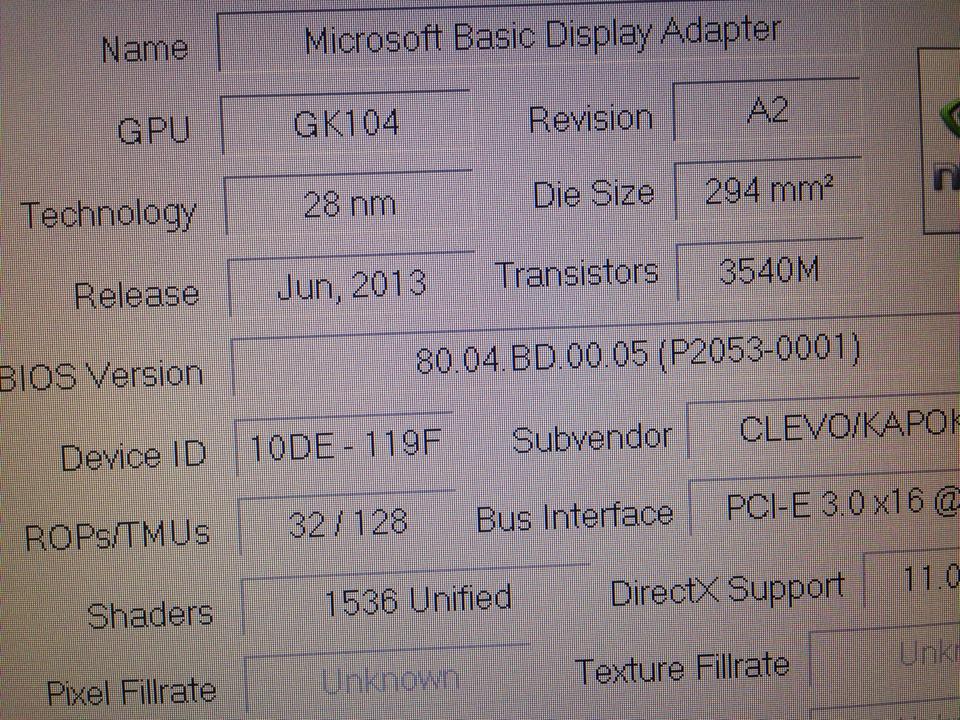

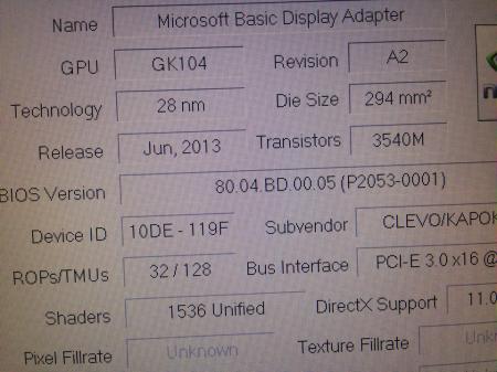

ViTosS Posted October 26, 2013 Share Posted October 26, 2013 @ViTosS Make sure to check the VBIOS version on each GPU with GPU-Z to verify that both cards where flashed.@xigital Re-install the 3D VISION (Emitter driver)...also what are your systems main BIOS & EC versions (shown in F2 boot/BIOS menu) Took a print from GPU-Z, this is the version of the vBios, what do you think Prema? Is it really the sl7? Quote Link to comment Share on other sites More sharing options...
BudMarLeY Posted October 26, 2013 Author Share Posted October 26, 2013 Took a print from GPU-Z, this is the version of the vBios, what do you think Prema? Is it really the sl7?what about the second GPU, make sure they both match up. Quote Link to comment Share on other sites More sharing options...
Guest Posted October 27, 2013 Share Posted October 27, 2013 Took a print from GPU-Z, this is the version of the vBios, what do you think Prema? Is it really the sl7? That's not svl7 vBIOS...also no driver installed and it's only one of the gpus... Quote Link to comment Share on other sites More sharing options...
ViTosS Posted October 27, 2013 Share Posted October 27, 2013 That's not svl7 vBIOS...also no driver installed and it's only one of the gpus... Really? Damn, but I did everything in the tutorial from Nvidia BIOS Flash thread, it asked if I wanted to flash and I typed yes and asked something again and I typed yes, it did a beep sound and said at the end the bios was flashed sucessful Quote Link to comment Share on other sites More sharing options...

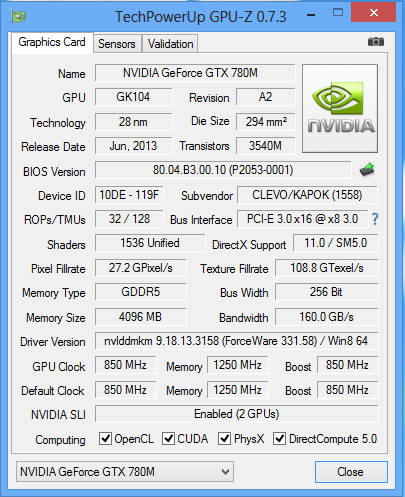

ssam_sm Posted October 27, 2013 Share Posted October 27, 2013 Hey Vitoss, I run Windows 8 64 bit, yes Im using the latest 331.58 driver & my V-Bios is the Svl7. Here is a Shot from my GPU-Z, its exactly the same for both cards. Just to be clear I tried all the Nvidia drivers even the latest version before flashing the Svl7 V-BIOS and nothing worked, only the V-BIOS solved the problem. I did try Battlefield 3 also and its working fine. Note: All the games tested with Alt+Tab and back & forth at least 20 times. 2 Quote Link to comment Share on other sites More sharing options...
BudMarLeY Posted October 27, 2013 Author Share Posted October 27, 2013 Really? Damn, but I did everything in the tutorial from Nvidia BIOS Flash thread, it asked if I wanted to flash and I typed yes and asked something again and I typed yes, it did a beep sound and said at the end the bios was flashed sucessfulthat vbios version you have in your image is the stock clevo 780m vbiosyour version your using right now is 80.04.BD.00.05svl7's is 80.04.B3.00.10 1 Quote Link to comment Share on other sites More sharing options...
