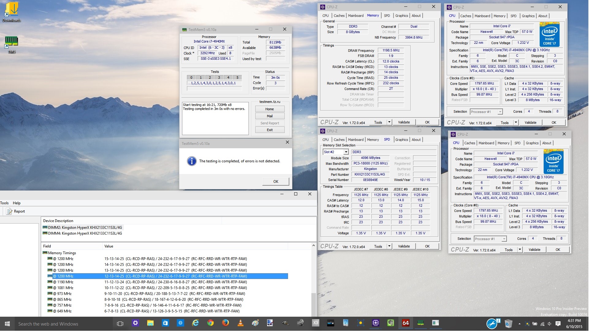

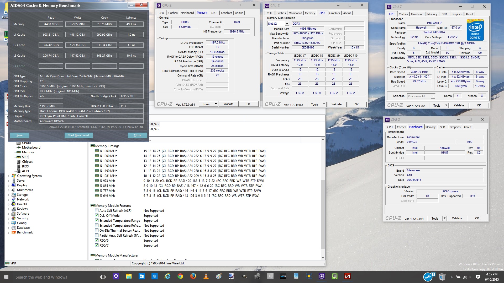

@Khenglish you asked me a question and had no answer at the time. I can run 2400mhz on all the stock timings for those hyperx imppact secondary timings. So I didn't need Tfaw or others so high at all as I would of thought I would because desktop ram needs that high often. Here are pics for you on the new timings tested. This pair is on the Alien 18.
2400mhz 12-13-14-25 with stock 2133mhz secondary timings used TM5 pass
2400mhz 12-13-14-25 with stock 2133mhz secondary timings used Aida run

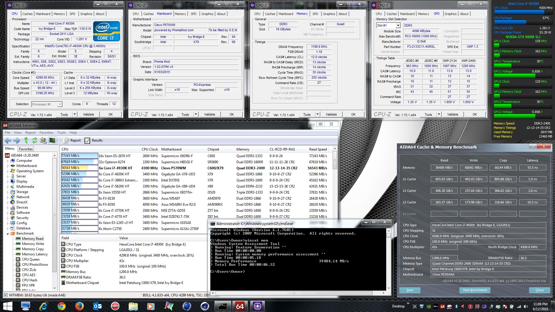

Hi @J95 the xmp are posted right here for you buddy. Ill have to make another on and post it as well that isnt on as toght timings so you can use it for testing 2400.

cheers pm me if you want I can help get you what you need to get going in any case :)

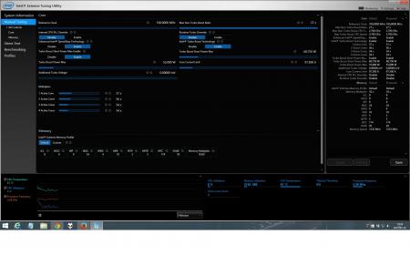

I have Clevo P370EM with @Prema bios and now as I am in possession of i7-2960XM I wanted to try OC this CPU. This is 3rd gen CPU platform but compatible with 2nd gen CPUs as well. I have newest XTU software but I could not find any luck with OC. I just cant do it work with higher multipliers. Maybe someone can just tell me what should be changed and what values would be good for the start. Maybe I am doing everything wrong - it's frustrating:(
http://s10.ifotos.pl/img/ss-xtu-i7_wqppqer.jpg

I cant see the second picture. How can I help. I had a 2960xm before.

@J95 can you please share BIOS settings for removing motherboard power limit since I now have unlocked BIOS
@J95 as I have been also asking in my PM's, how did you successfully get past the TDP limit in the end? I have tried various combinations of things in this thread however it would be really helpful for me and other owners if you could get together a list of things that need to be done to get past it, like BIOS settings etc...
I have disabled MSR lock, remove the TDP lock and tried various combinations of settings however this isn't getting anywhere.. As on my thread in NBR, the minute I start the XTU stress test, the power limit gets hit in like 5 secs and clocks throttle from 4.3Ghz on 4 cores to 3.8GHz...

Edit: I have got this showing in the BIOS.. Turbo power limit registers are not matching... This seems to be the problem for me... Any suggestions?
