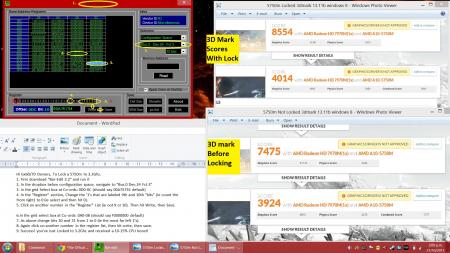

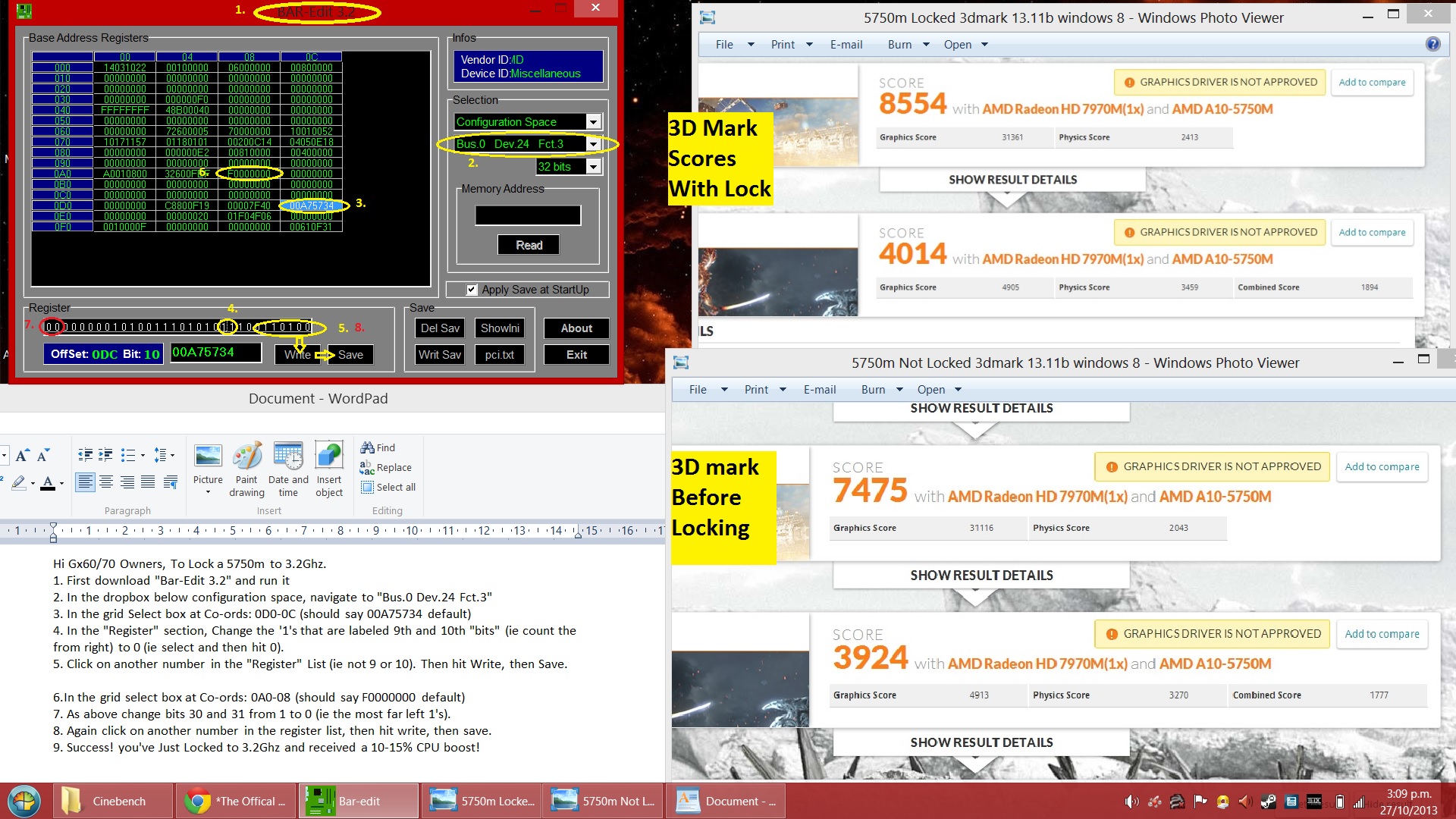

skidmarek Posted October 27, 2013 Share Posted October 27, 2013 Hi Gx60 Owners, Kenglish's Method Gives the GX60/70 A great boost so in order to simplify the method for beginners I've Described the entire process with one Image, Enjoy! 12 Quote Link to comment Share on other sites More sharing options...

busy0201 Posted November 2, 2013 Share Posted November 2, 2013 Hi Gx60 Owners,Kenglish's Method Gives the GX60/70 A great boost so in order to simplify the method for beginners I've Described the entire process with one Image, Enjoy![ATTACH=CONFIG]9378[/ATTACH]Thanks for this how to do Quote Link to comment Share on other sites More sharing options...

ztf Posted January 14, 2014 Share Posted January 14, 2014 Hi Gx60 Owners,Kenglish's Method Gives the GX60/70 A great boost so in order to simplify the method for beginners I've Described the entire process with one Image, Enjoy![ATTACH=CONFIG]9378[/ATTACH]Hey skidmarek, I just made my account and am trying to reduce the bottleneck the 5750m is giving my 8970m as well as the headaches this gives me. Apparently I can't see the image you posted (I am aware it's been a while), could you rehost it to imgur or something of the sort? I am not able to figure out Khenglish's instructions past the fourth paragraph. Thanks in advance. Quote Link to comment Share on other sites More sharing options...
Chrack Posted January 16, 2014 Share Posted January 16, 2014 I can see the Picture from skidmarek. So the Picture is not deleted Quote Link to comment Share on other sites More sharing options...
ztf Posted January 20, 2014 Share Posted January 20, 2014 I can see the Picture from skidmarek.So the Picture is not deleted I can't, when I try it gives me this message: ztf , you do not have permission to access this page. [*=2]This could be due to one of several reasons:Your user account may not have sufficient privileges to access this page. Are you trying to edit someone else's post, access administrative features or some other privileged system?[*=2]If you are trying to post, the administrator may have disabled your account, or it may be awaiting activation. However I have activated my account already and don't know why this message is showing up, could anyone send me a pm or reply with the rehosted image (this image by skidmarek? Quote Link to comment Share on other sites More sharing options...
Chrack Posted January 22, 2014 Share Posted January 22, 2014 You need min. 5 post to see the Picture. Read the FAQ Gesendet von meinem GT-I9205 mit Tapatalk 2 Quote Link to comment Share on other sites More sharing options...
