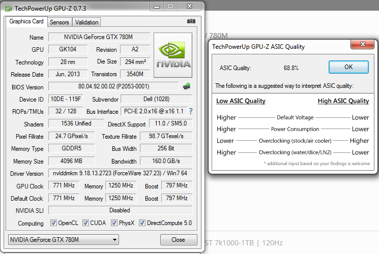

J95 Posted November 3, 2013 Share Posted November 3, 2013 137MHz limit with stock vBIOS/ GPU boost 1.012v, GPU-Z check ASIC quality.http://forum.techinferno.com/nvidia/5054-modded-nvdmn-inf-v331-65-alienware-m17xr2-r3-r4-3d-m18xr1-r2-nvidia-gtx-680m-780m.html 1 Quote Link to comment Share on other sites More sharing options...
link3rd Posted November 3, 2013 Share Posted November 3, 2013 GPU boost 1.012v, GPU-Z check ASIC quality.http://forum.techinferno.com/nvidia/5054-modded-nvdmn-inf-v331-65-alienware-m17xr2-r3-r4-3d-m18xr1-r2-nvidia-gtx-680m-780m.html is it bad? Quote Link to comment Share on other sites More sharing options...
J95 Posted November 3, 2013 Share Posted November 3, 2013 I will ALWAYS sacrifice pretty graphics to get the frame rate fluidity I want. This is not the case with the 780m 4GB, absolute overkill for that resolution.[ATTACH=CONFIG]9430[/ATTACH]is it bad?Nope, you probably will need to increase v. for the core, memory OC 300-500MHz no overvolting required. Quote Link to comment Share on other sites More sharing options...
link3rd Posted November 3, 2013 Share Posted November 3, 2013 This is not the case with the 780m 4GB, absolute overkill for that resolution.Nope, you probably will need to increase v. for the core, memory OC 300-500MHz no overvolting required.I understand, but remember I bought this laptop over 2 years ago. I only had a 1Gb 6870m at the time. Which is far less powerful than this 780m. What's your ASIC? Quote Link to comment Share on other sites More sharing options...

Robbo Posted November 3, 2013 Share Posted November 3, 2013 Same thing I had in mind. Btw, what's your ASIC? my other card, it was like 73% I believe. Is 68% better or worse? IDKMine is 76.6%. It's supposed to relate to how easily you'll be able to overclock, the higher the ASIC quality the higher you'll likely be able to overclock. I'm not sure how good of an indication it is though, and besides it's not like you can change it; if you're gonna overclock, then all you can do is find the highest stable settings, knowing the ASIC quality is not going to affect that. Quote Link to comment Share on other sites More sharing options...
link3rd Posted November 3, 2013 Share Posted November 3, 2013 Mine is 76.6%. It's supposed to relate to how easily you'll be able to overclock, the higher the ASIC quality the higher you'll likely be able to overclock. I'm not sure how good of an indication it is though, and besides it's not like you can change it; if you're gonna overclock, then all you can do is find the highest stable settings, knowing the ASIC quality is not going to affect that. I gotcha. You won't believe how TERRIFIED I am to do benchmarks, flash the vBios, and even overclock or increase the voltage (if i flash)... it's sad:33_002: Everything's finally working again and I don't want to screw it up! EDIT: when I had my 6870m and my 6990m, I didn't care about overclocks or bench marking... I don't know why I'm like this now.... it's so weird! If load up svl7's bios, will it change the ASIC reading in gpuz? Quote Link to comment Share on other sites More sharing options...
J95 Posted November 4, 2013 Share Posted November 4, 2013 Nothing will change the ASIC reading it only means that you will need to increase v more when overclocking, as I said before no overclocking is required at all even more with the 1600x900 resolution. Quote Link to comment Share on other sites More sharing options...

bikaso Posted November 4, 2013 Share Posted November 4, 2013 [ATTACH=CONFIG]9430[/ATTACH]is it bad? congratulations for the new one bro , NO overclocking for now Plz and no crazy bench marking like what i did before (NOOO Geek 3D furmark like J95 said) first of all show me idle temp. and loaded one with the benchmarks Quote Link to comment Share on other sites More sharing options...
