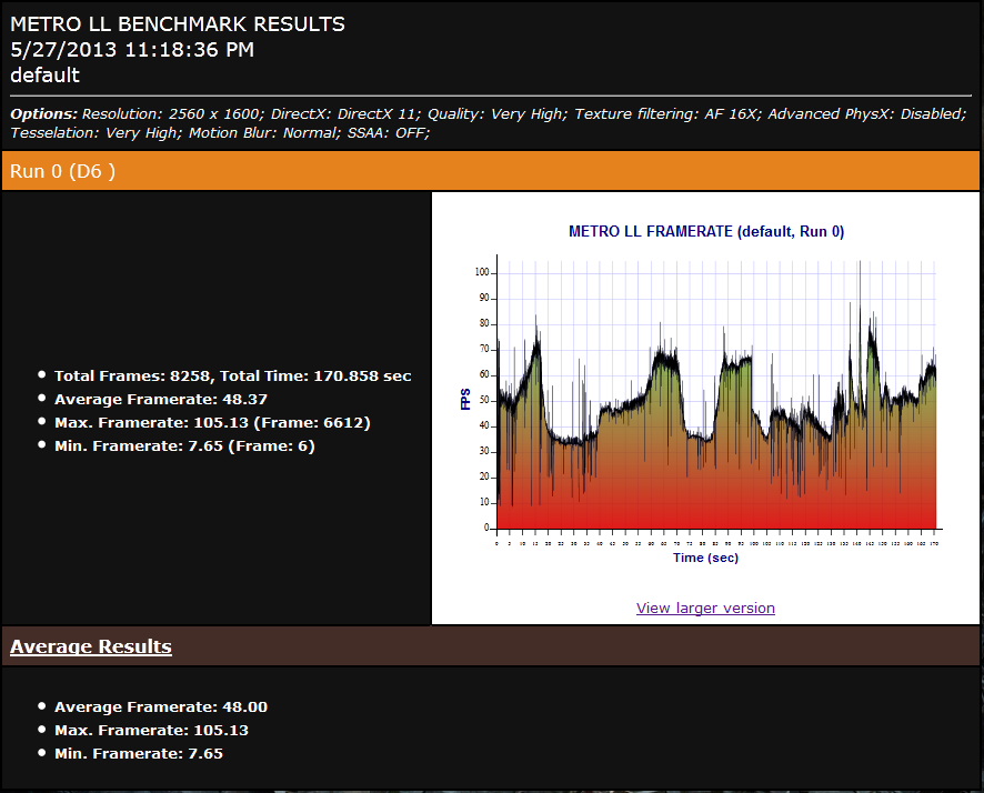

zinfinion Posted May 28, 2013 Share Posted May 28, 2013 Got it up to 1228/3480. Stock BIOS - 1137/3400 Mod BIOS - 1228/3480 I have no idea if that is actually game stable, but the scaling seems pretty linear with the core clock OC. 7% gain for a 8% OC. Not bad. 3 Quote Link to comment Share on other sites More sharing options...

Founder Brian Posted May 28, 2013 Founder Share Posted May 28, 2013 Got it up to 1228/3480. [ATTACH=CONFIG]7677[/ATTACH] Stock BIOS - 1137/3400 [ATTACH=CONFIG]7678[/ATTACH] Mod BIOS - 1228/3480 I have no idea if that is actually game stable, but the scaling seems pretty linear with the core clock OC. 7% gain for a 8% OC. Not bad. Thanks and what's your hardware setup + driver version? Some people have reported issues with the latest nvidia driver but I don't see any difference on my Titan. Quote Link to comment Share on other sites More sharing options...
