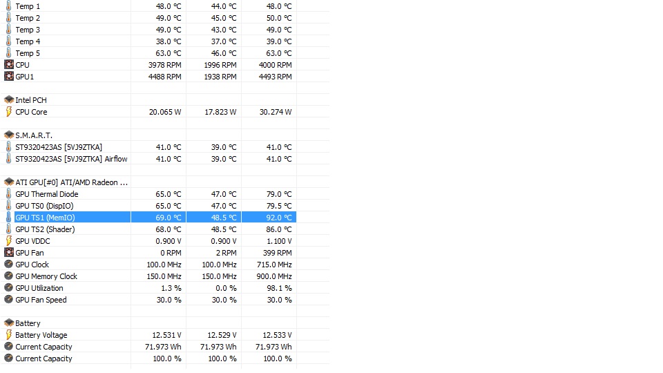

Thank you for your link. I downloaded the hwinfo file and started it.
During daily work the temperatures do no climb over 52° C.

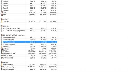

I played Battlefield 3 for one hour on Detail Level High. After this I checked hwinfo and looked up the temperatures of the gpu.
I attached the picture to this post.
I think everything is running smoothly. Just the temperature shown at GPUTS1(MemIO) climbed up to 92°C. Is this ok?
In case this this temp is too high, what can I do in order to decrease it?
Thank you for your help.
Temps are okay, but you could improve them a bit I guess e.g. by slightly modifying the heatpipes as explained somewhere in this thread or the first post. MemIO is just another diode on the die, just as the shaders, it might get a bit hotter than the shader, but if you're heatsink is mounted properly and the thermal paste well applied it shouldn't make a huge difference.

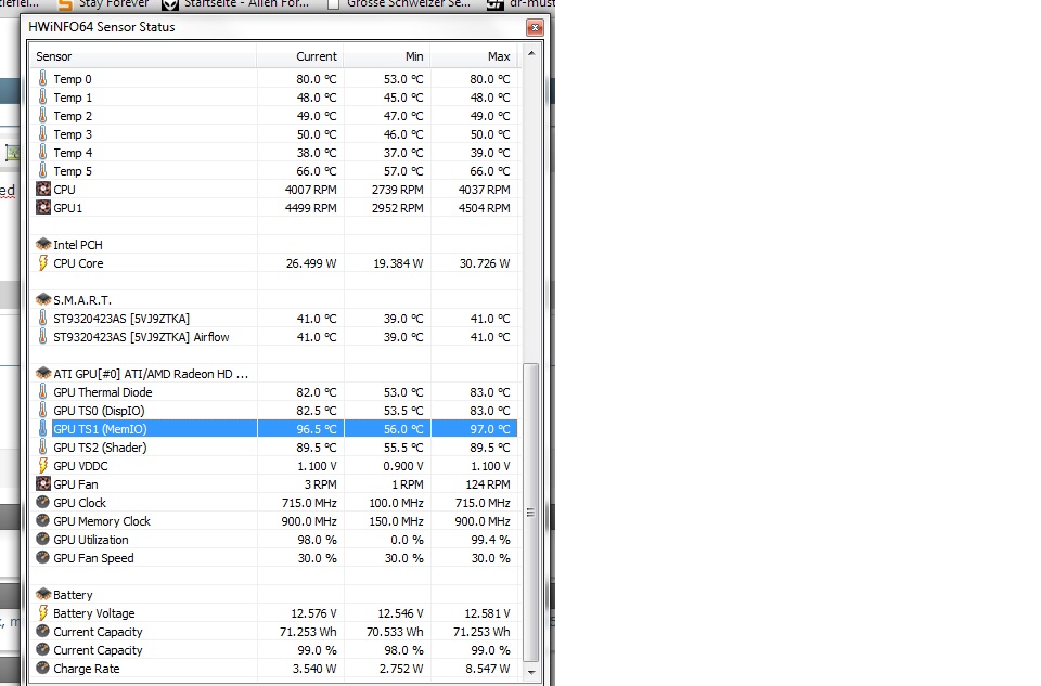

After repasting the GPU and grinding down the baseplate as described I checked temps again.
I used Unigine heaven benchmark as last time.
After 20 minutes the shown temps surprised me a bit, because temps climbed up even more.
Is this OK or do I need to reopen the M15x again and do something else? I am quite sure, that I did not miss any space in the GPU DIE and the heatsink sits tight on the DIE.
I used arctic cooler silver 5 paste.
Well, how did you apply the paste? The best method and only one which I can recommend for chips without heatspreaders is to apply a small dot of paste in the middle of the die, and then mounting the heatsink, this will spread it evenly across the die are. Don't spread it by hand. Use only a little paste, maybe as much as two grains of rice, that's enough.
