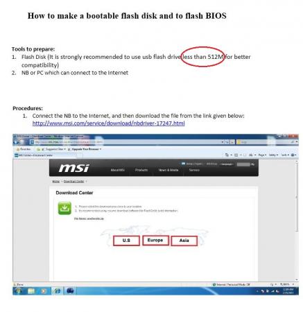

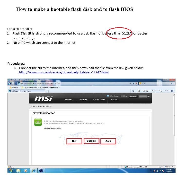

Username Posted May 13, 2013 Share Posted May 13, 2013 Has anyone tried to flash the win7 Bios with a USB Stick larger than 512MB ??? The oldest one I still have is a "1GB Corsair Flash Voyager USB2.0" If anyone had problems with > 512MB did the flash software refuse to flash the bios or did it even lock up your system because of flash error ??? MSI strongly recomends this < 512MB in their flashing manual as know from POST NO. 1 Link to comment Share on other sites More sharing options...
jackff Posted May 13, 2013 Share Posted May 13, 2013 I reflash the flash drive 8 GB and all is well) Maybe it's your flash drive, because the 512 - very old stick) Link to comment Share on other sites More sharing options...
destructo Posted May 13, 2013 Share Posted May 13, 2013 Why would It make a difference if the usb stick is greater in size than 523 kb? I actually am asking this.. not just flaming, I actually want to know because ive not seen a flash drive less than 2gigabytes in years and the smallest I have is 32 gigabyte... or mayybbeeeeeee an old 16 gb layin around somewhere.. but I need to flash this bios,, as I hate not having ANY options in my bios lol and now I see that there could possibly be an issue for some crazy reason ive never heard of with a drive greater than 512 kb?!? I really want to know,, does anybody know why it might be an issue? or an experience trying this with any standard modern flash drive? Link to comment Share on other sites More sharing options...
Username Posted May 13, 2013 Share Posted May 13, 2013 @jackffMSI strongly recomends this < 512MB in their flashing manual as know from POST NO. 1And you used your 8GB USB Stick for a Win7 bios flash without problems? Link to comment Share on other sites More sharing options...
jackff Posted May 16, 2013 Share Posted May 16, 2013 @jackffMSI strongly recomends this < 512MB in their flashing manual as know from POST NO. 1And you used your 8GB USB Stick for a Win7 bios flash without problems?My notebook - ge70 with dos - now - win7 with new bios) I have a flash drive only 8, 4 and 32 gigabytes.And yes, I have had no problems - do not forget the ones that the flash drive must be FAT or FAT32 - ntfs not work - does not run dos) Link to comment Share on other sites More sharing options...

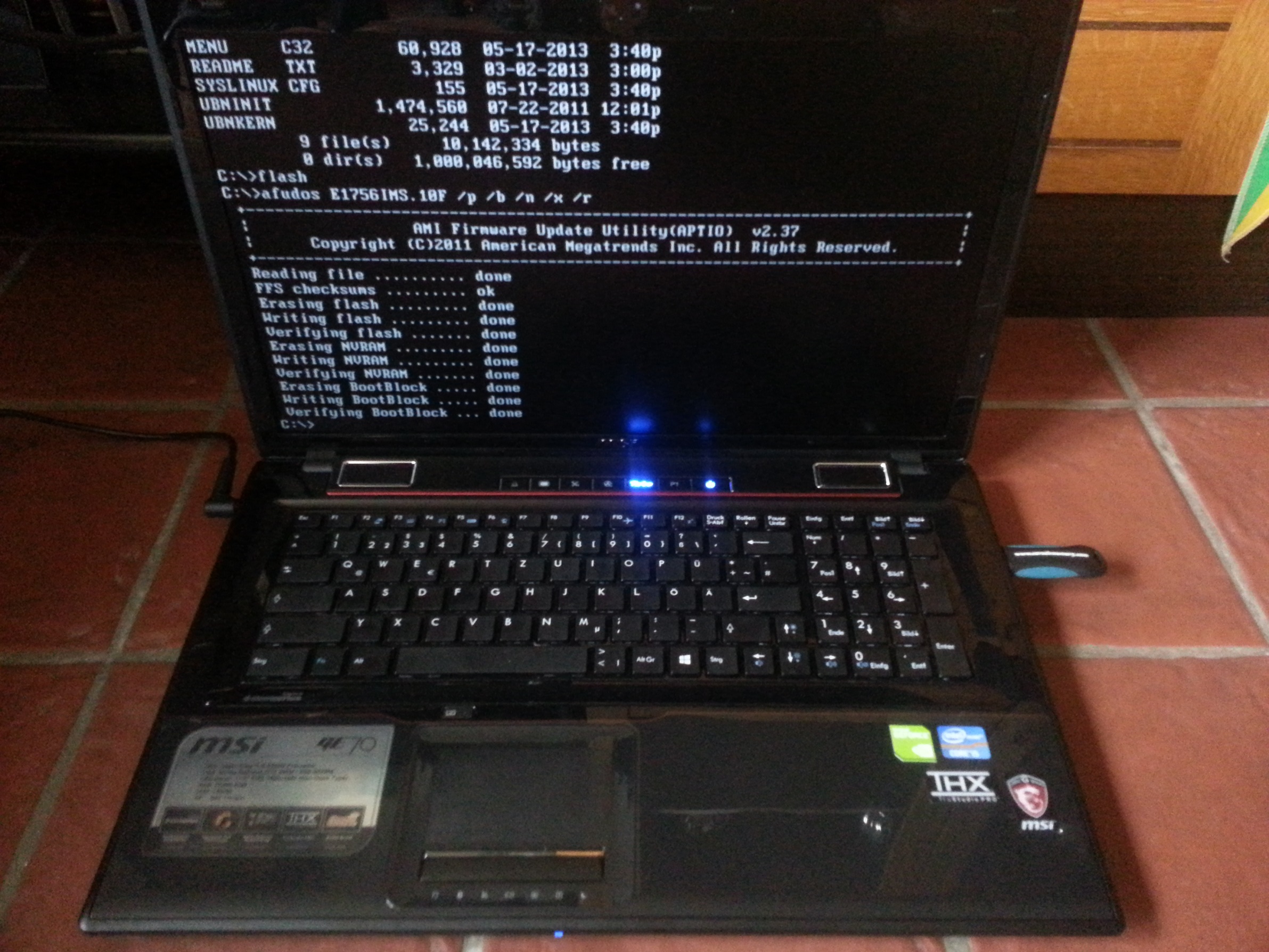

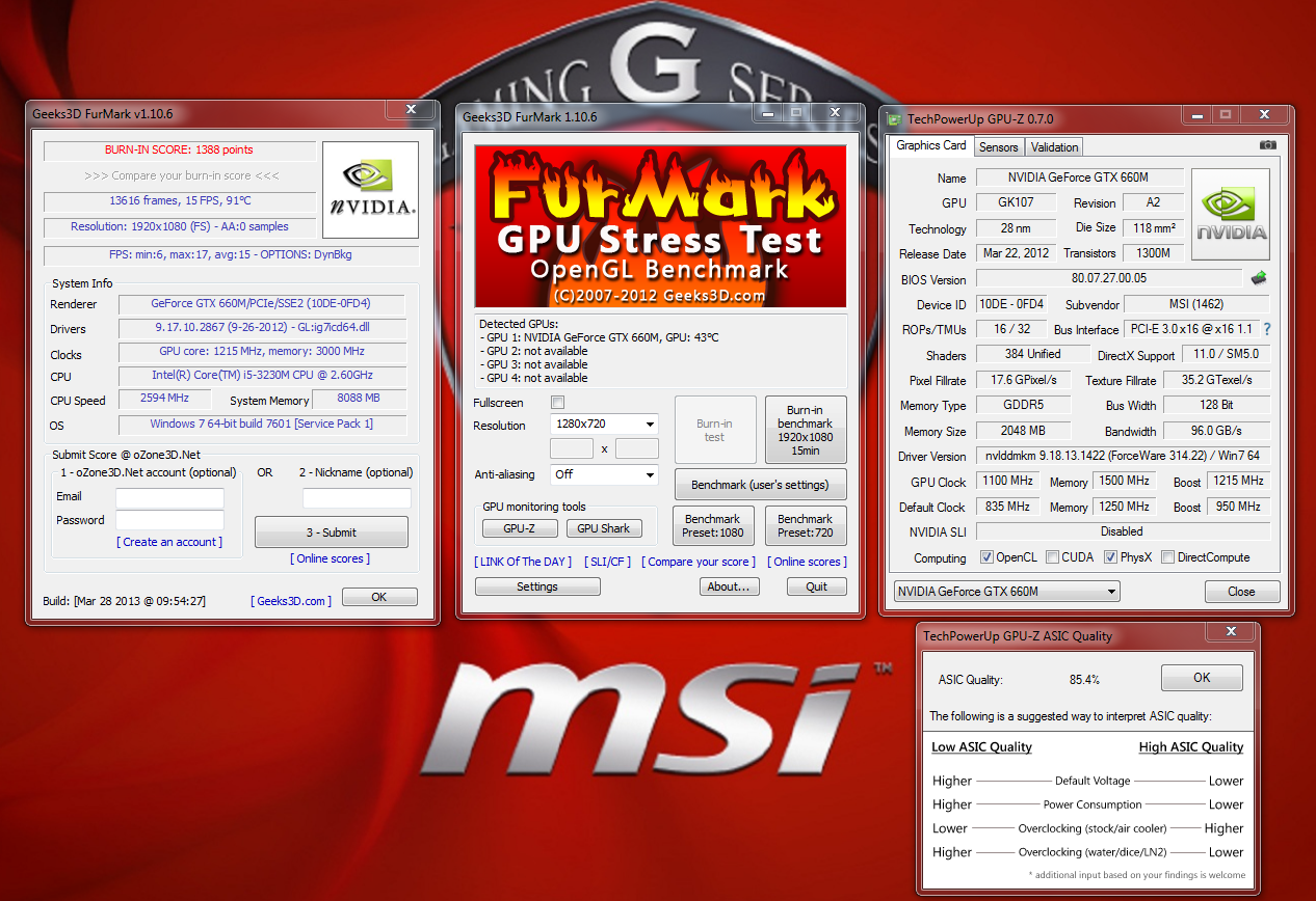

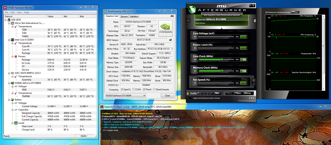

Username Posted May 17, 2013 Share Posted May 17, 2013 <!--[if gte mso 9]><xml> <o:OfficeDocumentSettings> <o:AllowPNG/> </o:OfficeDocumentSettings> </xml><![endif]--> GREAT - The Win7 Bios ( GE70_E1756IMS.10F_OC) works perfect !!! I used my 1GB Corsair USB2.0 Stick and followed the flashing instructions and had no problems with the < 512MB. Now my MSI-GE70 is unlocked for overclock !!! <!--[if gte mso 9]><xml> <o:OfficeDocumentSettings> <o:AllowPNG/> </o:OfficeDocumentSettings> </xml><![endif]--> Basic: GPU: 835MHz RAM: 1250MHz (2500MHz) Temperature: 89 C Stable Overclock: GPU: 1100MHz RAM: 1500 MHz (3000MHz) Temperature: 92 C (@93 C throtteling) I have already replaced the standard Thermal Compound with Arctic MX-4 thermal compound. Thanks again PERMA !!! Link to comment Share on other sites More sharing options...
ein972 Posted May 18, 2013 Share Posted May 18, 2013 Hello thank you very much for files but he(it) is lacking 514ocfix in the archive GE60_E16GAIMS.514_WIN8_OC.zip.Good day. Link to comment Share on other sites More sharing options...
James D Posted May 18, 2013 Share Posted May 18, 2013 @Username, do not OC Memory to 3000 especially if your temperature is 90C. 1st thing is that it gives as little as no difference when you OC it above 2500-2600MHz on our 650M-660M. And the 2-nd is that it has higher chance to die... and what profit? Use notebook cooler like Notepal U3. I reach 90 only using 1180/2500 EDIT: WOW!!! You have very good overclock up to 1215Mhz and it is stable after 5 minutes in Furmark? If you have FullHD maybe you try 1080p to test? Could you post your ASIC quality of your GPU? Use GPU-z for this. P.S. I used 2GB SD card in old USB card reader for flashing BIOS. I did it before and doing now. It never felt me. I believe there is no difference in what you are using. Looks like 660M has better chips. Link to comment Share on other sites More sharing options...
Username Posted May 18, 2013 Share Posted May 18, 2013 @Username, do not OC Memory to 3000 especially if your temperature is 90C. 1st thing is that it gives as little as no difference when you OC it above 2500-2600MHz on our 650M-660M. And the 2-nd is that it has higher chance to die... and what profit?Use notebook cooler like Notepal U3. I reach 90 only using 1180/2500 EDIT: WOW!!! You have very good overclock up to 1215Mhz and it is stable after 5 minutes in Furmark? If you have FullHD maybe you try 1080p to test? Could you post your ASIC quality of your GPU? Use GPU-z for this. P.S. I used 2GB SD card in old USB card reader for flashing BIOS. I did it before and doing now. It never felt me. I believe there is no difference in what you are using. Looks like 660M has better chips. Here is the screenshot from FurMark and GPU-Z with ASIC Quality. Burn-In 1920x1080 Furmark v1.10.6 Score 1388 @ 91 Celsius (GPU 1215MHz ; RAM 3000MHz) ASIC Quality via GPU-Z v.0.7.0: 85,4% The Ram feels like same Temperature to the touch if at standard 2500MHz or at high overclock 3000MHz. The bigger NVidia Card run the Ram up to 3100MHz standard. And yes, I also noticed that there is no noticeable Benchmark difference if I set standard setting or OC on Ram. Link to comment Share on other sites More sharing options...
James D Posted May 18, 2013 Share Posted May 18, 2013 Here you go. Your ASIC quality is much better than mine so you get better results.When you say bigger cards you mean desktop's? How can you be sure that they use the same memory chips? Link to comment Share on other sites More sharing options...
