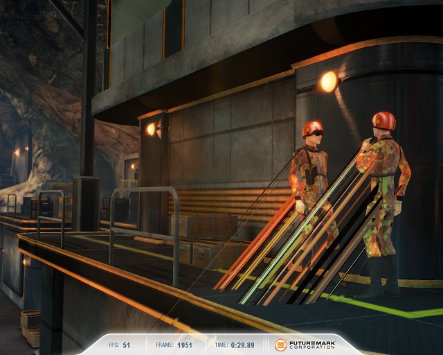

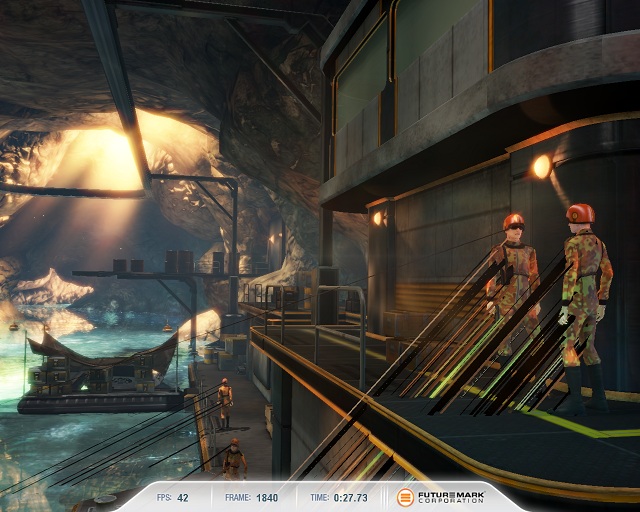

My Frankenstein seems to "work" both with the k5000m and 680m vbios. I installed Windows 7, Optimus enabled results in blue screen, but Optimus disabled allows me to install the 680m driver, without the Windows 8 error. Running 3dmark again.
  • Founder

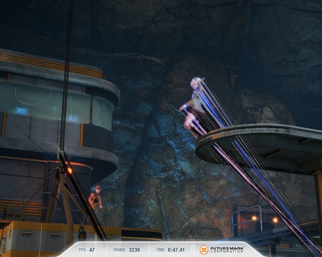

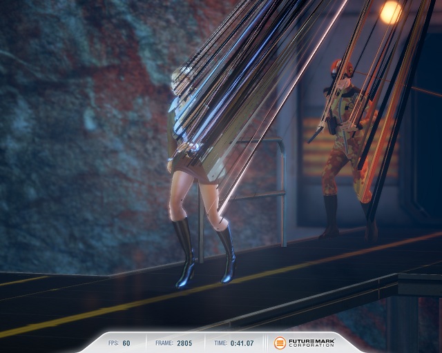

Try reducing the memory clock or alternatively using a higher voltage vbios from svl7 to see if that fixes the artifacting. If neither does the trick, try a different driver. If none of that works, you may have defective memory.
Alright, so I guess it is faulty memory. I tried a higher voltage vbios, messed with the memory clock in afterburner. I noticed that changing the frequency it to a certain number clock results in no more artifacts for about 1 second lol.
IS there any way to figure out exactly which ram chip is the problem? I am getting a refund from the seller, but I could offer a low ball amount of money and try to fix it up.
There is a service diagnostic software for nVidia cards, at least it was for older cards. I think the problem may be also a badly soldered GPU chip (board ID with device ID mismatch) or mechanical PCB failure. It would be easier to say something if you did good quality photos.
