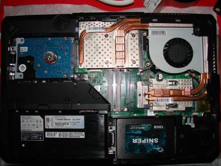

omega939 Posted January 18, 2013 Share Posted January 18, 2013 awesome, ill also take some pics when i redo it cause i asked another member how their gpu was adhered, and apparently im missing thermal pads on the ram modules. so maybe that will do some good as well. thanks you guys<!-- google_ad_section_end --> here's the pic of my gpu heatsink. I put some copper shims on the heatpipes and removed the thermal pads, cleaned it and put a thermal adhesive instead. The heat transfer is very effective and the back plate can be closed with the original screws. Still waiting for the next batch of copper shims i ordered. Quote Link to comment Share on other sites More sharing options...

Paul Kadoshnikov Posted January 22, 2013 Author Share Posted January 22, 2013 actually my heatsink did have all of the heat pads, i just didnt pay too much attention when i did it the first time. Those are the copper shims, that was my attempt after i soldered them together, it didnt work too well so i went back to a single layer shim Quote Link to comment Share on other sites More sharing options...
