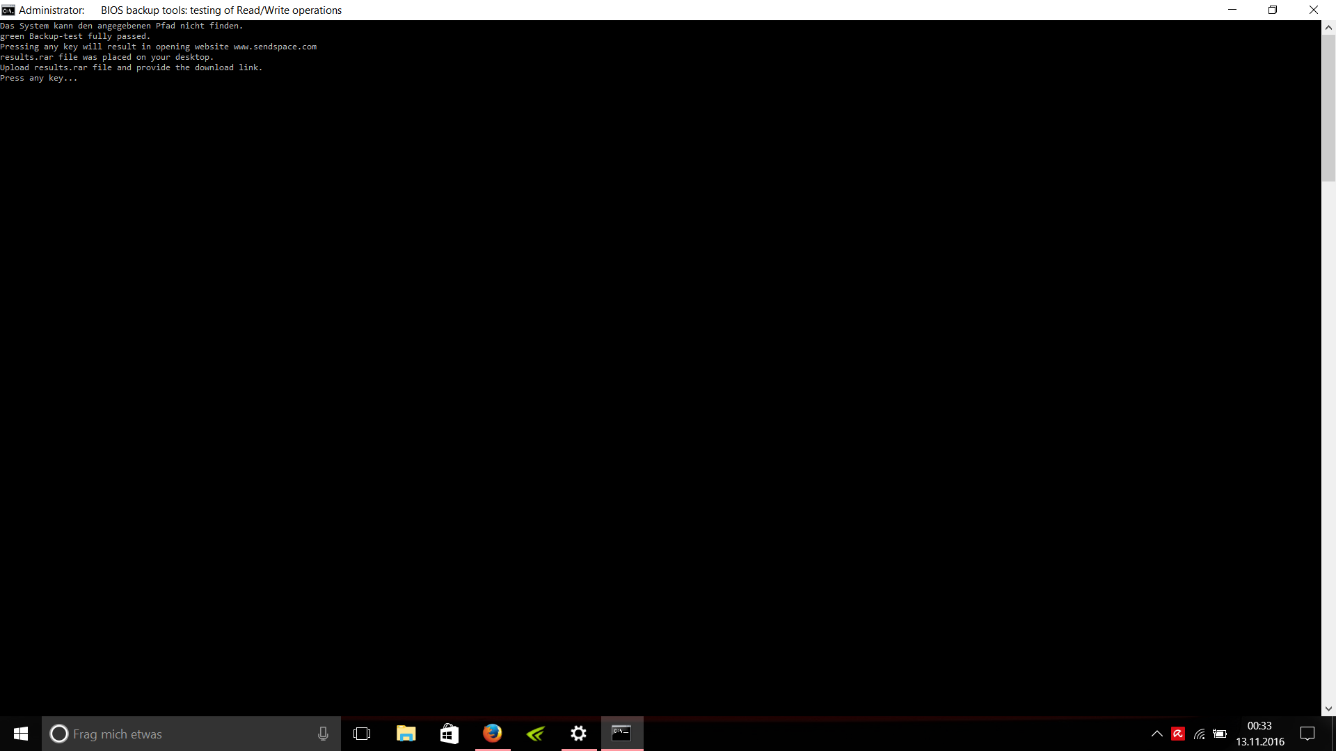

  • Bios Modder
1 minute ago, BoernexX said:
Yes thats the way I have done it and at the end the program says they cant find the path but also says the results.rar files was placed on your desktop but there is no file
Post here screenshot with error.
So I have deactiveted avira, windows 10 firewall, and smart screen from windows 10. I unpacked the tool directly too the desktop and started the tool as admin and the same window at the end :( Do you know another tool for reading out bios?
Edited by BoernexX
  • Bios Modder
You can try use this backup tool:  https://www.sendspace.com/file/05zedz
And this:  https://www.sendspace.com/file/n5jva6
or
Edited by Klem
  • Bios Modder
13 minutes ago, BoernexX said:
Is it possible to send a copy of my installed bios 3.03 version to you from my bios folder? Because no tool is working on my y50-70 no folders with results
Download this archive:  https://www.sendspace.com/file/d9bmu8
Unpack it directly on the root of drive C:
Run Command prompt as Administrator and execute this commands:
cd  \
cd  Backup
fptw64   -d   backup.bin   -bios
Done. The file backup.bin will be created.
