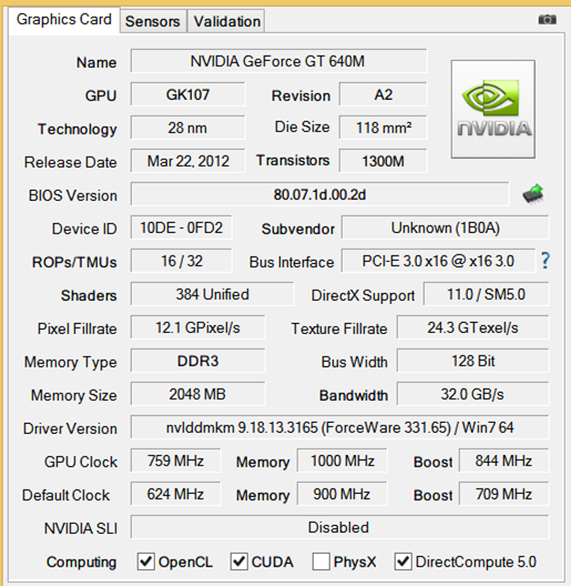

// okay managed to create same bios with vbios modded and unlocked bios settings as Spartanox.
Its Bios 1.13 , so latest before Ver. 2. Bioses.
Vbios is from GT650M so Clocks are bit higher. TDP Base Clock is 900 , Memory 1100 , Boost 1110,5 MHz.
Unlocked OC +600MHz
Temps are bit higher so i was searchin for a solution and found an simple exe called fancontroller.exe which lets spin my fan @ 100% :)
so my idle temp is 32 degrees celsius , and max temp is 85 .

unfortunately I sold the laptop so long ago, now seeing inside my dropboz I found a copy of the bios I had created. Obviously this bios is only compatible for those with non-UEFI version and there is the Advanced Menu with vbios Mod 640M @ 650M with operating boost and OC to + 405MHZ. I put the record on 3dmark 11 with 3060P  way back in 2014.
If anyone is still in search of my Bios 1.13 MOD here is the link to download it:
https://www.dropbox.com/s/4qghsjfoxdiegj3/[Spartanox] Bios 1.13 Logo ACER i7 Nvidia - Mod VGA 640M (boost table %40650M) 725- 810 MHz Core %2B Adavenced %26 Power Menu.rar?dl=0
