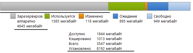

Ilya Posted January 20, 2013 Share Posted January 20, 2013 Hi Advice please: 1. Where is the CMOS battery is a GX60? 2. Can I solve the problem with RAM unlocked BIOS flashing (the problem with RAM: a total of 8 GB, and 3.46 is available, the rest of the hardware are reserved 4.45 GB; problem on any windows and Linux x64)? 3. Not there be a problem with the BIOS firmware unlocked? I have one such was: Thanks for the answers! Quote Link to comment Share on other sites More sharing options...

Xonar Posted January 20, 2013 Author Share Posted January 20, 2013 HiAdvice please:1. Where is the CMOS battery is a GX60?2. Can I solve the problem with RAM unlocked BIOS flashing (the problem with RAM: a total of 8 GB, and 3.46 is available, the rest of the hardware are reserved 4.45 GB; problem on any windows and Linux x64)?3. Not there be a problem with the BIOS firmware unlocked? I have one such was: [ATTACH=CONFIG]5799[/ATTACH]Thanks for the answers!1. CMOS should be in the same location as the pictures on the second post.2. RAM is reserved by the Operating System for caching purposes. It's to get better performance, this is normal with Windows 7, 8.3. No clue, you could add the -x parameter to the .bat file to force flash, but it's your risk. Others have flashed the BIOS just fine without it. Quote Link to comment Share on other sites More sharing options...
Ilya Posted January 20, 2013 Share Posted January 20, 2013 2 . No. It isn't normal! AIDA64 sees 2*4Gb, but works (for the unclear reasons) by single channel! From here RAM productivity in Windows 5.9, instead of 7.3-7.4. Why that 1 RAM doesn't want to work (((I think it a problem in Bios! (This RAM is running on another laptop in dual channel mode) Friends have same laptops with 8Gb memory! Under hardware needs only 500 Mb are allocated, and at me 4.5 Gb are reserved is hardware) Quote Link to comment Share on other sites More sharing options...

Xonar Posted January 20, 2013 Author Share Posted January 20, 2013 2 . No. It isn't normal! AIDA64 sees 2*4Gb, but works (for the unclear reasons) by single channel! From here RAM productivity in Windows 5.9, instead of 7.3-7.4. Why that 1 RAM doesn't want to work (((I think it a problem in Bios! (This RAM is running on another laptop in dual channel mode)Friends have same laptops with 8Gb memory! Under hardware needs only 500 Mb are allocated, and at me 4.5 Gb are reserved is hardware)[ATTACH=CONFIG]5800[/ATTACH]Have you ever reformatted before? It could be some software you are using.Are you using integrated graphics? I bet that will be reserving some RAM for sure. But 4.6GB seems kinda high... Quote Link to comment Share on other sites More sharing options...
Ilya Posted January 20, 2013 Share Posted January 20, 2013 Integrated graphics card must take 520 MB of RAM))) I think the problem with the BIOS or chipset (( Quote Link to comment Share on other sites More sharing options...
