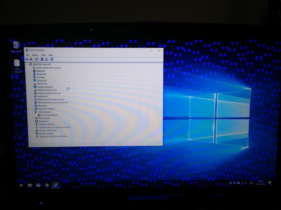

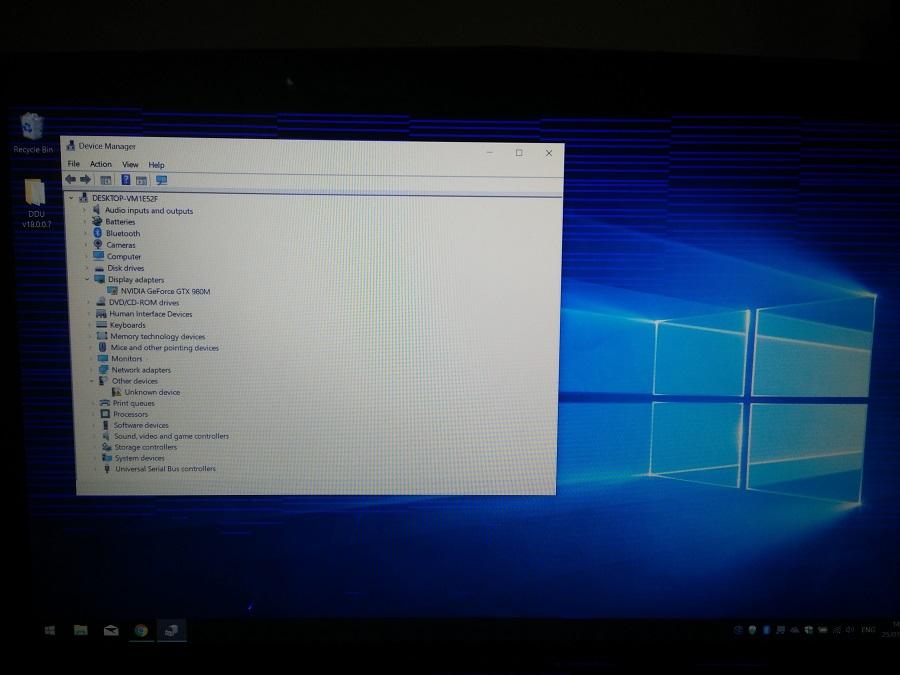

Update 3 Well after a lot of messing around, re seating, re pasting and cleaning (I'm not convinced the card was new like stated when I bought it), I managed to boot in PEG. However I get blue horizontal lines across the screen.
I downloaded the latest Drivers via Windows 10 update and the lines vanish for a minute. They are then replaced with blue squares and the Laptop gets stuck in a boot cycle until I go into Safe Mode and remove them with DDU. The other thing that can happen is the card disables itself in Device Manager (Code 43).

Update 4 Well it's official. All these problems have been caused by a faulty card :logik:
Tried it in another machine and had the exact same problems. Tried flashing the official Dell/Alienware & Clevo VBIOS from Techpowerupwith no improvement. Card is now being returned.
