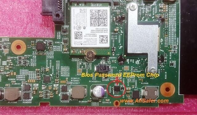

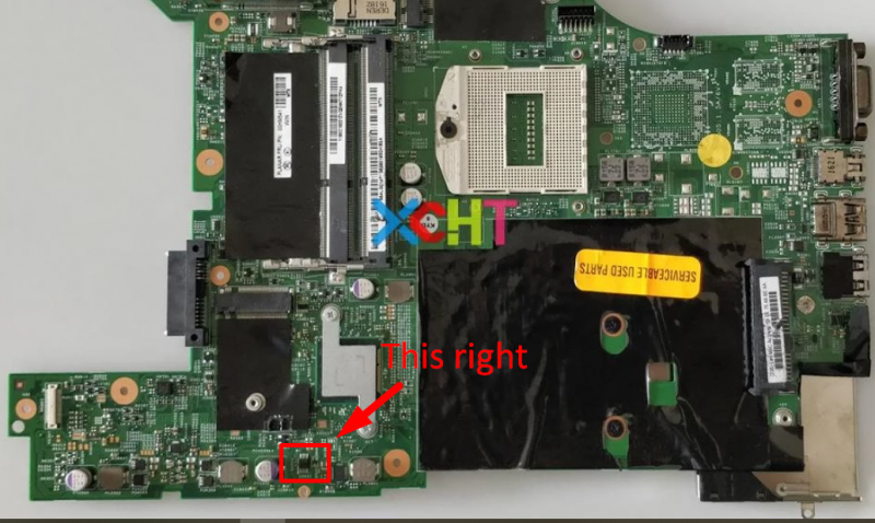

hungthangitv Posted August 17, 2021 Share Posted August 17, 2021 On 7/24/2021 at 10:00 PM, Klem said: Hi! Ok, your unlocked bios done. Check PM. Hi @Klem, Please show me how to find eeprom on main Lenovo L440. Thank you very much! Quote Link to comment Share on other sites More sharing options...
Bios Modder Klem Posted August 17, 2021 Author Bios Modder Share Posted August 17, 2021 6 minutes ago, hungthangitv said: Hi @Klem, Please show me how to find eeprom on main Lenovo L440. Thank you very much! Hi! Quote Link to comment Share on other sites More sharing options...
hungthangitv Posted August 17, 2021 Share Posted August 17, 2021 Very thank@Klem, But why do they share this on other websites? Quote Link to comment Share on other sites More sharing options...
Bios Modder Klem Posted August 17, 2021 Author Bios Modder Share Posted August 17, 2021 17 minutes ago, hungthangitv said: But why do they share this on other websites? Because on your photo Bios Password EEPROM Chip. It's not a BIOS chip. Quote Link to comment Share on other sites More sharing options...
hungthangitv Posted August 17, 2021 Share Posted August 17, 2021 3 minutes ago, Klem said: Because on your photo Bios Password EEPROM Chip. It's not a BIOS chip. So my machine is set with Bios Master password, I have to use limited User mode and it is hidden a lot. What do I have to do to remove the password or use the hidden functions? Quote Link to comment Share on other sites More sharing options...
Bios Modder Klem Posted August 17, 2021 Author Bios Modder Share Posted August 17, 2021 1 minute ago, hungthangitv said: So my machine is set with Bios Master password, Your laptop won't start, won't boot and ask you for your password? Quote Link to comment Share on other sites More sharing options...
