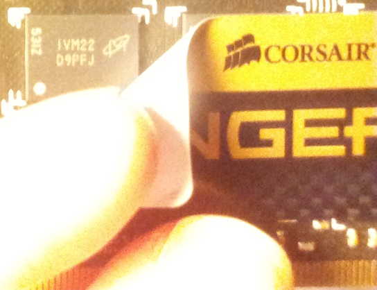

[offtopic] hey nice ram what do you think of your new corsair vengeance 1866mhz? I am picking some up because of the 1866@10-10-10-27 can i ask how much and where you bought it from. I found 8gb dual channel kit of them is $92 on amazon. Also i read the heatsink is not a metal heatsink but a simple sticker unlike hyperx ram... do you know if this is true?

The Corsair Vengeance 1866 are beast and can be flashed to CL9 thanks to Thaiphoon Burner. No heatsinks though, just stickers.
[ATTACH=CONFIG]3641[/ATTACH]

Thank you and please do i have some in m18x guides in my signature but am on phone so its not a easy to add... yes we need pics of flex location... actually both locations are very important i think you know i mean the one under "perfromance options" heading with flex and mem settings only in it that one. Thanks geocake do you also have those corsair? I am shocked flash ram to cl9 thats sweet can you make a guide pretty please :) SSG is getting vengeance 1600mhz can he flash a lower latency :) we both would appreciate it. :) thanks Geocake you da man :)
