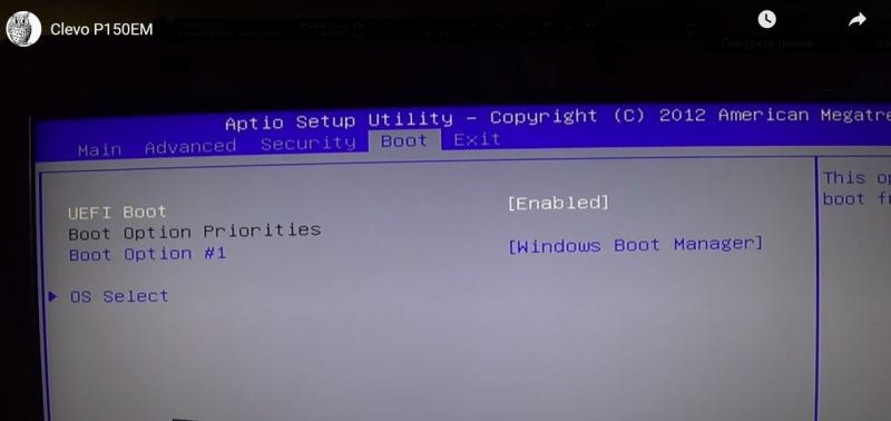

On 9/22/2021 at 10:17 AM, Klem said:
In bios setup menu:  page "Boot" -> UEFI Boot -> Enabled or Disabled.
I don't have that option. But I tried I different file with clearer instructions but when it said press any key to continue its been stuck on this screen for a long time. https://linksharing.samsungcloud.com/nk1utszekiPD
