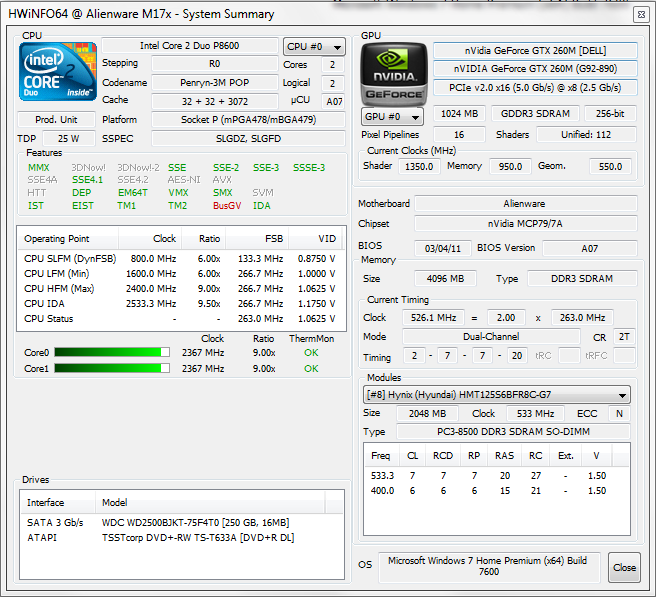

unreal25 Posted February 10, 2012 Share Posted February 10, 2012 Hey, welcome to T|I!Few questions:- Did you try latest drivers from the Dell website?- What are the GPU(s) you have?- Did you make sure you're on High Performance / Balanced and not on some power savings power plan?- Can you show us the for example HWInfo64 screenshot (or whatever where you can see GPU clocks) when you run a game?Thanks! 3 Link to comment Share on other sites More sharing options...

he_iz_legend Posted February 11, 2012 Author Share Posted February 11, 2012 Here is the HWinfo Link to comment Share on other sites More sharing options...

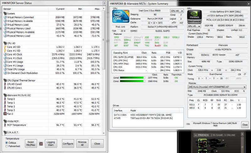

mw86 Posted February 11, 2012 Share Posted February 11, 2012 (edited) I couldn't find those options in my Bios. What am I missing?we need to see the sensors tab to see how things were running do as normal in gaming and have hwinfo going then take a pic of the sensors to show max temps speeds and much more... The settings for eist or enhanced speed step... Or just speed step is what to look for if you cant disable it this wont work. If eist and cstates can both be disabled by the throttle stop check box and they arent greyed out that will suffice to. If no such option in bios it isnt going to work. I only know dual ida works on your cpu but not sure if its usable for the Alienware.Download throttle stop here Downloads | Tech|InfernoBut i would check the temps gaming with hwinfo sensors showingBasic hwinfo guidehttp://forum.techinferno.com/t%7Ci-member-product-reviews/1416-hwinfo.html#post17375 Edited February 11, 2012 by mw86 Link to comment Share on other sites More sharing options...
he_iz_legend Posted February 11, 2012 Author Share Posted February 11, 2012 Updated mwinfo Link to comment Share on other sites More sharing options...
mw86 Posted February 11, 2012 Share Posted February 11, 2012 cool temps are just fine accross the board i suggest trying Unreal's suggestion of driver version... Perhaps try latest beta direct from Nvidia for mobile? If not the Dell official one. The dual ida is like you max speed shown was just about to that 2.53ghz... Just under 2.5 and on mostly one core... With the trick it forces both to 2.53 and isnt allowed to drop... So you would have higher temps cpu... But temps now are fine. Perhaps another Tech Inferno M17x R1 could elaborate if the bios has the proper options to enable dual IDA mode. Link to comment Share on other sites More sharing options...
