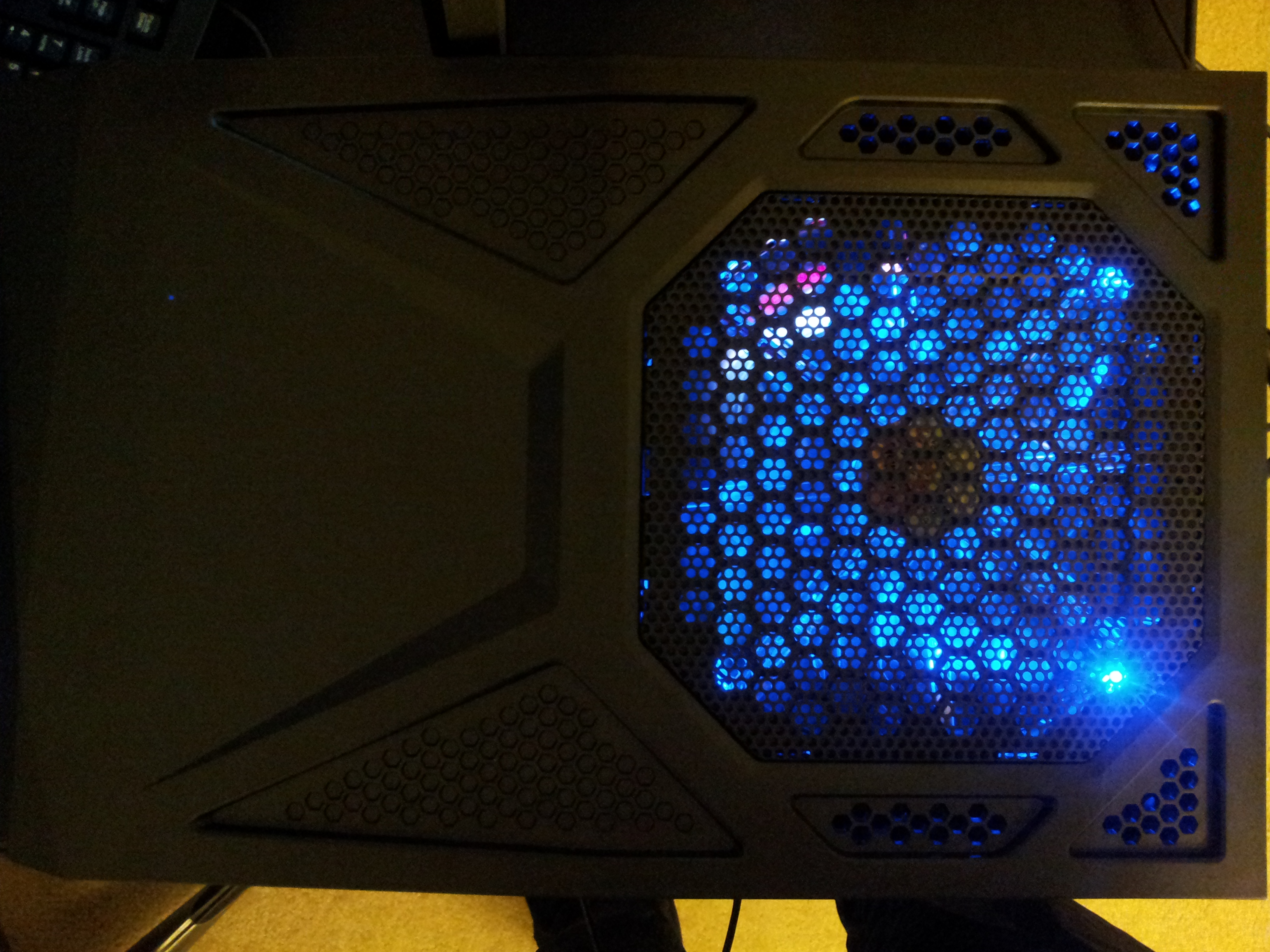

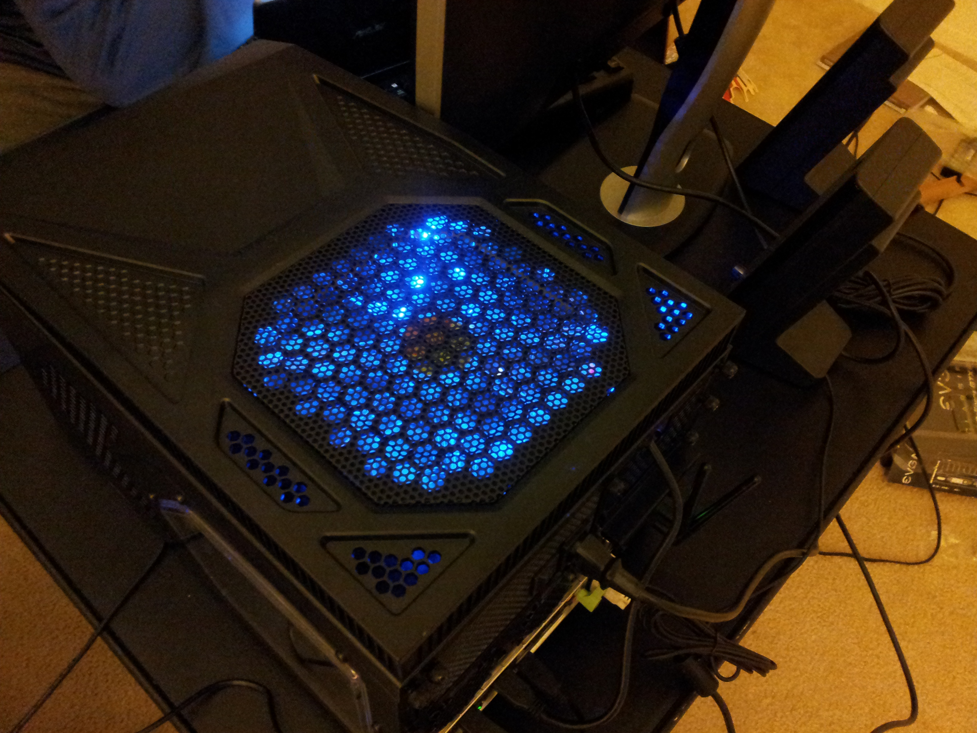

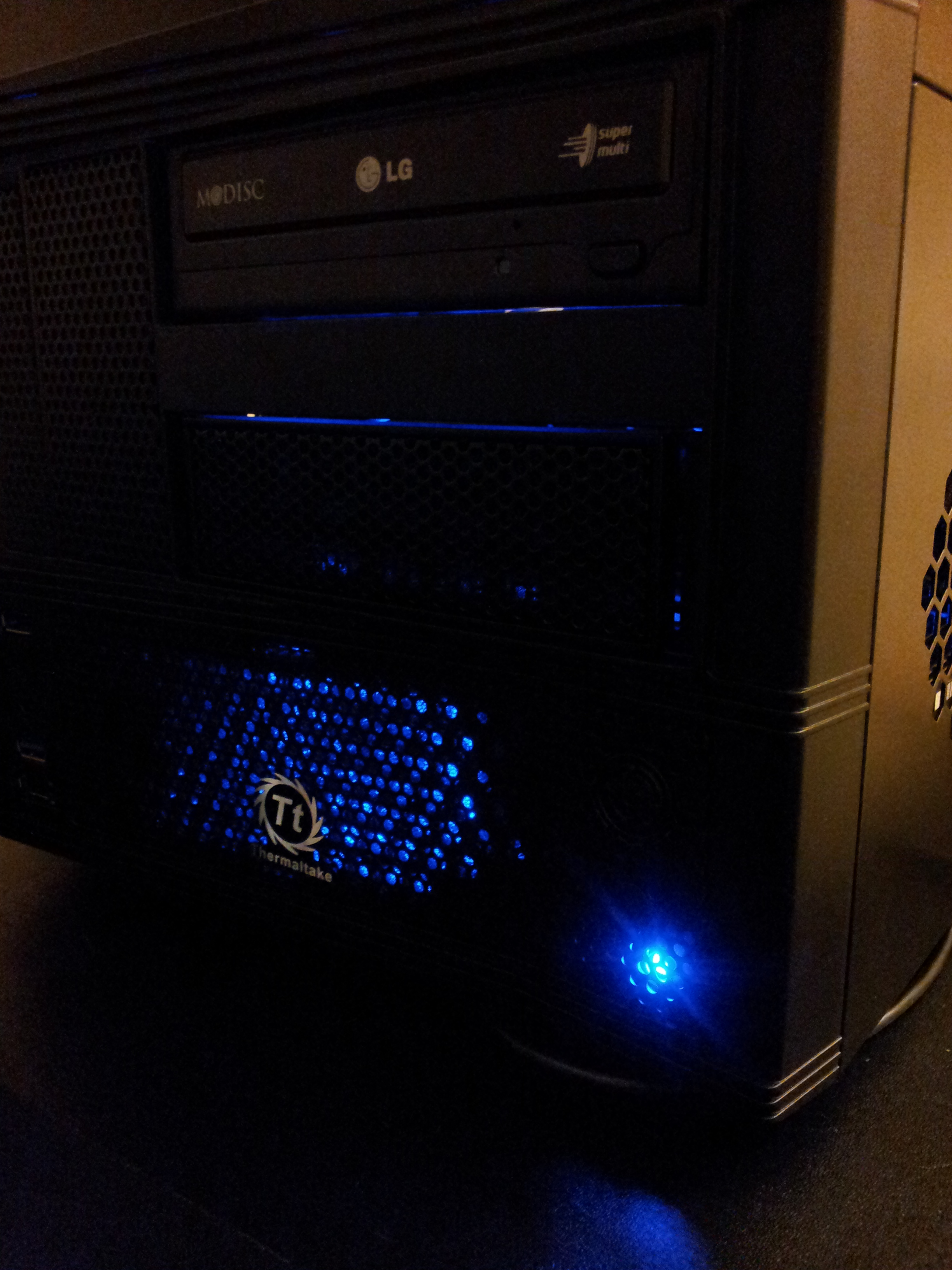

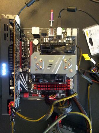

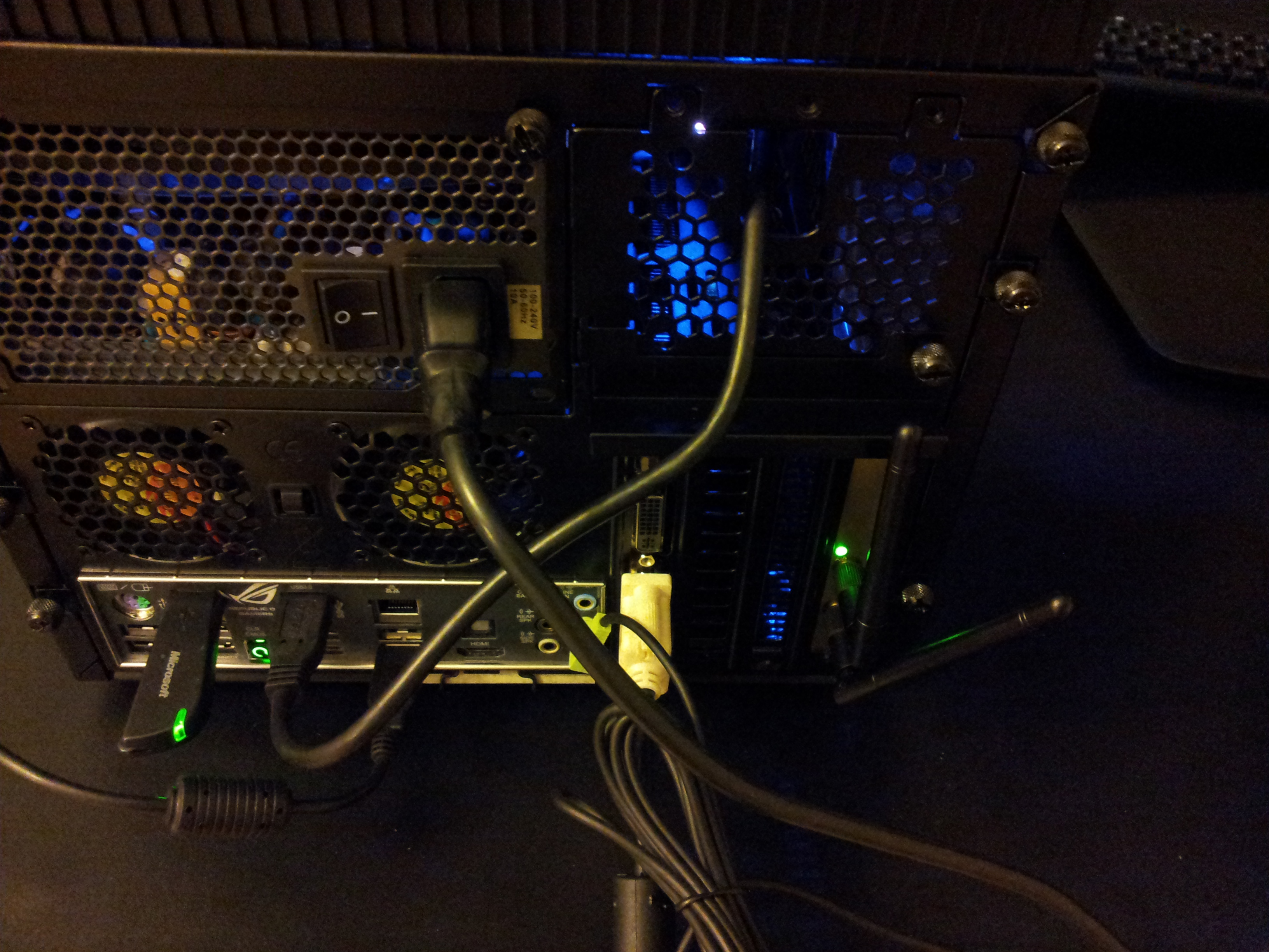

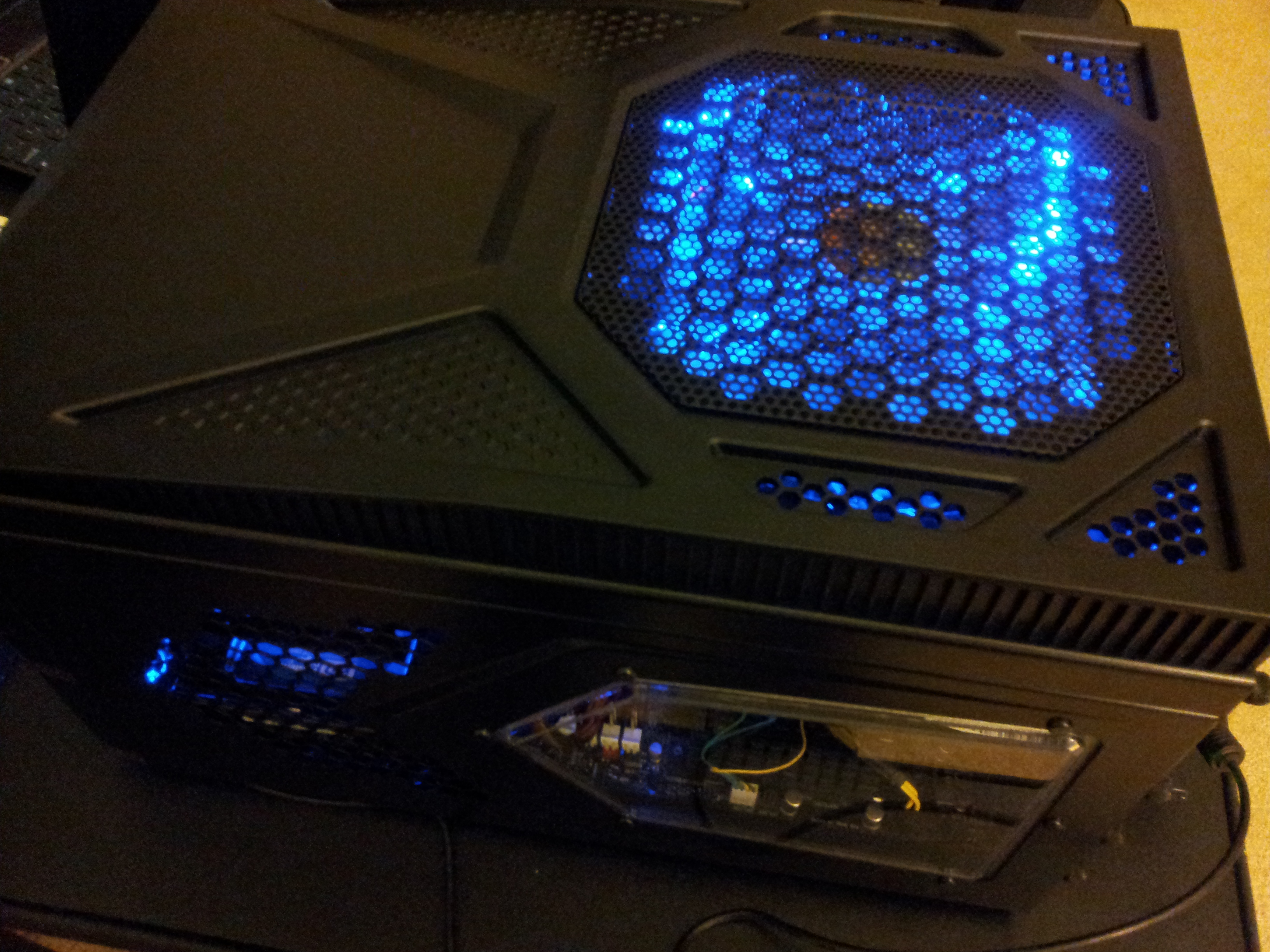

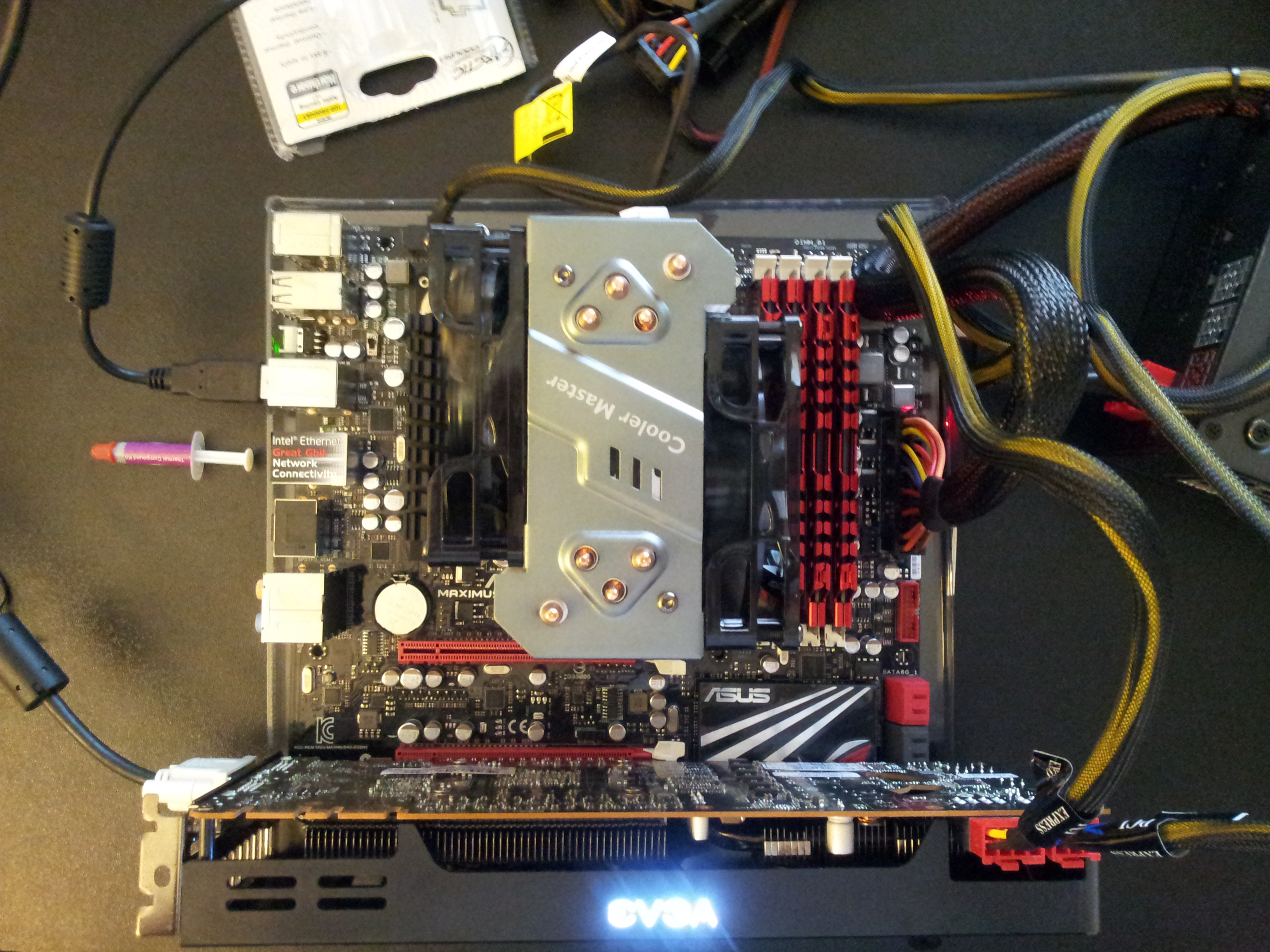

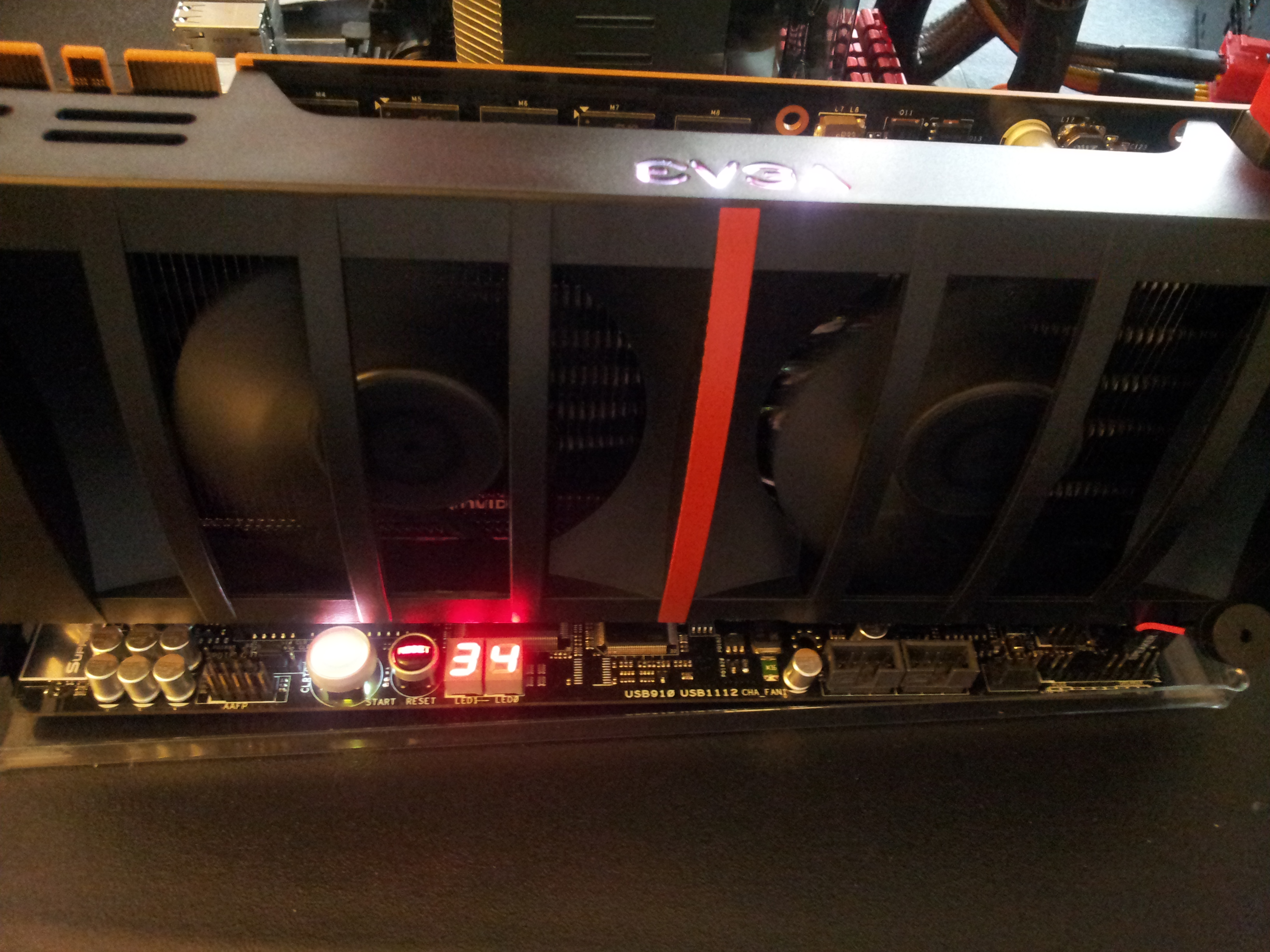

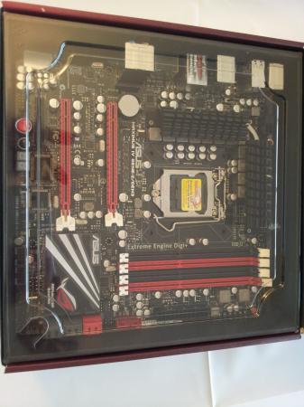

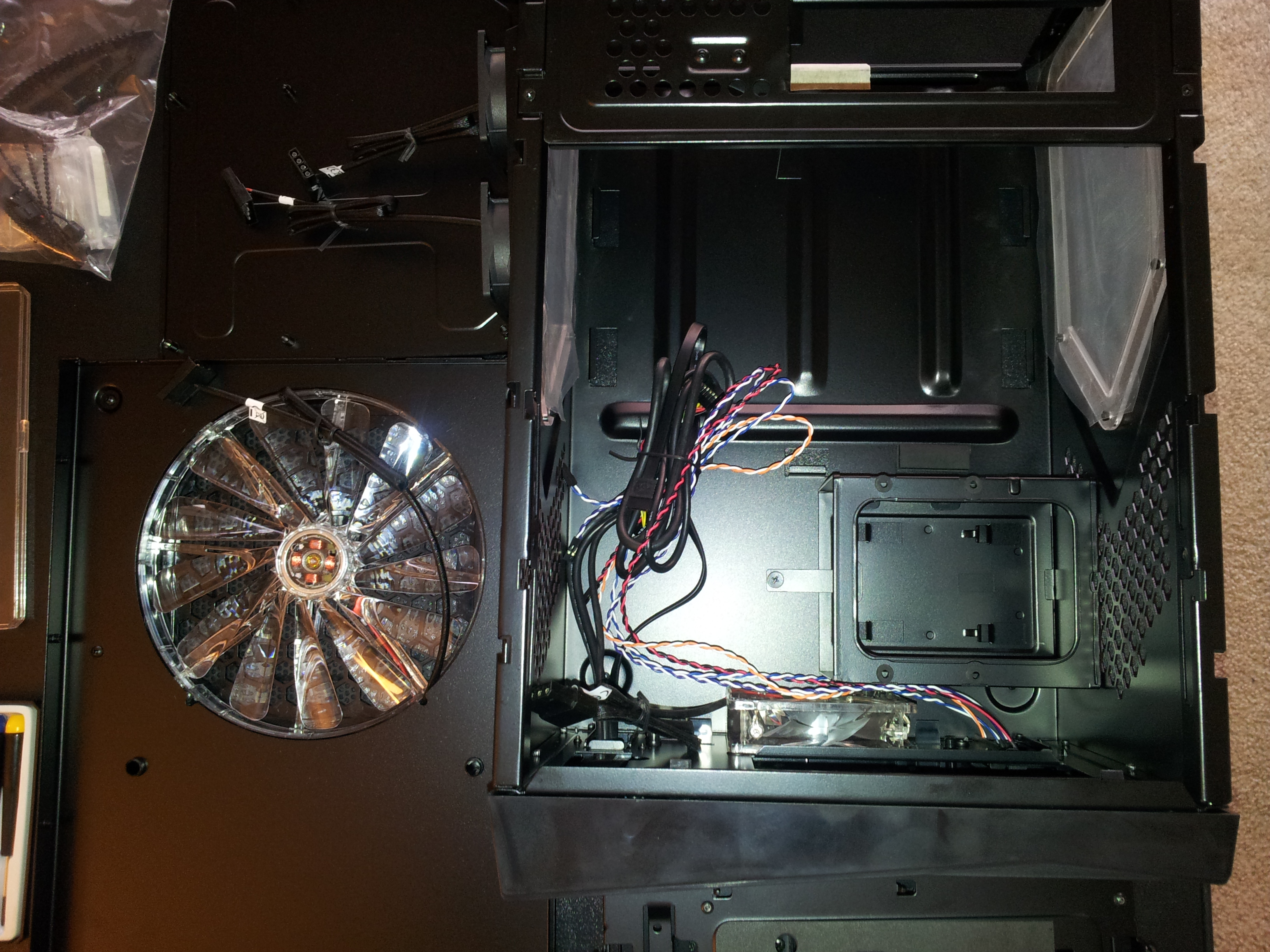

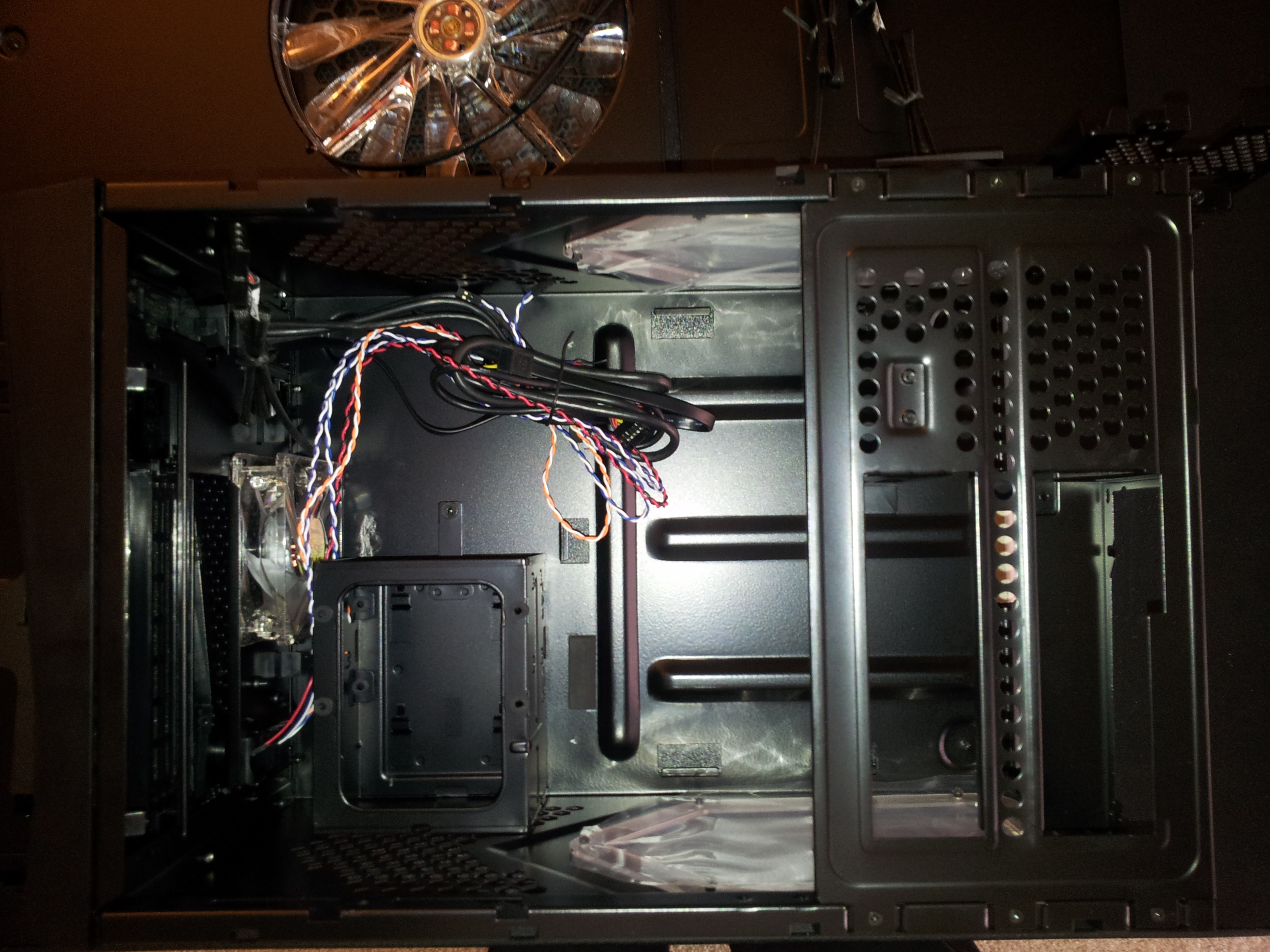

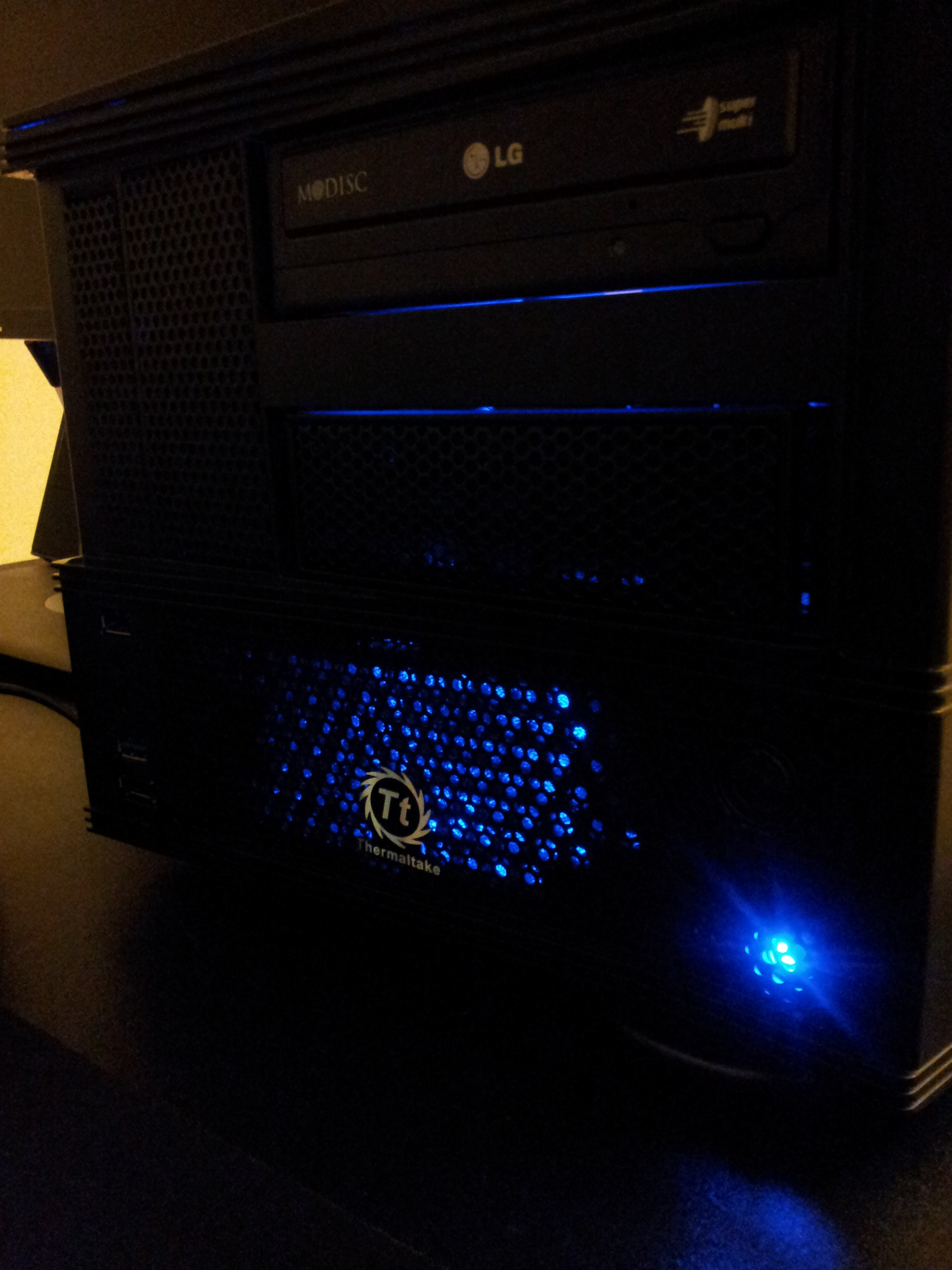

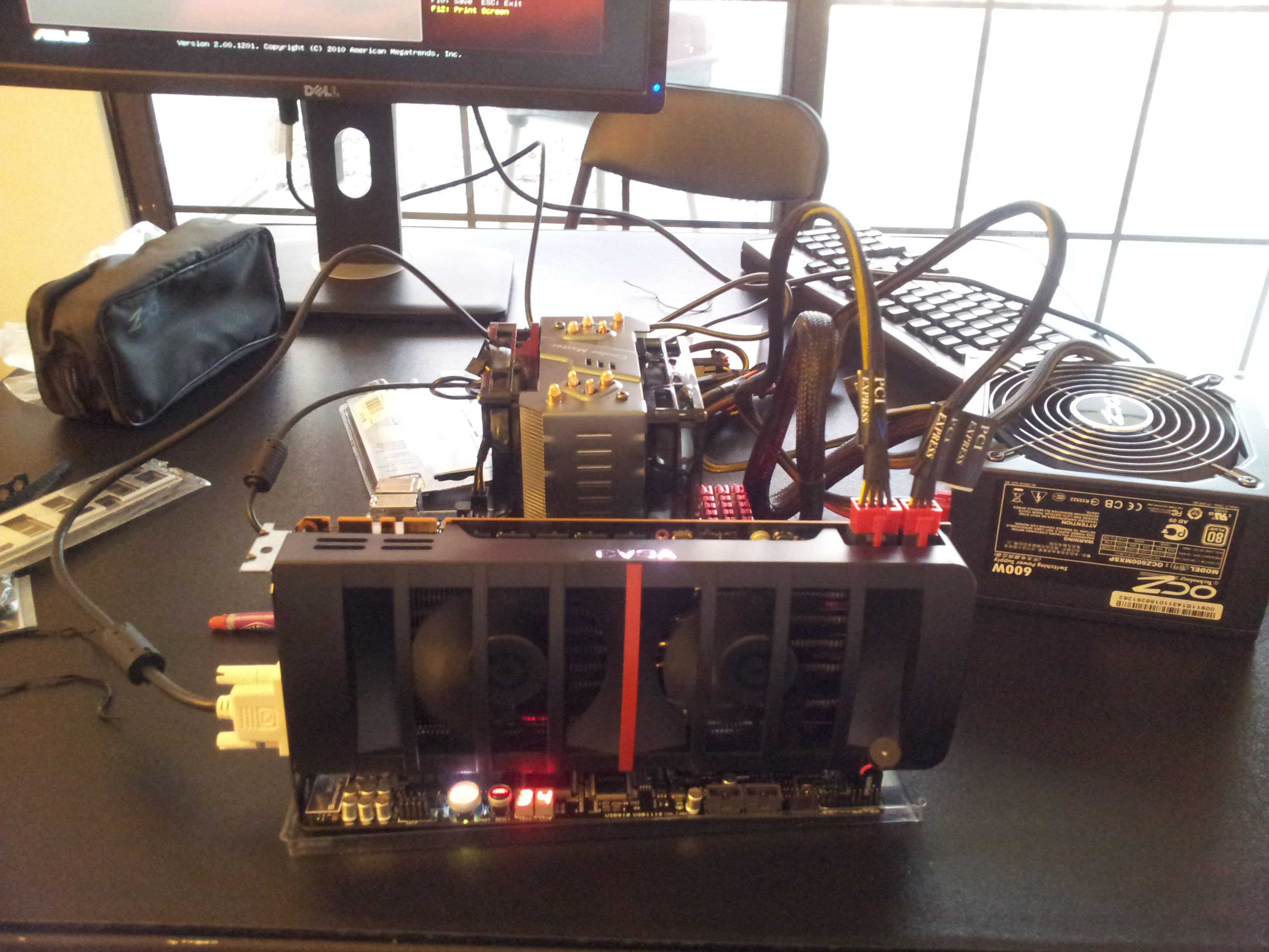

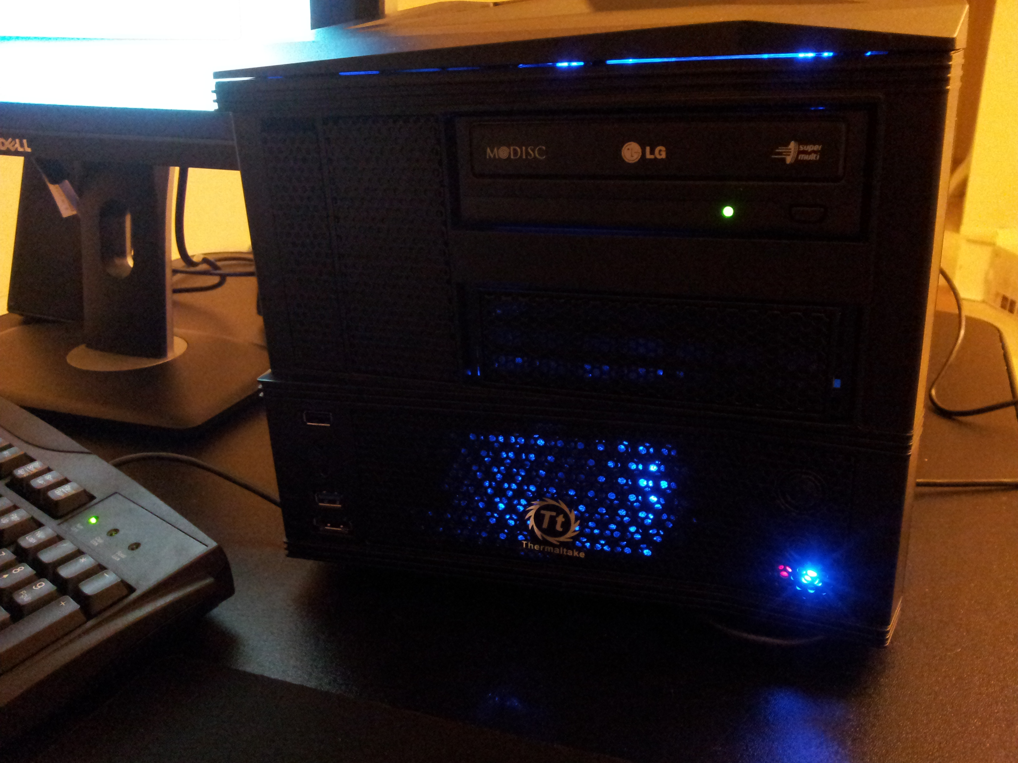

Update: Build is complete! Here's some photos we took today, if time permits I might do a quick review of the case and motherboard but we'll see. For now here's the shots:

Nice build Brian :friendly_wink: Seems you had no problems with the components to fit into the case. Good work! :excitement:
What temperatures did you reach (GPU/CPU)? Will you repaste the GPU?

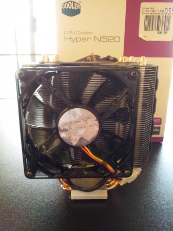

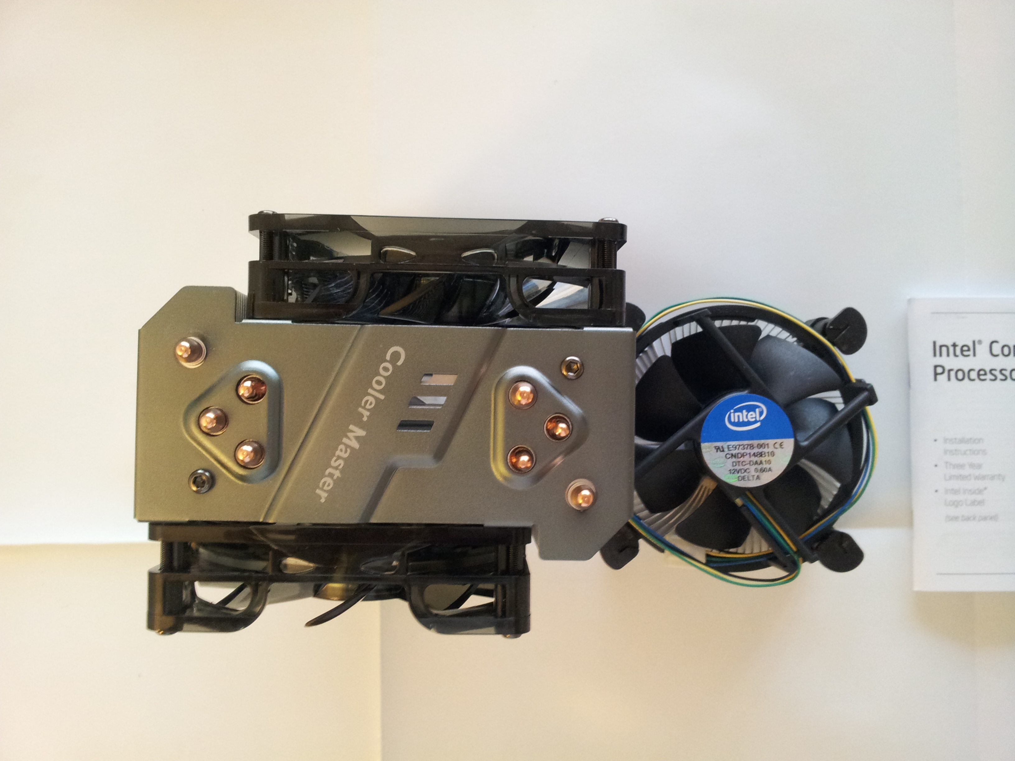

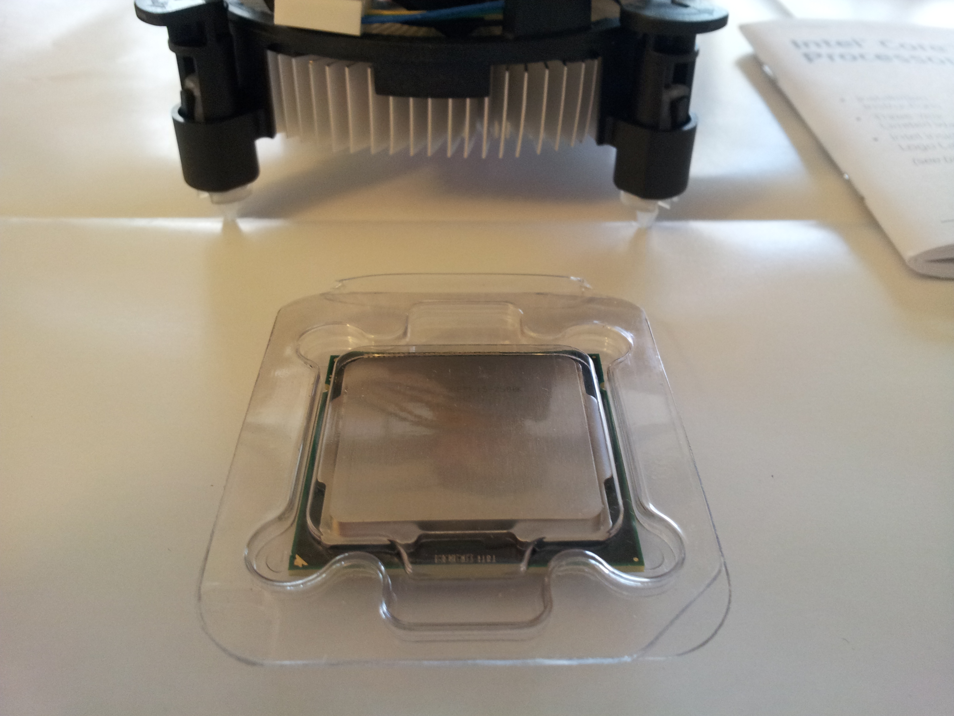

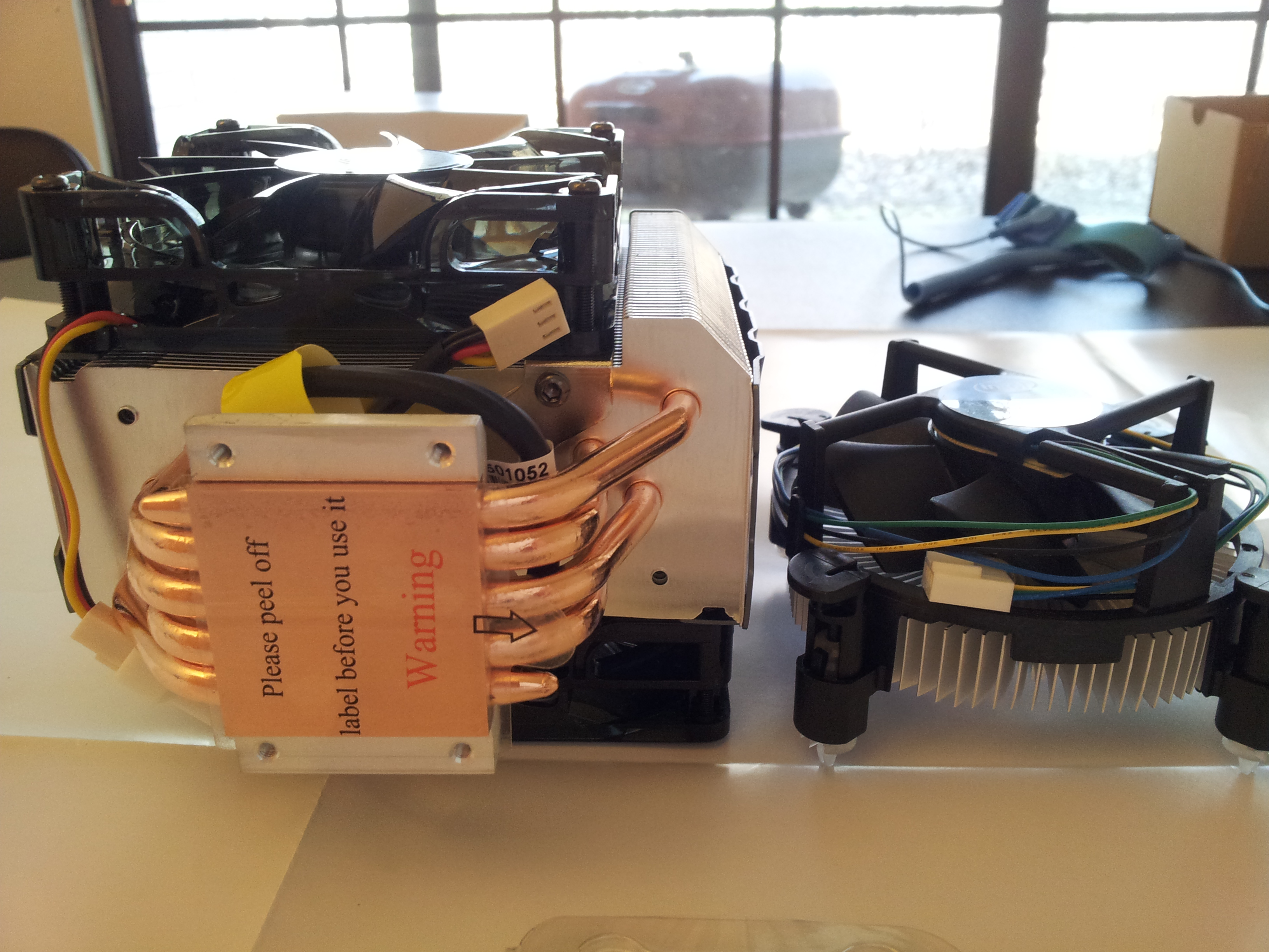

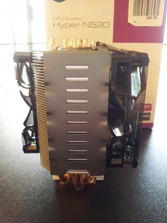

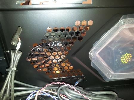

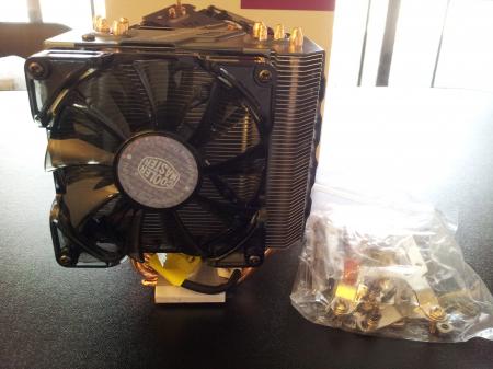

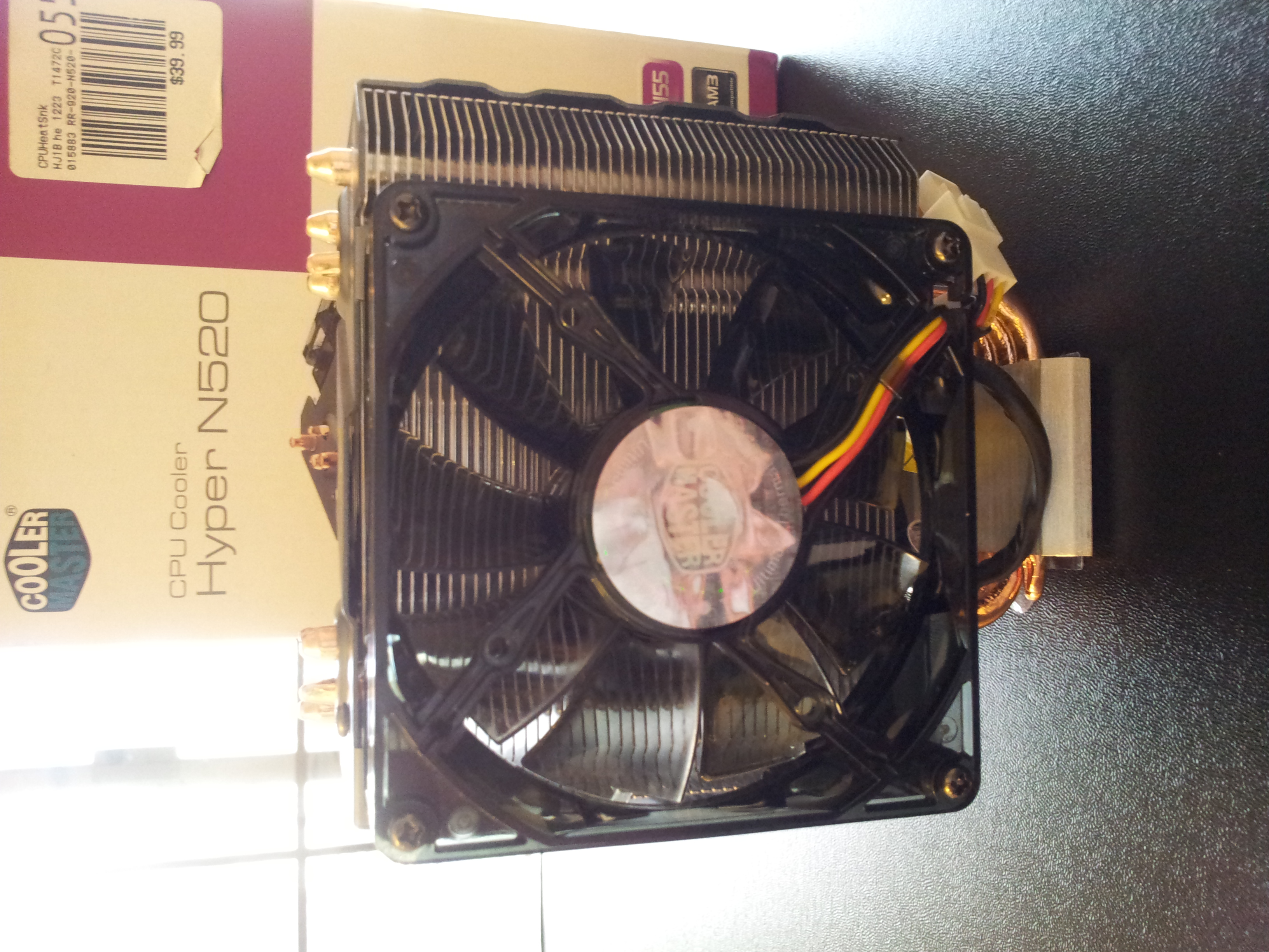

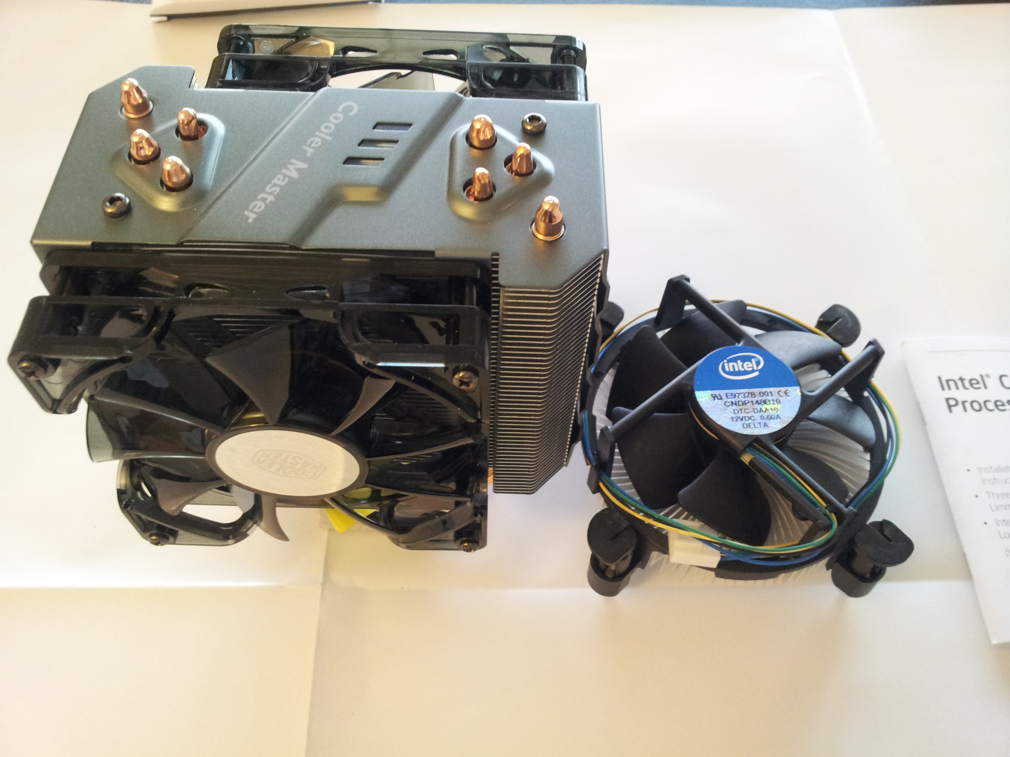

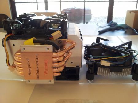

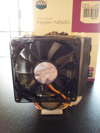

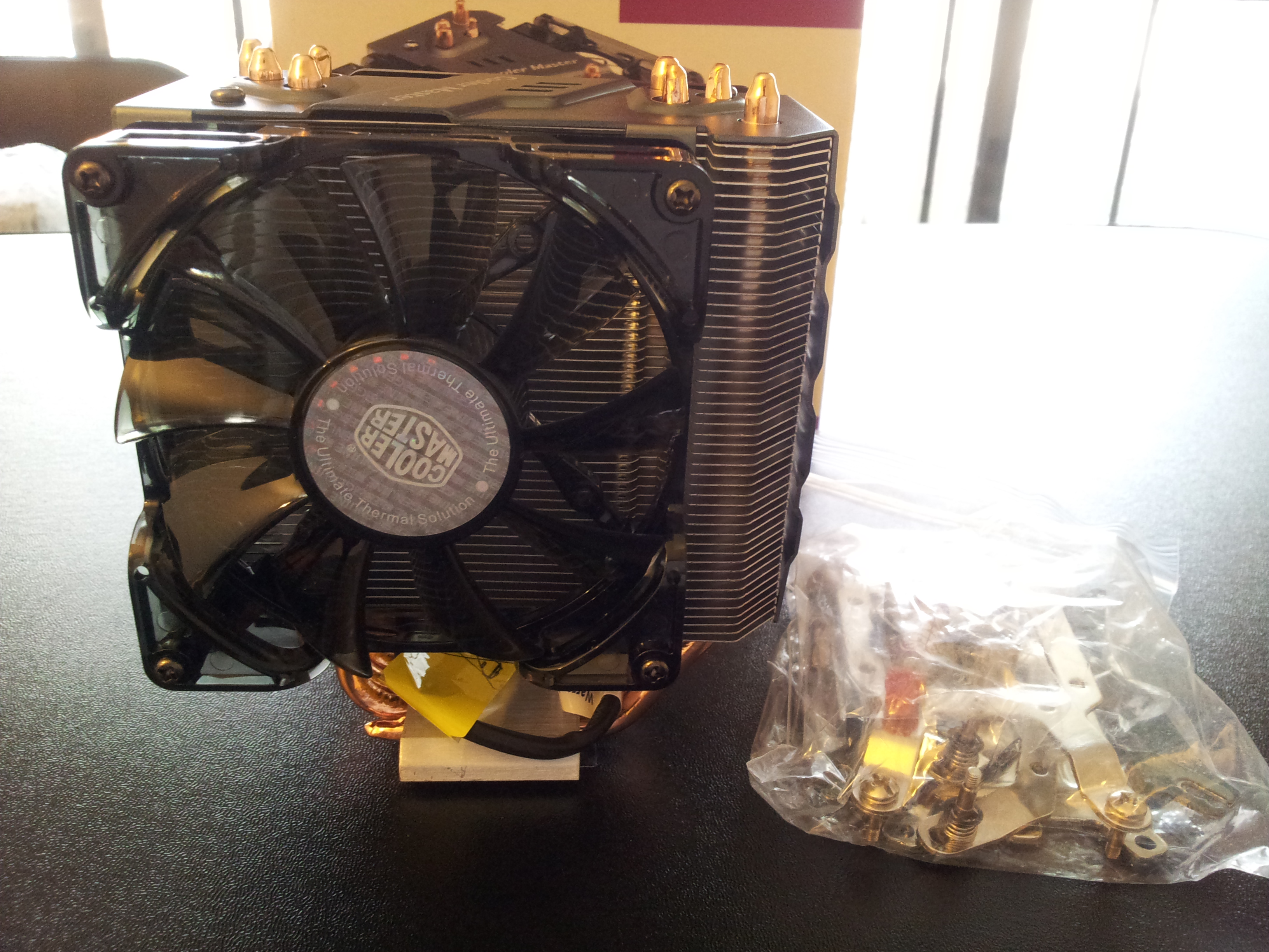

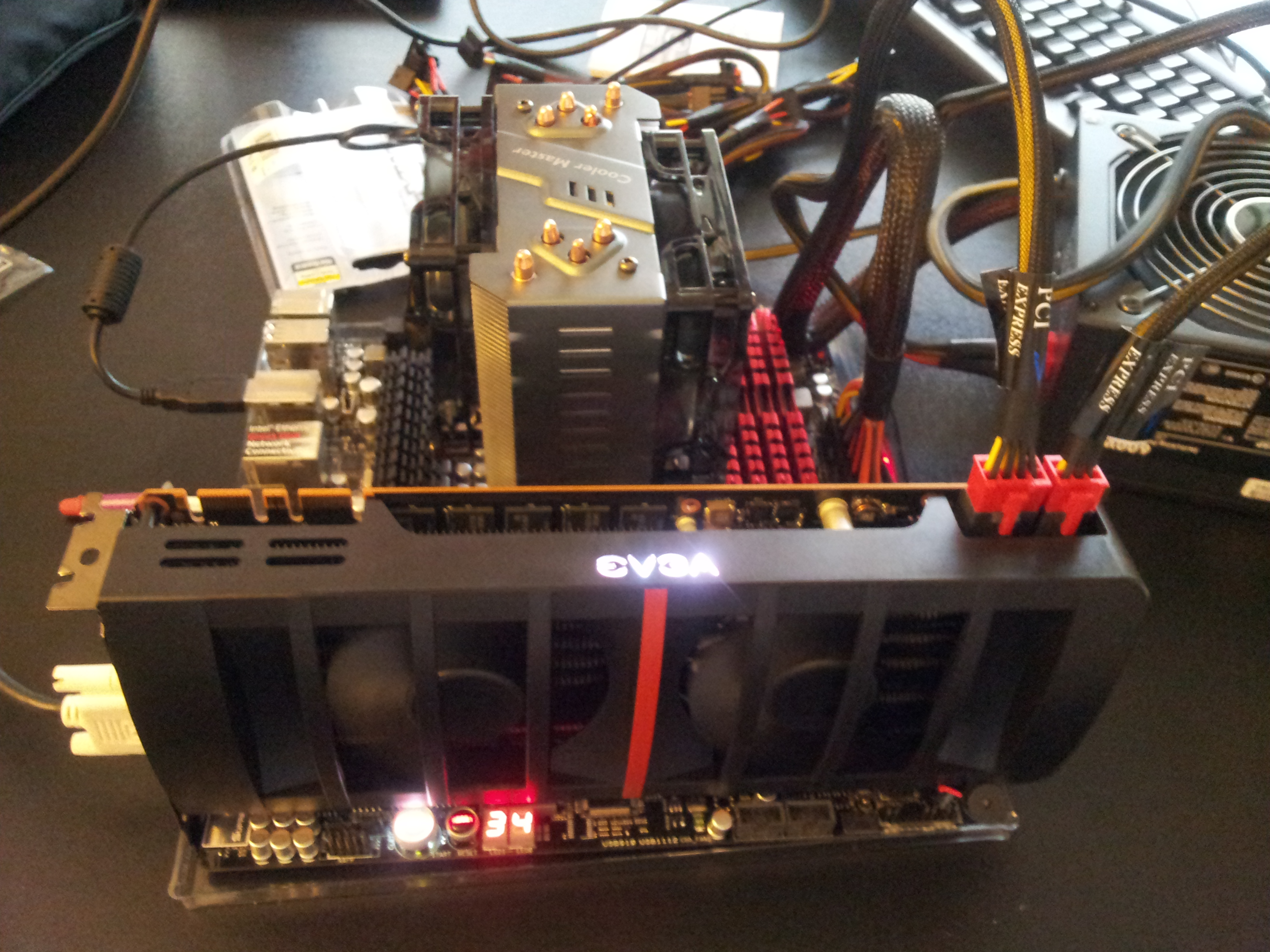

We ran into a problem with the Coolermaster cooler not fitting so we had to use the Intel CPU cooler which sucks really bad. The CPU temps hit 96C under wprime load with the CPU at 3.8 GHz :thumbdown:

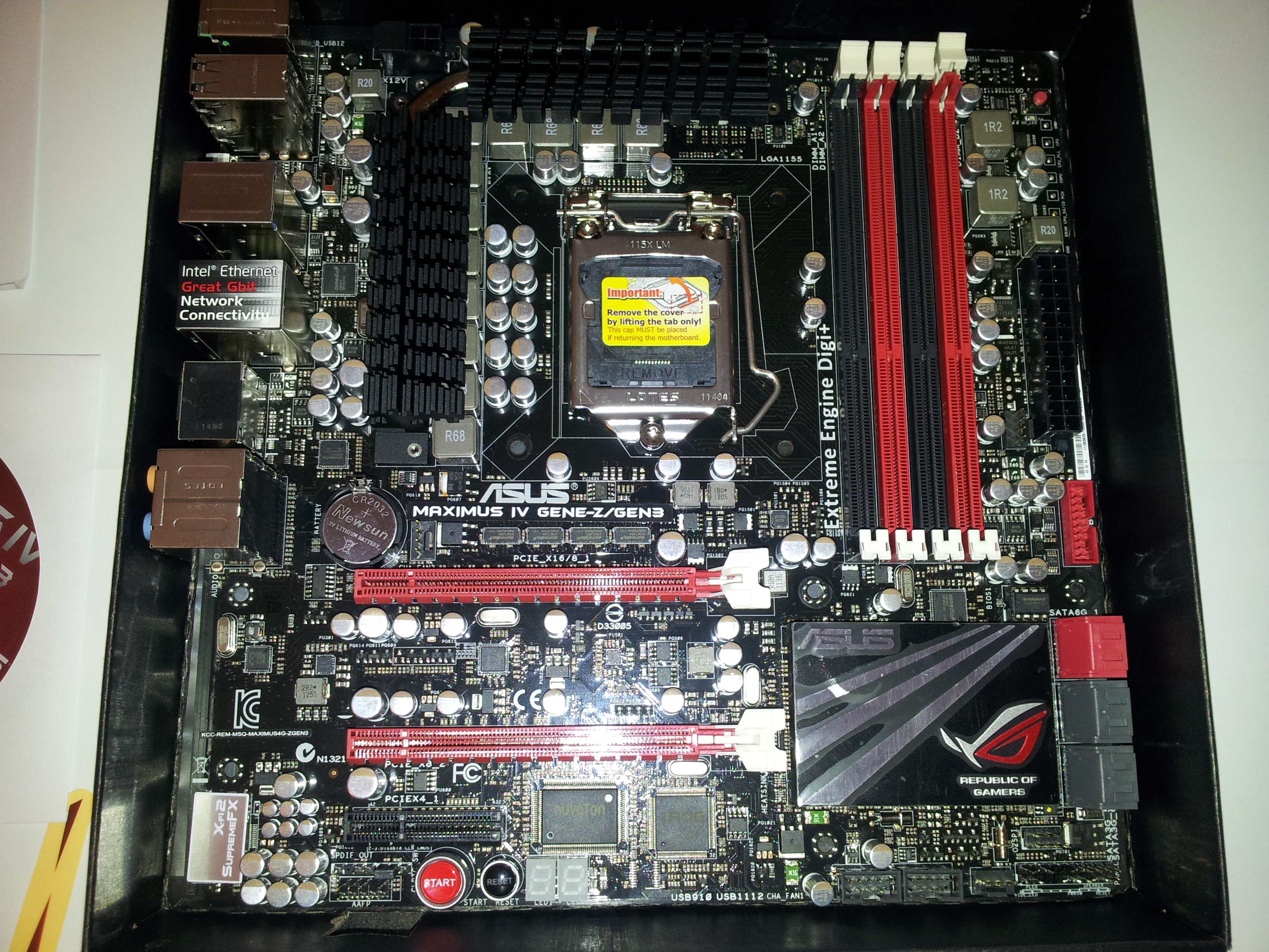

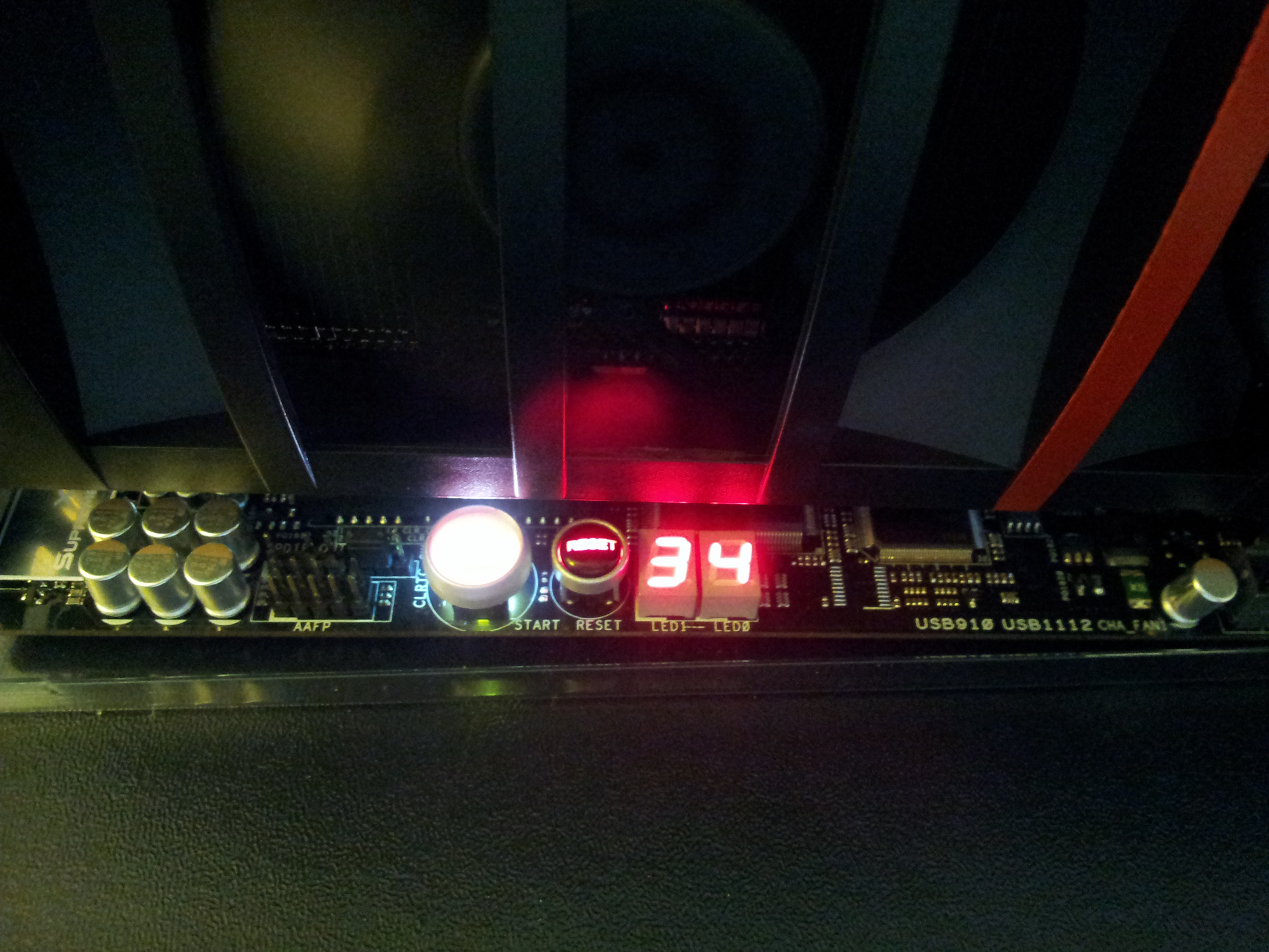

Also the Asus drivers really suck. I couldn't get his front panel audio to work.

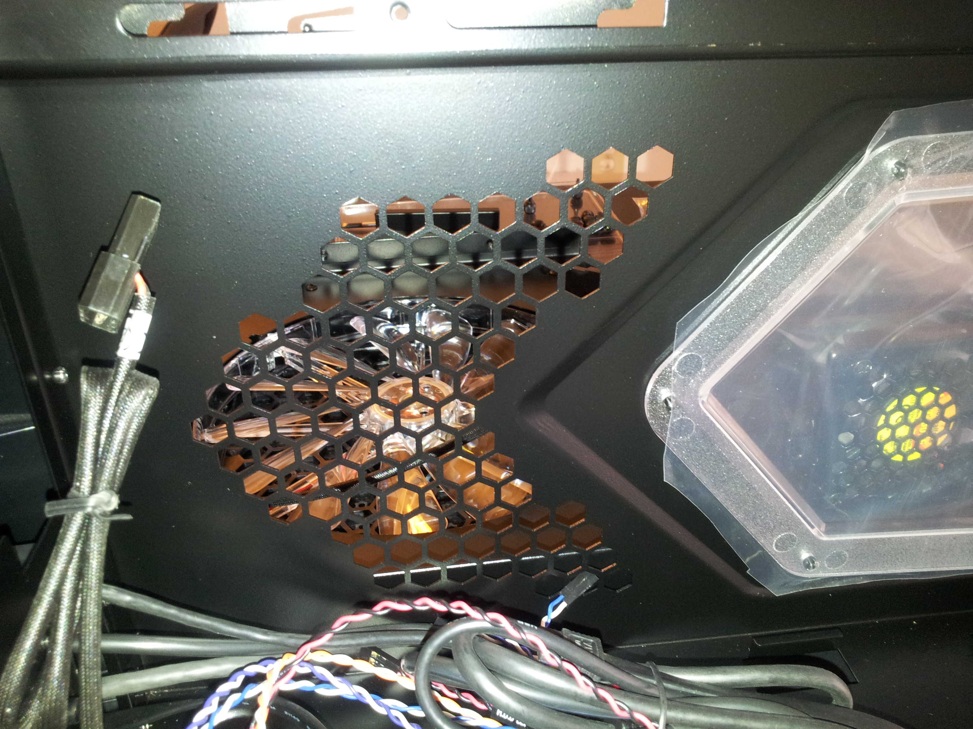

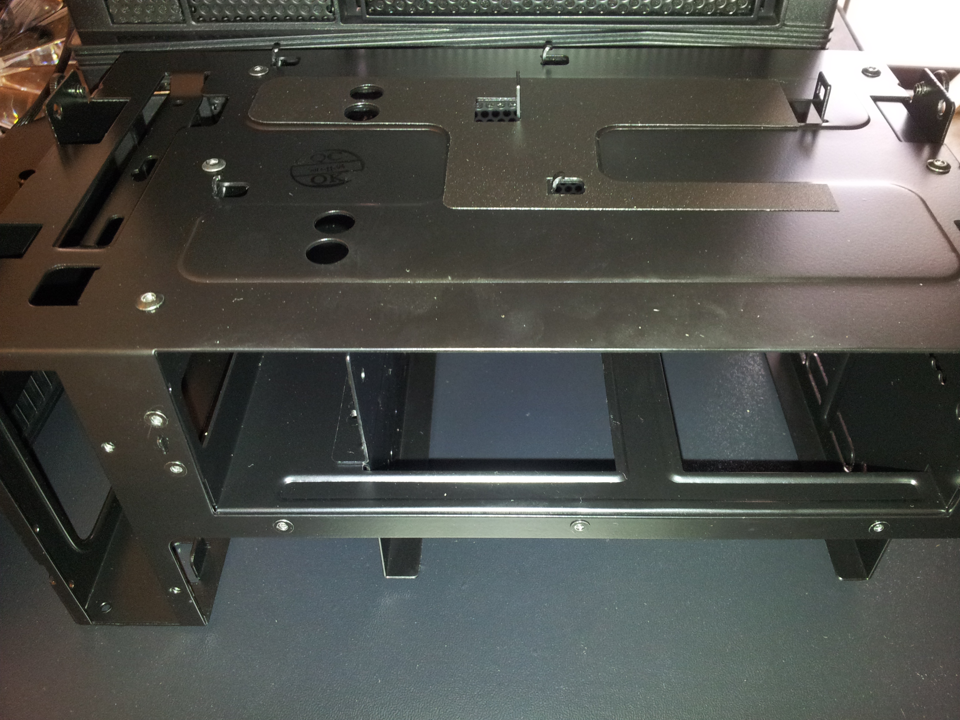

That sucks...can you modify the case so it will fit properly? A friend had a problem with the graphicscard heatpipes, they were too high, he solved it with cutting the plate, which was in the middle of the case.

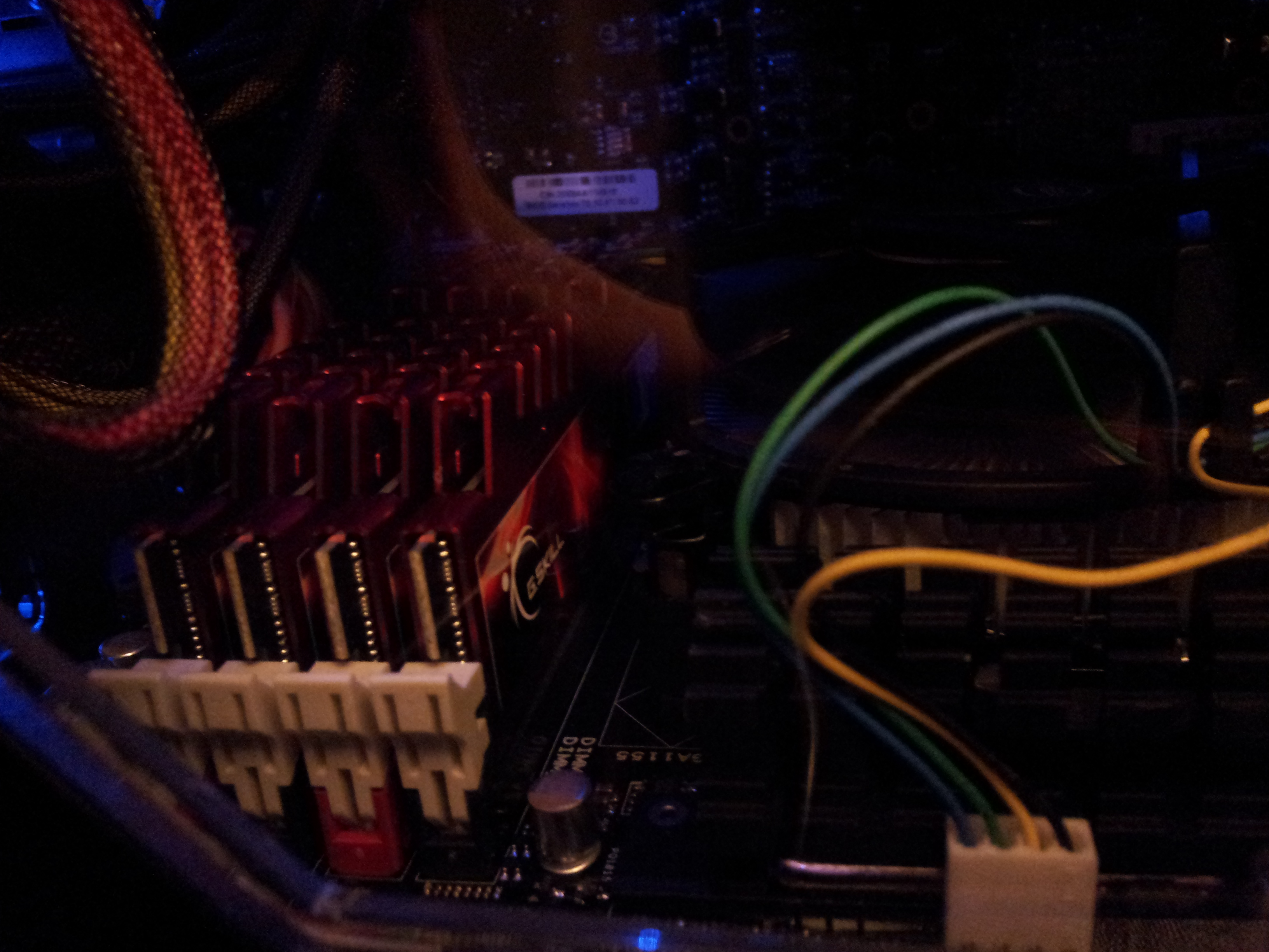

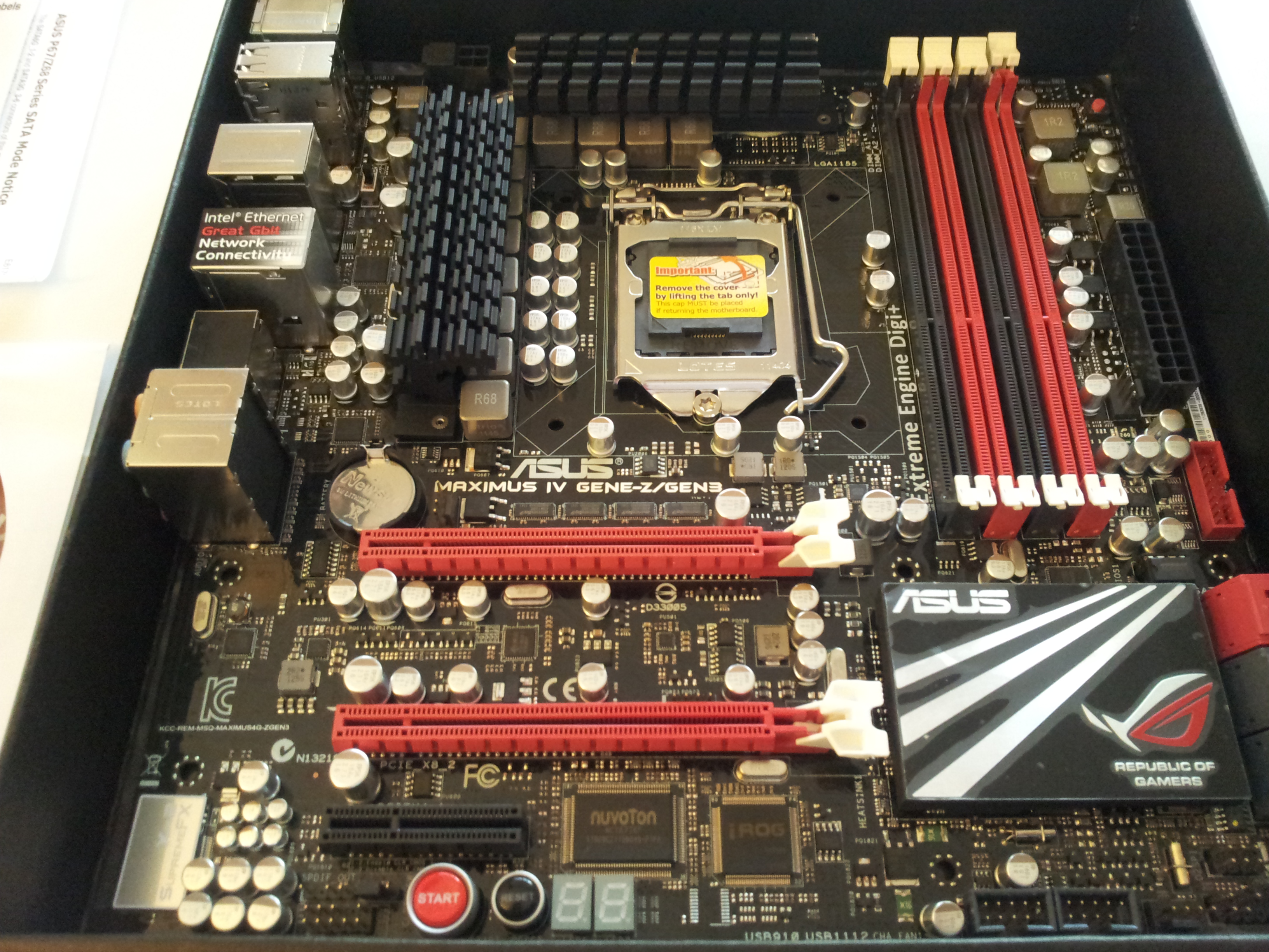

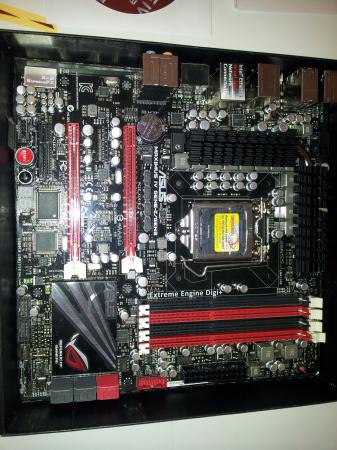

Did you use the "HD Audio" Connector or the "AC'97" Connector? Can't see it on the picture.
The connector on the motherboard seems to be connected as it should be. Did you check the connections on the frontpanel?
Did you install the RealtekDriver and the SoundBlaster X-Fi?
Asus Support site I use: ASUSTeK Computer Inc. -Support-
Directlink to newest Realtek audio driver: ASUSTeK Computer Inc. -Support- Drivers and Download Audio (watch the version, they're always messed up)
SB X-Fi driver (under Utilities): ASUSTeK Computer Inc. -Support- Drivers and Download Maximus IV GENE-Z/GEN3
LucidVirtu: lucidlogix with GPU Solution
Edited by Conker
  • Thumbs Up 3
  • Founder
Well we are going to RMA the motheboard back to NewEgg. His audio just stopped working, it gives a code 10 for the high definition audio. We've tried everything from reinstalling Windows to clearing the cmos and removing the battery. Nothing seems to fix the problem. Damn the quality control on these Asus motherboards seems to suck.

Nice build Brian - Neat, powerful and compact. Should keep him happy, and if it does start struggling in twelve months it won't be hard to find another 560 and SLI that bad boy.
