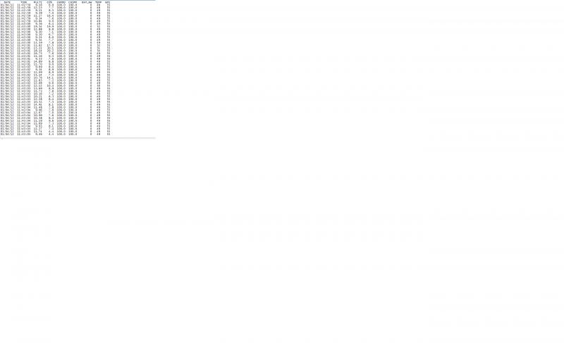

Turn on the ThrottleStop Log File option while gaming and post your log file so we can have a look. The more data the better. You can upload it to Free File Sharing Made Simple - MediaFire and then post a link here.

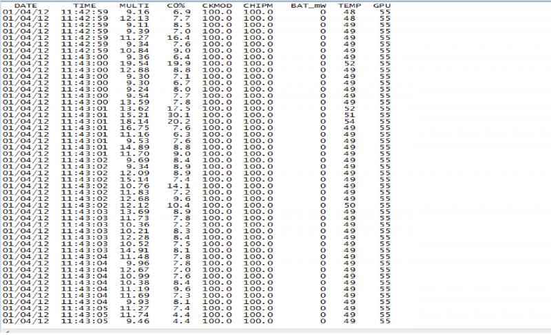

There are two different types of clock modulation throttling that can be used to slow a CPU down to a crawl. When you look in the ThrottleStopLog.txt file, you should see two columns of numbers that are always at 100.0%. Any numbers below 100.0 are a sign of a problem.
[ATTACH=CONFIG]3171[/ATTACH]
it says 100 all the time. should probably get new graphiccard^^
that shows exactly what you said but also at the same time from what it looks like this is a cross section of a throttle stop log but seemingly while you were idle. What are the ranges while playing BF3 come to think of your first post can you list how you have BF3 options configured? Bf3 can bring today's top model desktops gpu to their gnees even dual card setup or higher especially when AA and others are enabled spending on the amount of detail and resolution too... SVL7 plays BF3 on M15x perhaps he can share what settings run smooth for him. Disabling individual effects on by one and monitoring FPS can help.... AA, FXAA, Anistropic filter Shadows and more can all drop fps even faster than hi resolutions.
C0% is CPU load and while gamiing you should be seeing anywhere's from 20-100 there while gaming. Temps look fine gpu and CPU but being idle is no way to tell if your system is handling the gaming okay or not. Hyperthreading may lower heat some off but the improvement of being able to process 8 threads at once far out ways the benefits of lower heat with only 4 threads processing at once. SVL7 has shown a M15x is a beast of a portable system... Just give us a little more info and we can help get yours running how you would like.
Gpu upgrades always improve things but is absolutely a upgrade and not at all required for you to have that laptop gamie good... Your Nvidia cards should still be sufficient for BF3... Just not on Ultra and without a ton of filters on... Post processing off can help fps too. I hope I am being helpful.
Can you run the game for 10-15 min then post the log containing 10-15 min of temps,loads etc we then can tell better what's happening... Your log only has like 10 seconds in it. Throttling if it's happening will and can happen several times a second but if your only overheating on occasion it could not throttle for a few minutes till it gets warm... This is how we can hopefully see it happening... If after that there's no evidence of throttling we can look else where.... Settings, hardware etc... Comparing what fps yours is getting to like hardware and gpus can tell you too if you are running good or below what similar hardware is getting.

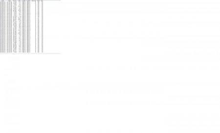

Here's my Throttlestop, just hit "Turn On," "Log File and More data" and I've been experiencing crashing/shutdowns with BF3.
sorry for the wait might of been a little since you posted your log. I went through it one my phone just now took me a little but if i was a doctor id bee saying you have a clean bill of health and a good ticker lol. From that file i divulged a max temp of 72celcius which by intel standards should be fine. I think your are on m15x what cpu and hardware? I think you are on the first gen cpus from intel so i7 940xm generation. Are you on XM or non? I divulged this other info too. No throttling from either chip modulation and none from clock modulation... plus most cpus dont throttle till about 85C not all but most. At 100% load you drop and lock down at 23X if your on first gen and default baseclock of 133mhz then you are running 3059mhz under full load with a low 72c max temp. at a time that turbo boost took advantage of low load i saw a peak of 24.51x multiplier so i guess 3259.83mhz peak during that run. What were you running during that it was a good log nothing bad happened in it though. You lock up under BF3? First under games biggest thing is be sure settings are copasetic and driver versions your on now are ones no one else has had same issues... so latest drivers. (sorry to throw a lot of suggestions just trying to cover some bases) i'd head over to the BF3 Optimization post Conkers wrote its quite good. I had recent probs on bf3 myself as in it wouldnt even launch right so it can be a lot of issues. If you think cpu is issue and that log wasnt under BF3 you could post one after running BF3 like that with Throttle Stop. You could run a bench test quick and post the log again and maybe pic of Throttlestop after (shows min and max temps for reference) also perhaps HWinfo to see GPU temps and speed while playing or for just the purpose of gpus is lightweight GPUZ which can show us in a log also what the gpu is doing also it has a graph like HWinfo too on the sensors so you can exit and see if gpus were throttling... btw Throttle Stop has a good easy access bench u can test select 8for 8threads if on i7 with hyperthreading and 4if on quadcore no hyperthreading like i5, 4 if on dual core with hyperthreading or 2 on a dual with no hyperthreading. Select the 1024m test to see if it has a prob under that sort of load. 32m isnt long enough to reveal problems. If thats what you used in the last log then disregard and we need something heavier.
