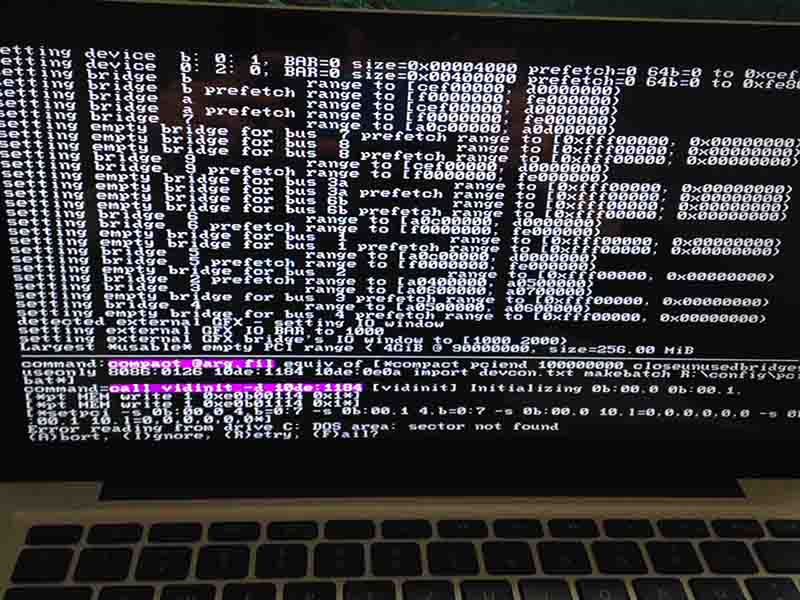

Hello. I have a problem get my Bplus TH05 running at an MBPr 2011 13". When I do PCI compaction it shows an error after intializing the gtx770 at the end of the progress. It says "Error reading from drive C: DOS area: sector not found". I can chose abort, ignore, retry and fail. I tried everything, but nothing works.
Someone any idea whats going wrong or how to fix?
Edit: I just switched to Windows 10 and it worked out of the box. No Setup 1.3 or any scripts and no Errors in Device Manager.
See the Benchmarks on the internal screen. I ll buy a external one in a couple days and hope (know) have better results.
