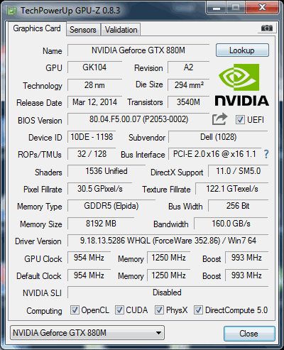

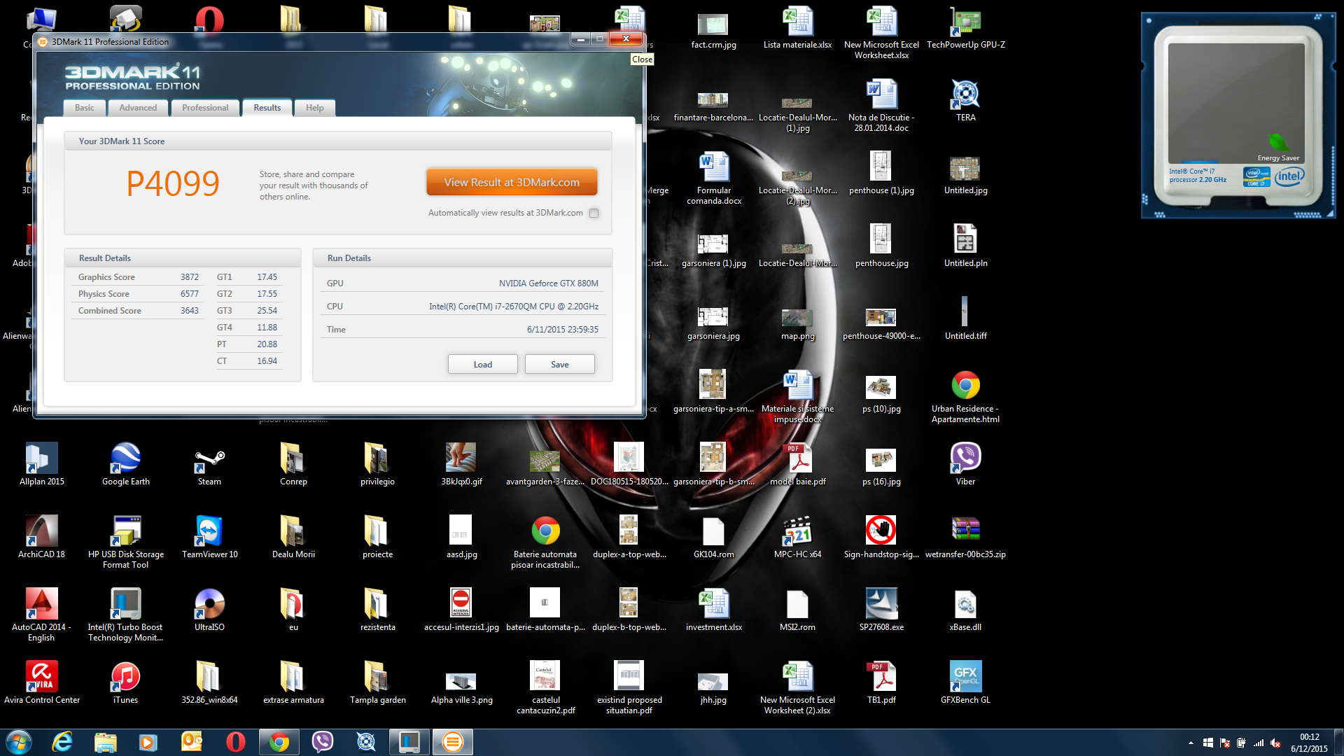

can someone help me with my new gtx 880m throtheling ?.... i have just get it and it is working really slow. put in in alienware m17x r3
Install any driver previous to v347.xx. Options are v344.80 , v344.75 , v344.65 from here http://forum.techinferno.com/nvidia/6307-%5Balienware%5D-aftermarket-upgrades-driver-support-modded-inf-11.html#post116879
