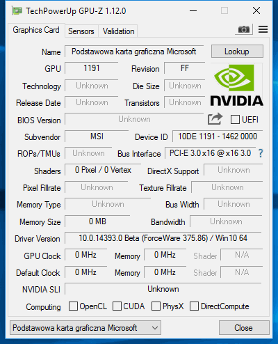

vivix Posted December 5, 2016 Share Posted December 5, 2016 Spoiler NVIDIA Firmware Update Utility (Version 5.142) Adapter: GK1xx (10DE,1191,1462,0000) H:--:NRM B:01,PCI,D:00,F:00 The display may go *BLANK* on and off for up to 10 seconds during access to the EEPROM depending on your display adapter and output device. Identifying EEPROM... EEPROM ID (C2,2012) : MX MX25L2005 2.7-3.6V 2048Kx1S, page Reading adapter firmware image... ERROR: Location Size Type PCI Block corrupted c:\flash>nvflash --list NVIDIA Firmware Update Utility (Version 5.142) NVIDIA display adapters present in system: <0> GK1xx (10DE,1191,1462,0000) H:--:NRM B:01,PCI,D:00,F:00 c:\flash>nvflash --pciblocks NVIDIA Firmware Update Utility (Version 5.142) Adapter: GK1xx (10DE,1191,1462,0000) H:--:NRM B:01,PCI,D:00,F:00 The display may go *BLANK* on and off for up to 10 seconds during access to the EEPROM depending on your display adapter and output device. Identifying EEPROM... EEPROM ID (C2,2012) : MX MX25L2005 2.7-3.6V 2048Kx1S, page Reading adapter firmware image... ERROR: Location Size Type PCI Block corrupted c:\flash>nvflash -i0 -4 -5 -6 OC.rom NVIDIA Firmware Update Utility (Version 5.142) Checking for matches between display adapter(s) and image(s)... Adapter: GK1xx (10DE,1191,1462,0000) H:--:NRM B:01,PCI,D:00,F:00 NOTE: EEPROM does not contain board ID, skipping board ID check. WARNING: None of the firmware image compatible PCI Device ID's match the PCI Device ID of the adapter. Adapter PCI Device ID: 1191 Firmware image PCI Device ID: 11A1 WARNING: Firmware image PCI Subsystem ID (1462.10D9) does not match adapter PCI Subsystem ID (1462.0000). PCI Device ID override detected. (This is usually only needed for very special circumstances.) Are you sure you want to continue? Type "YES" to confirm (all caps): YES Overriding GPU mismatch Please press 'y' to confirm override of PCI Subsystem ID's: y Overriding PCI subsystem ID mismatch Current - Version:Unavailable (Invalid) ID:0000:0000:0000:0000 Replace with - Version:80.04.58.00.0D ID:10DE:11A1:1462:10D9 GK104 Board - 2051b003 (Normal Board) Update display adapter firmware? Press 'y' to confirm (any other key to abort): y The display may go *BLANK* on and off for up to 10 seconds or more during the update process depending on your display adapter and output device. Identifying EEPROM... EEPROM ID (C2,2012) : MX MX25L2005 2.7-3.6V 2048Kx1S, page WARNING: Adapter does not have a preservation table, unable to preserve board settings. Clearing original firmware image... . Storing updated firmware image... EEPROM programming failed. ERROR: Mismatch in 256 byte page-mode programming This is what NVflash gives me. I think i tried all vBioses for GTX670MX i found to get it recovered. No success. Can anyone provide me vBios for this GPU ? I made backup of vBios before i flash with TPU GPU-Z 1.12.0 When i try flash with Bypassed version of NVflash 265 : Spoiler NVIDIA Firmware Update Utility (Version 5.265.0) Modified Version by Joe Dirt NVIDIA display adapters present in system: <0> GeForce GTX 760 (10DE,1191,1462,0000) H:--:NRM S:00,B:01,PCI,D:00,F:00 I dont have GeForce GTX 760 but GTX670MX on board. I dont know what i can do next to recover it... Usually i use command : NVFLASH -i0 -4 -5 -6 Backup.rom backup.rar Quote Link to comment Share on other sites More sharing options...

vivix Posted December 6, 2016 Author Share Posted December 6, 2016 (edited) I managed to flash backup, i used command NVFLASH -w to secure EEPROM but after restart its the same. I can flash when gpu is cold..... WTH is going on :/ After flash of backup it says that device connected is <0> GK1XX but it should say that GTX670MX is connected isnt it ? Anyone can provide me correct file to flash ? Its 16F3 motherboard. Edited December 6, 2016 by vivix Quote Link to comment Share on other sites More sharing options...
