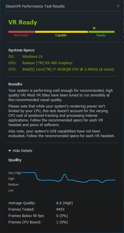

Psyrecx Posted August 9, 2016 Author Share Posted August 9, 2016 My Benchmark:9125http://www.3dmark.com/3dm/13975885 1 Quote Link to comment Share on other sites More sharing options...

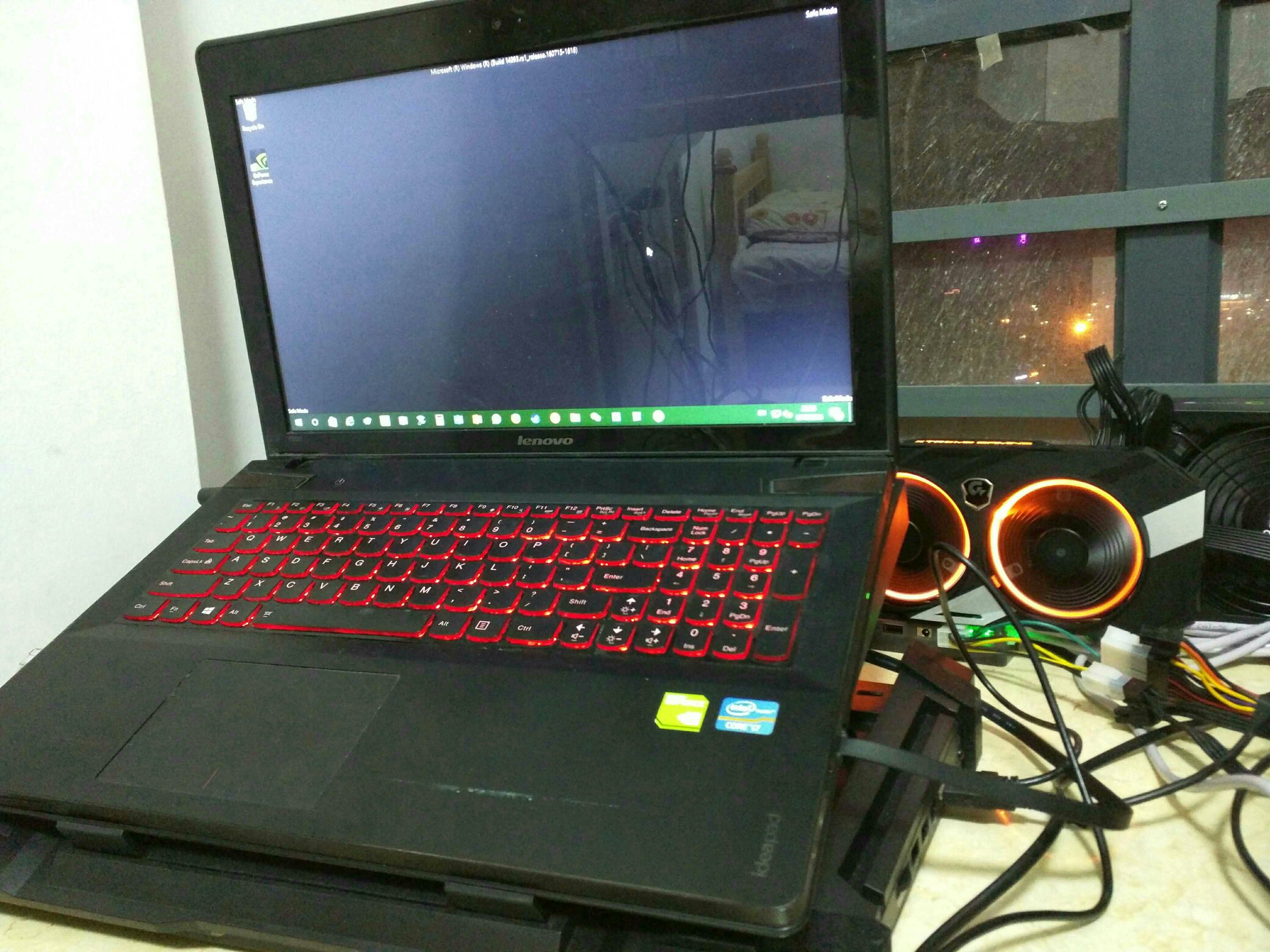

dRoLdDy Posted August 16, 2016 Share Posted August 16, 2016 Just hooked it up. All I had to do to get it to run was disable the main 750m card (I have sli) and install the radeon drivers. How did you disable the main 750m card. I have the same problem. I can't get my eGPU to run properly. Every time I connect it, the laptop boots into black screen and the eGPU fans stop spinning. What should I do? Please help. Quote Link to comment Share on other sites More sharing options...
Psyrecx Posted August 16, 2016 Author Share Posted August 16, 2016 (edited) I just disabled it through Windows device manager. Both cards start up when booting into Windows, but the 750m disables once the login screen comes up. Though, the 750m will re-enable it's self at some times and just needs disabled again. Keep in mind, I am only using mine via Screen 2 on the external monitor output. If I was mirroring or extending the screen, both screens would show up and wold be still running off the RX 480. Here's how it should boot up with a similar setup to mine:https://youtu.be/nzwTIR5Pd0I Edited August 16, 2016 by Psyrecx 1 Quote Link to comment Share on other sites More sharing options...

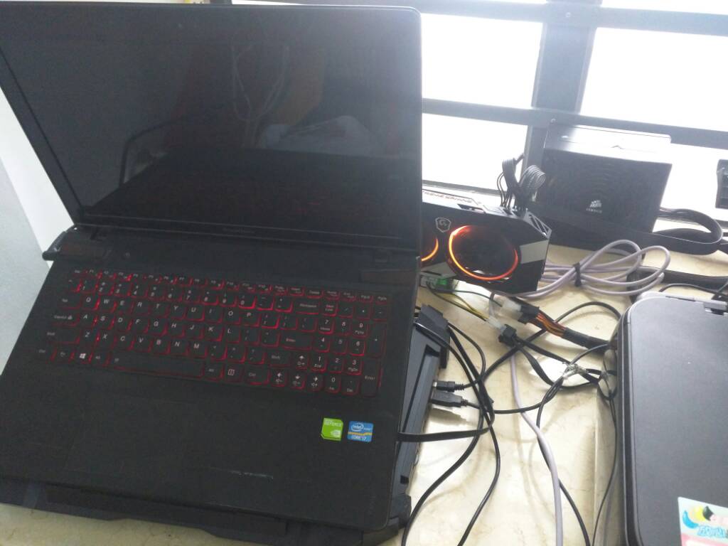

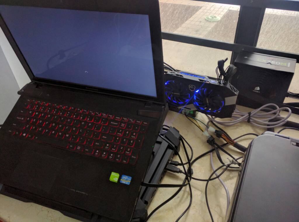

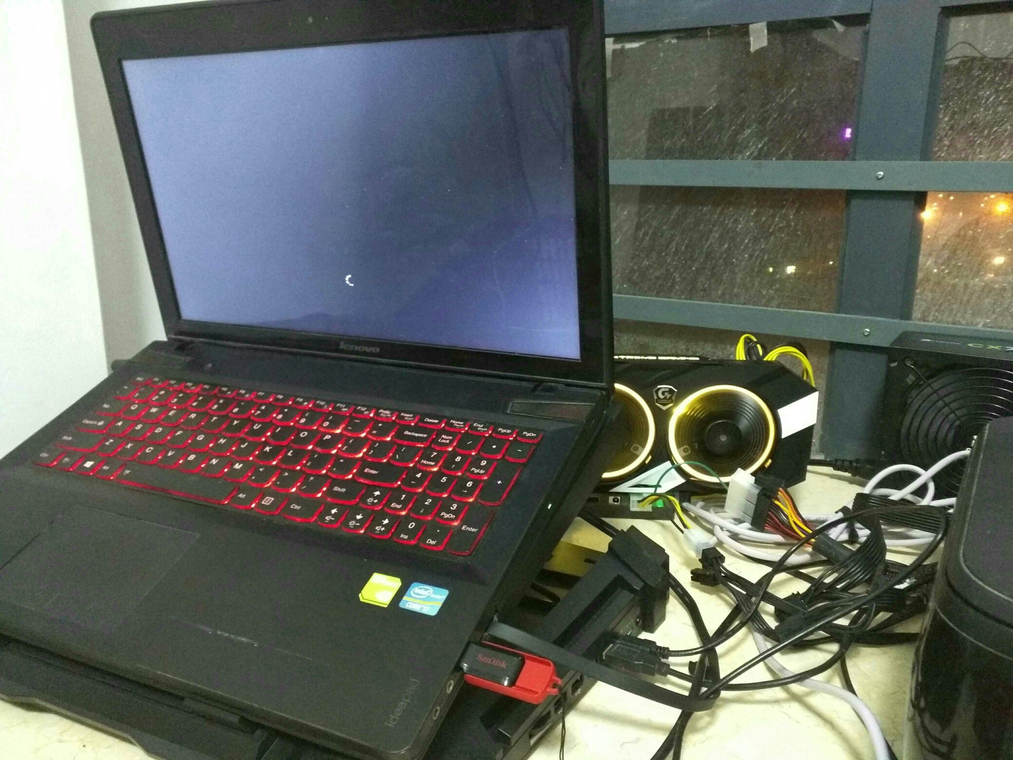

dRoLdDy Posted August 17, 2016 Share Posted August 17, 2016 This is my setup below: The problem is that the fans on the external GPU stop rotating after windows boots and it's stuck in boot screen. I'm using GTX 960. ALSO, the external screen is simply blank. Sent from my Nexus 6 using Tapatalk Quote Link to comment Share on other sites More sharing options...

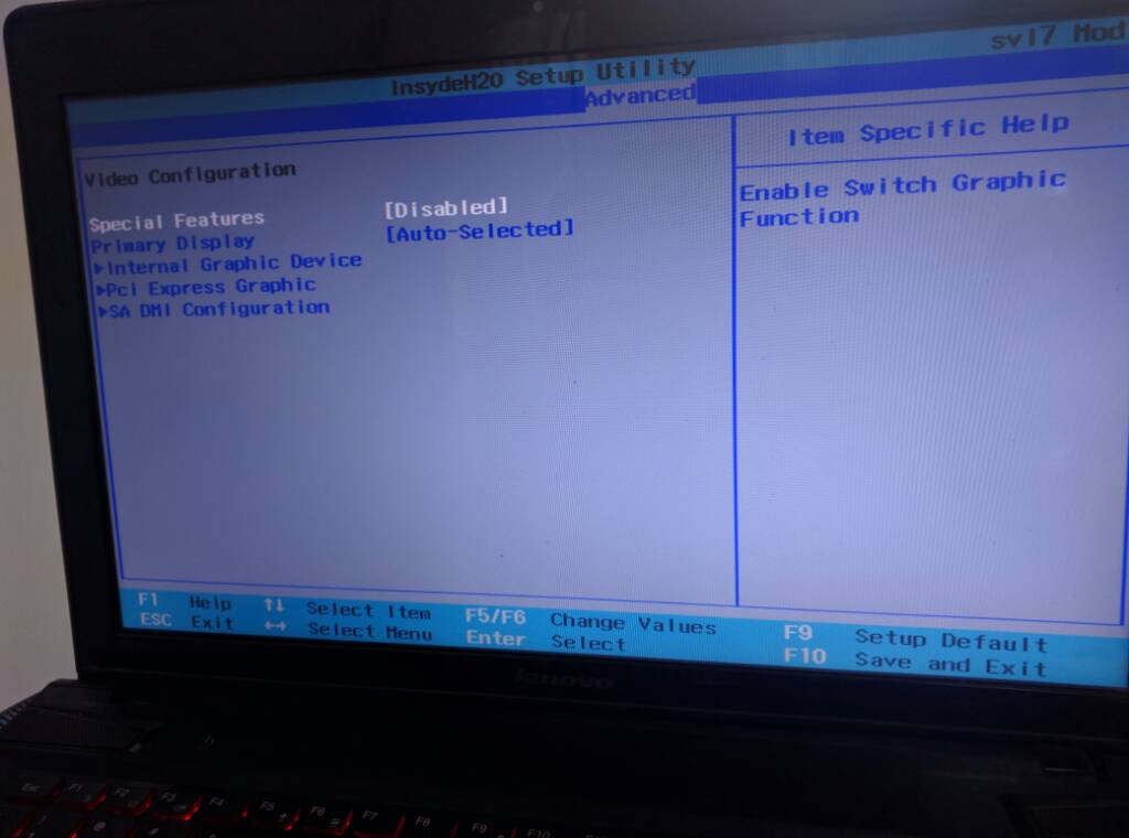

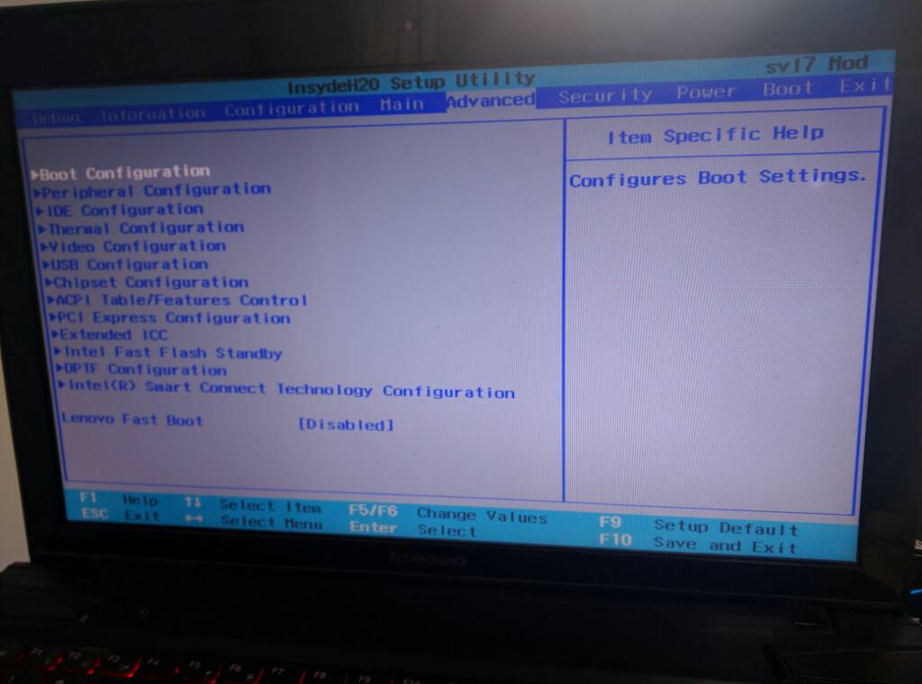

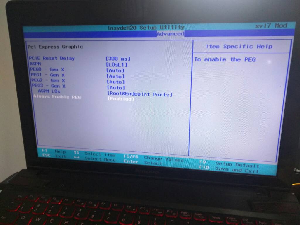

dRoLdDy Posted August 17, 2016 Share Posted August 17, 2016 This is my BIOS setup, maybe I did something wrong. Second scenario is when completely black screen but the fans are spinning and no external screen output. This is frustrating Sent from my Nexus 6 using Tapatalk Quote Link to comment Share on other sites More sharing options...
Psyrecx Posted August 17, 2016 Author Share Posted August 17, 2016 1 Quote Link to comment Share on other sites More sharing options...
dRoLdDy Posted August 17, 2016 Share Posted August 17, 2016 Thank you. I'll try and see if it works Sent from my Nexus 6 using Tapatalk Quote Link to comment Share on other sites More sharing options...
dRoLdDy Posted August 17, 2016 Share Posted August 17, 2016 I tried using the settings you provided but the computer didn't want to boot. It was stuck in a bootloop. Here's the thing: the computer boots into safe more and the eGPU is recognized in the device manager but the computer doesn't want to load in normal boot. And suggestions? Thanks Sent from my Nexus 6 using Tapatalk The computer is in safe mode. This is okay but I can't really use it in this mode. Please help Sent from my Nexus 6 using Tapatalk Quote Link to comment Share on other sites More sharing options...

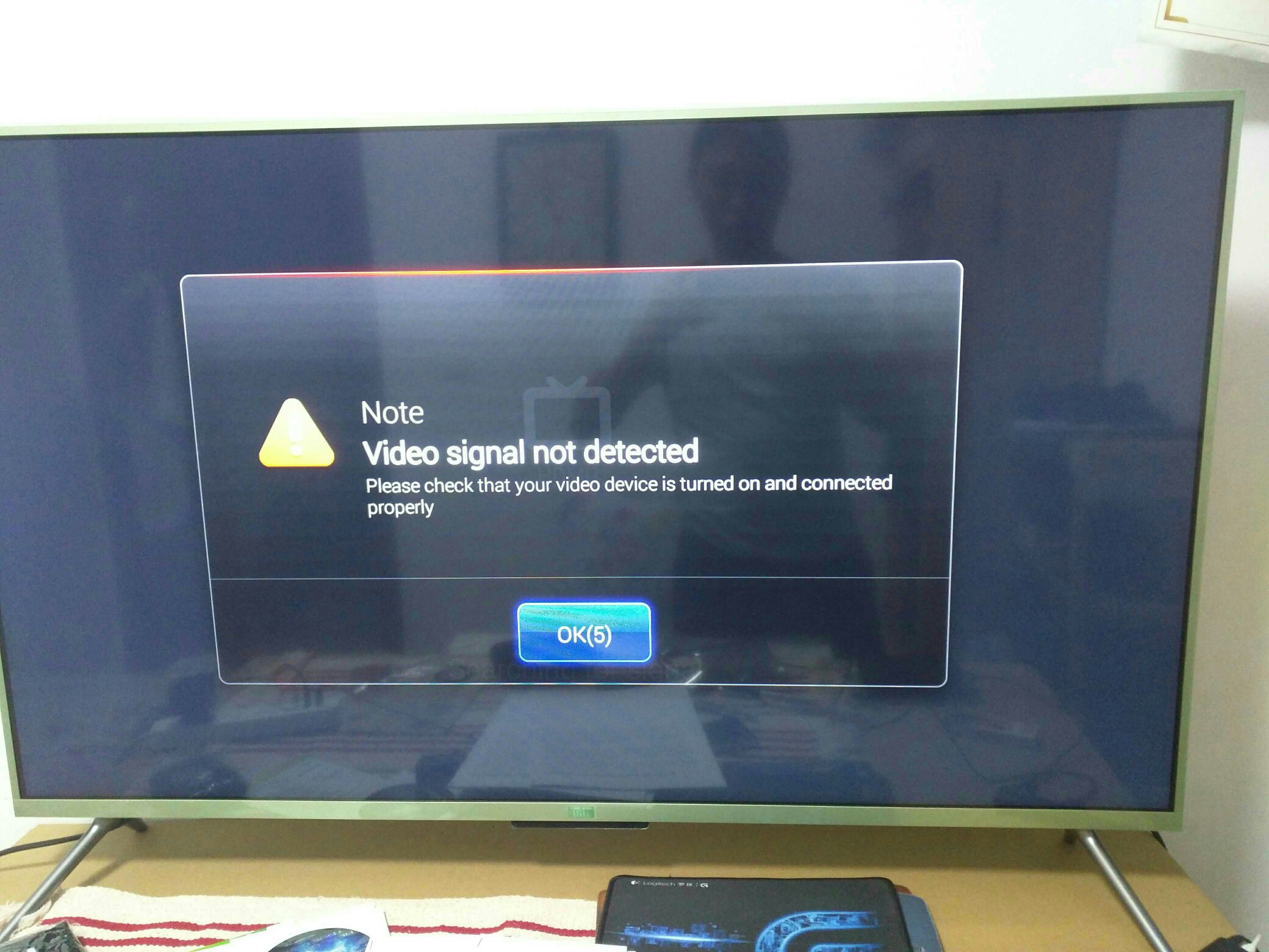

cuethenoise Posted August 17, 2016 Share Posted August 17, 2016 3 hours ago, dRoLdDy said: Well I had to restore my system to the last point of successful boot. I will try the whole process again but Y500 was cleanly not made to run an external GPU with ease unlike y580 which has no problems Sent from my Nexus 6 using Tapatalk Of course I did. Sent from my Nexus 6 using Tapatalk Your plugging a monitor into the external GPU? The fans on most Nvidia GPUs will turn off at idle. I wouldn't be surprised if it was outputting video only out of the GPU. Quote Link to comment Share on other sites More sharing options...
dRoLdDy Posted August 17, 2016 Share Posted August 17, 2016 This is my problem every time. I reinstalled everything from scratch... Same problem persists Sent from my Nexus 6 using Tapatalk I'm stuck in boot logo now. This is a disaster. What am I doing wrong? Sent from my Nexus 6 using Tapatalk No video signal from the eGPU Sent from my Nexus 6 using Tapatalk Quote Link to comment Share on other sites More sharing options...
