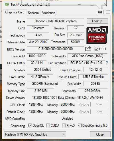

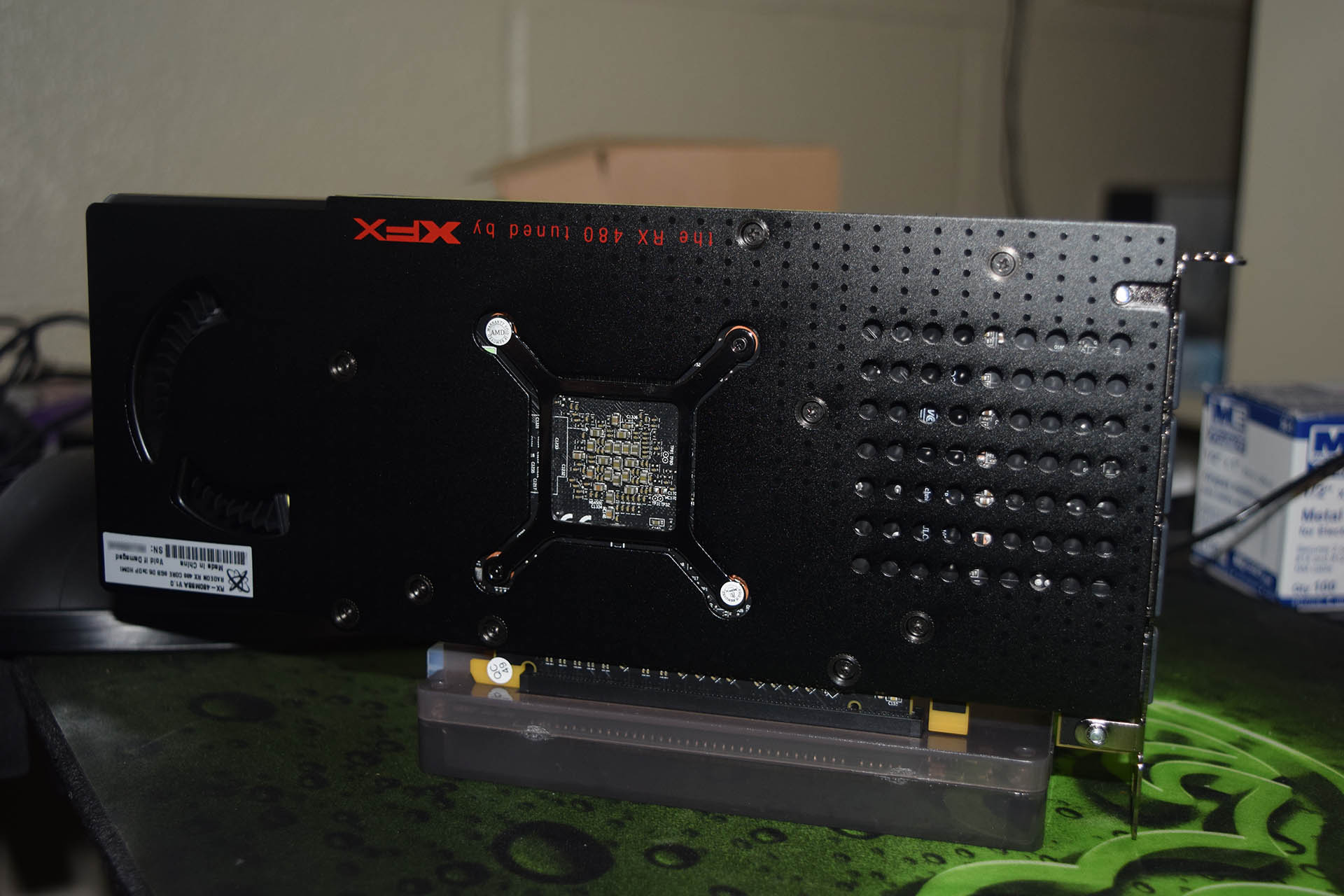

Psyrecx Posted July 4, 2016 Share Posted July 4, 2016 (edited) Ok, so I've been running the modded BIOS to remove the whitelisting for a while, because I was using a Intel 7260. Now I'm using a USB high power wireless adapter, but I've kept the modded bios anyways. I was originally looking at getting a ultrabay GT750m and having the GT 750m SLI setup, but after going over the pros and cons of it vs an eGPU setup, I've ended up here. I've completely modded my system to accept the adapter and everything, just awaiting the arrival of my RX 480. Though... that would require them to be in stock. :/ Anyway's here's how everything is going. Current SetupNotebook: CPU: Intel Core i7-3630QM GPUs: Nvidia GT750m | EXP GDC Beast v8.3E - w/ XFX Radeon RX 480 XXX - 8GB Memory: 8GB DDR3 12800 HDD: 120 GB Muskin Atlas Deluxe | 1TB Samsung 5400RPM Network: Alpha Network Inc. AWUS036ACH High Power Wireless-AC1200 USB 3.0 Adapter Display: Lenovo 1920x1080 External Displays: Samsung 32in FHD Smart TV @ 1080p | Sceptre X22WG-1080P Edited March 27, 2017 by Psyrecx 1 Quote Link to comment Share on other sites More sharing options...

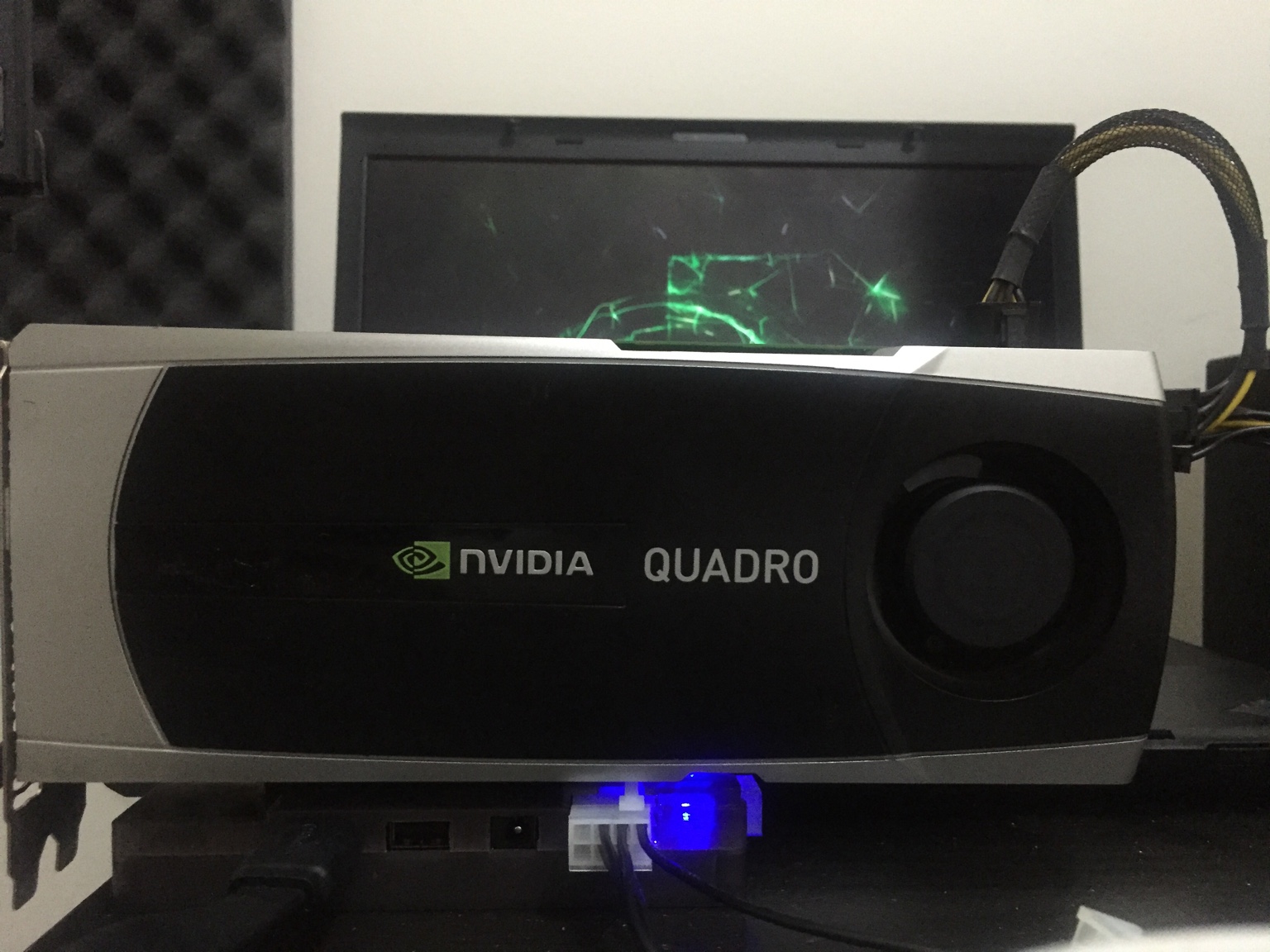

ssamydla Posted July 11, 2016 Share Posted July 11, 2016 Now all I need is the 6pin cables that EXP GDC did not include for some reason or another. Did you use DELL 220W or ATX PSU? Don't ever tried to power up if the card needs more power and you dont have the 6pin cable I end up bricked my Quadro 6000 AND Quadro 4000 without 6pin & 6+2pin. As the cable still enroute somewhere in china. I purchased Beast V8 with Dell 220W only, but then i buy 500W PSU but it was too late It doesn't comes with DELL 220W anymore, so the 6pin cable is useless. People tend to use high-end GPU with it's product, so it is safer for them if we buy our own ATX PSU for more reliable performance Quote Link to comment Share on other sites More sharing options...

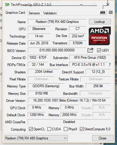

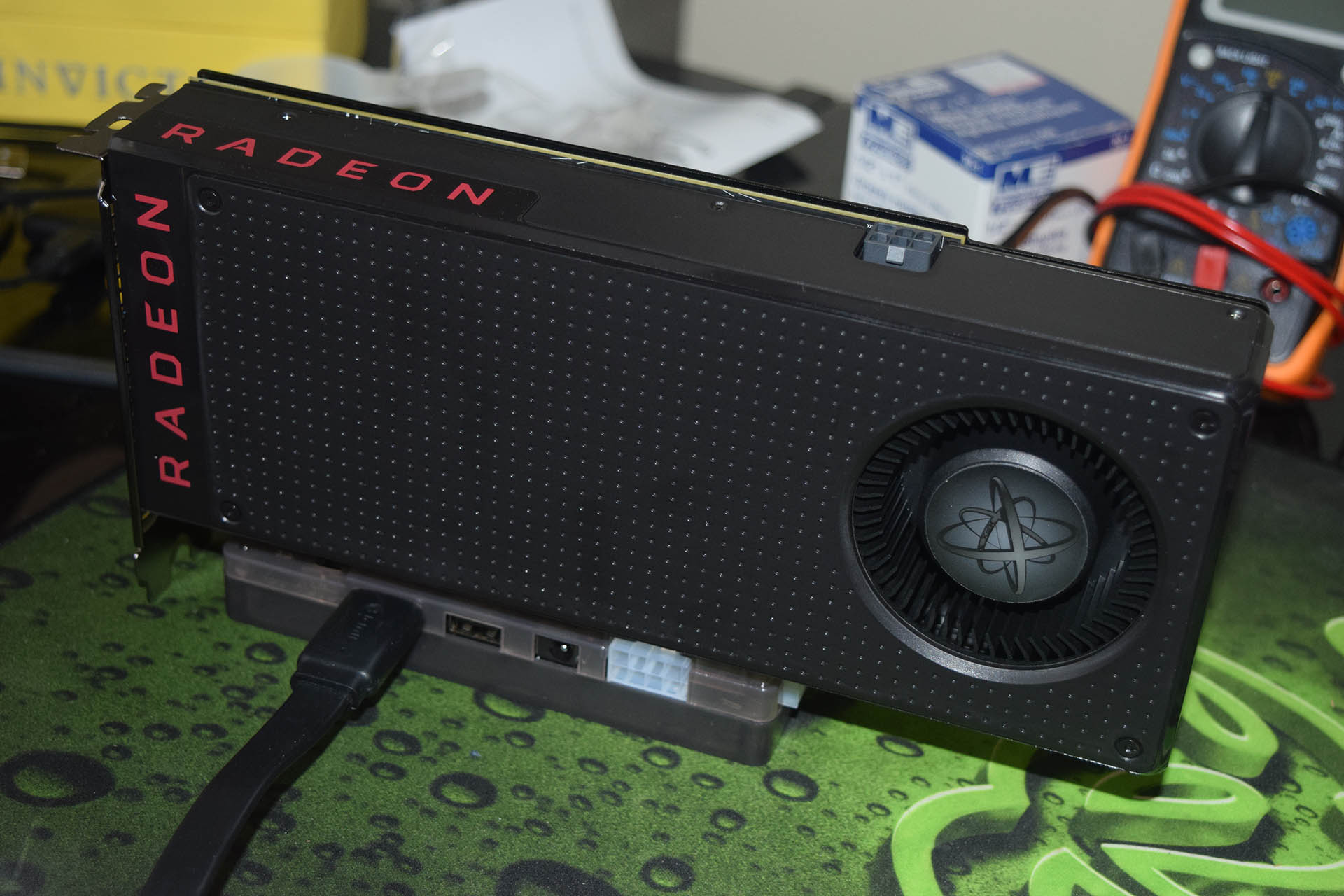

Psyrecx Posted July 21, 2016 Author Share Posted July 21, 2016 (edited) Well, I got the cord, and managed to get the card to show up in Windows. Problem is, it seems no matter what I do, it won't let me completely disable the GT750m. The BIOS settings keep re-enabling the card even though I keep trying to disable it. It goes back to default video settings every time. It won't let me select any of the other GPU locations such as PEG, PCI, or any of the others. Even disabling the "internal video device" in the BIOS has no affect. Disabling it in Windows, still makes it use the GT750m only. Also, it won't let me launch the AMD Radeon Settings. It says "Radeon Settings are currently not available. Please try again after connecting AMD graphics." Edited July 21, 2016 by Psyrecx 1 Quote Link to comment Share on other sites More sharing options...
Psyrecx Posted July 21, 2016 Author Share Posted July 21, 2016 (edited) So, I ended up having to hook my TV up to my laptop to get it to run. Interesting that the internal monitor works so long as there's a monitor attached to the card. Makes me wonder if there is a way to trick the card into thinking there is a monitor attached so it will use the internal display. I'm thinking an HDMI dummy plug may do the trick. Edited July 21, 2016 by Psyrecx Quote Link to comment Share on other sites More sharing options...
